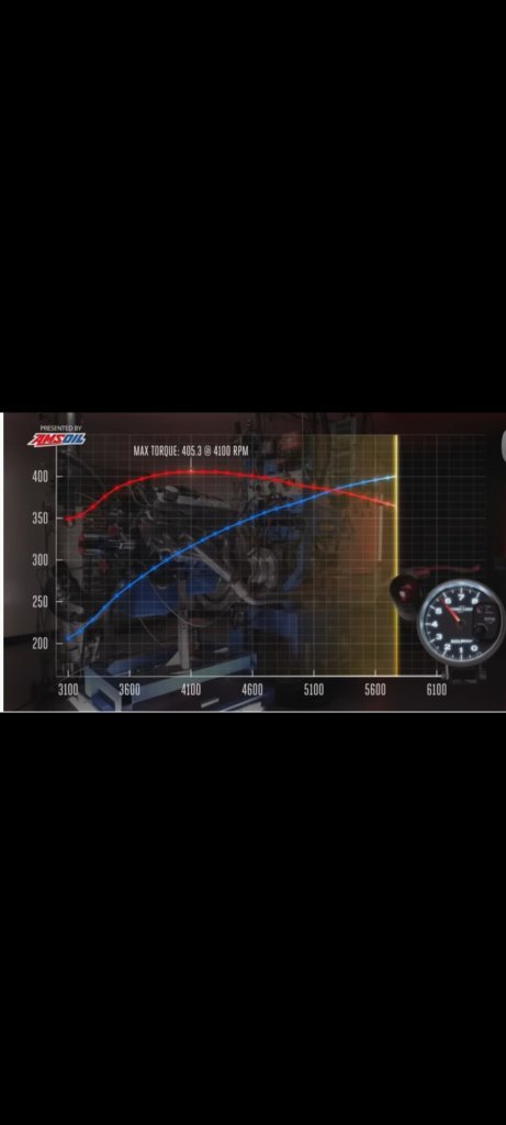

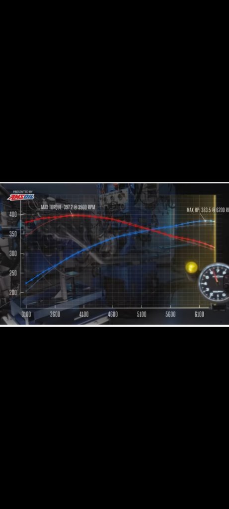

I'd rather see a real world test below 3500 rpm long tubes with 2.5" duals vs. mid length headers with 3" duals at rpms below 3500, the speeds most of these will be driven at the majority of the time. You can also make more power with a bigger cam,and a single plane, but not more power where it's needed on a driver type car. Lots of people on this forumn complain if their engine turns more than 2500 rpm for real world driving. Edit. Looks like they picked up 20hp and 30 ft lbs at 3100 rpm,more power, at a more commonly used rpm. Gave up 8 ftlbs at a peak rpm,that will rarely be used. Using a single 3" with a good muffler vs 2.5" duals.And long tubes would have brought the bottom up even more.

I'd rather see a real world test below 3500 rpm long tubes with 2 5 duals vs. mid length headers with 3" duals at rpms below 3500, the speeds most of these will be driven at the majority of the time. You can also make more power with a bigger cam,and a single plain but not more power where it's needed.
The issue I see is anything stock under 3000 isn't really grunting against the absorber and probably won't show anything that might be considered outside of margin of error as far as a dyno is concerned.
