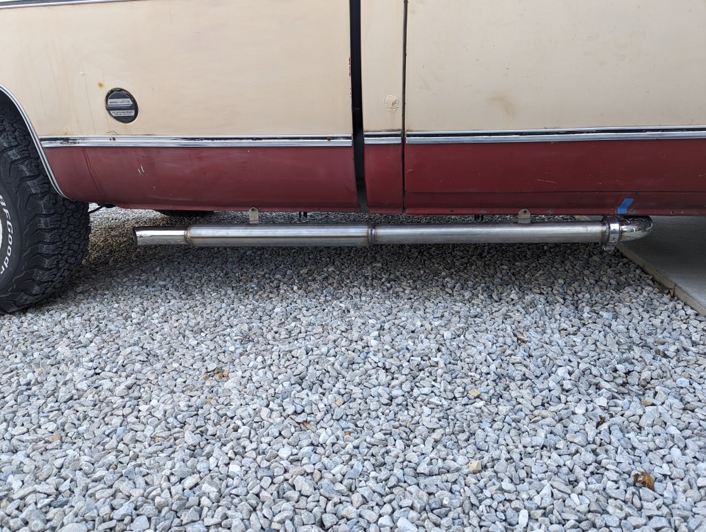

3” all the way is kind of pointless imo at 350hp, a single 2.5” or dual 2.25” would be just fine.
JMO, but I’d go with long tubes, unless if strictly required for fitment reasons, I have a hard time seeing the need for short or mid length headers. As I said, just my opinion.
I made these sidepipes for my 76, 2.5” tubing and resonators as mufflers, it’s not quiet per se, but is totally bearable noise wise ripping down the interstate and does not drone.
pxl_20240528_004048913-jpg.352327
you need something like these.
