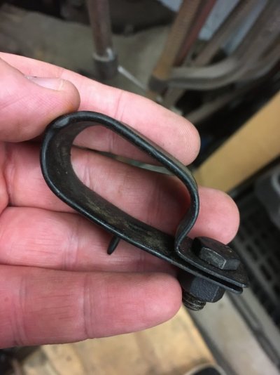

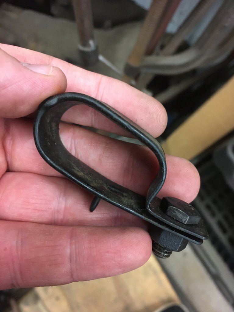

I thought I had all of the pieces but I’m missing one. This is the loop that actually holds the hoses so they don’t rub the crossmember, it has a light rubber coating on it. There’s a small 90* bracket that this bolts to but I don’t have it.
Great info, thanks! I found that clip and I think I found the angle bracket. Do you possibly remember if the cooler bolted directly to the underside of the radiator support top panel? The brackets are to short to go from the top panel to the bottom of the radiator support. But I know I took this cooler off my 76. I think I may be missing something
