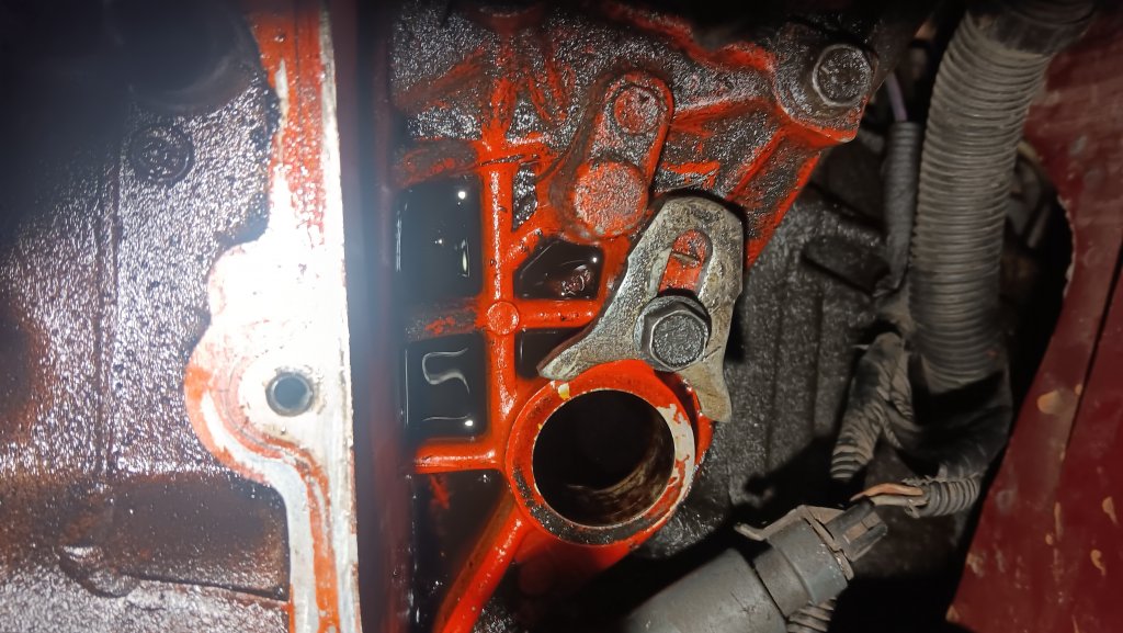

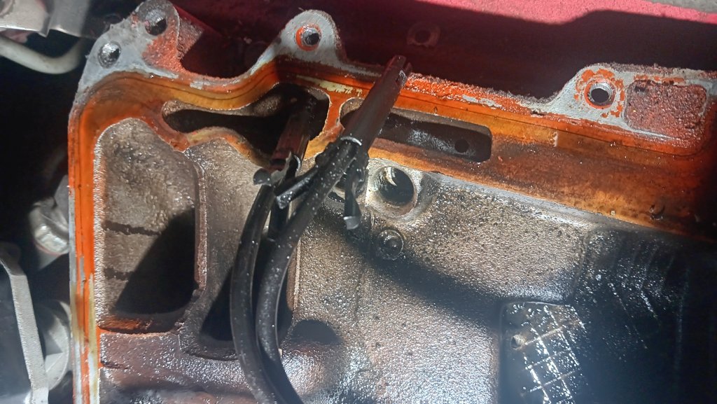

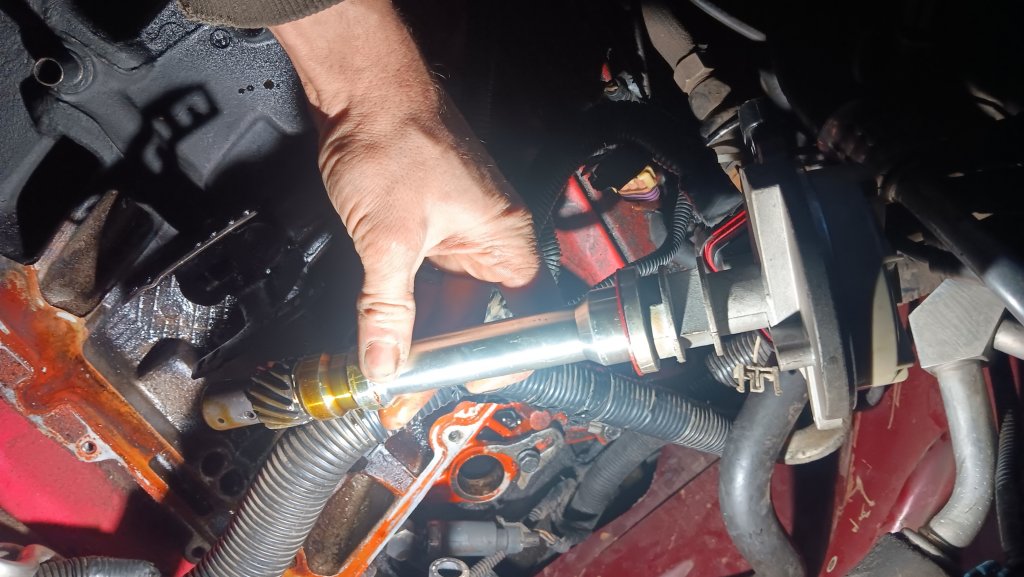

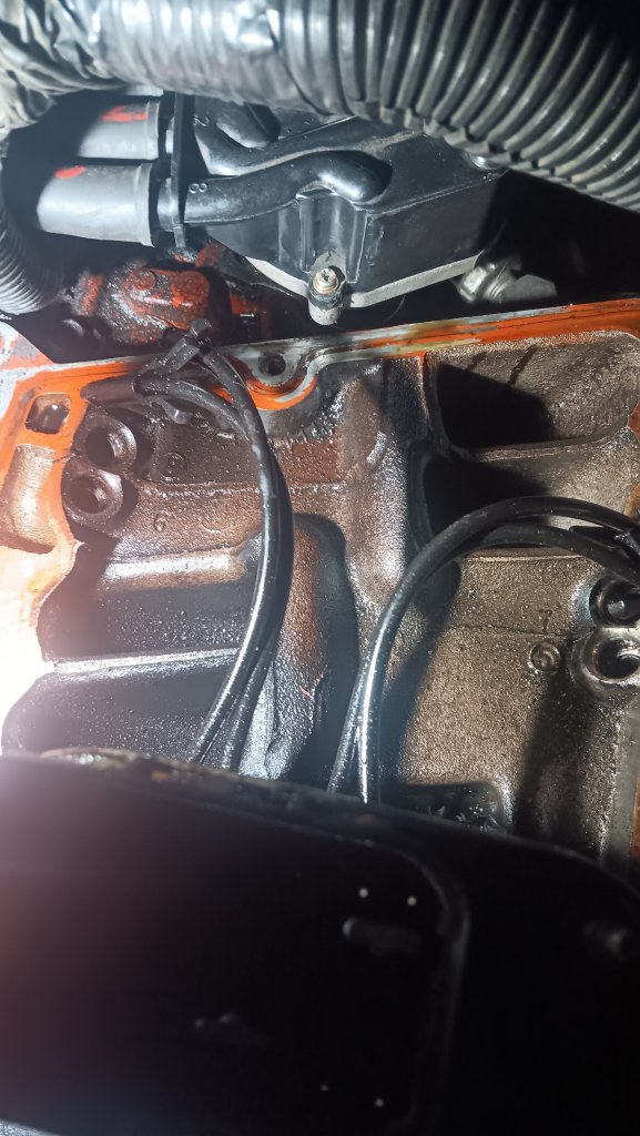

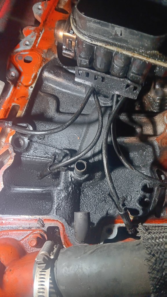

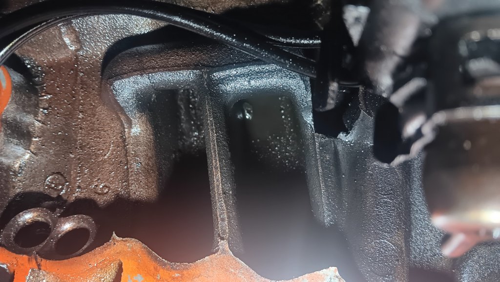

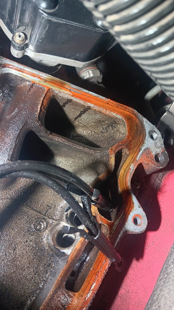

I have a 99 suburban 350 vortec. It's our main driver and pretty much only thing my wife drives. It's been down since yesterday morning and I'm thinking its the lower intake leaking because there is a fair amount of oil under upper intake with the spider unit. I'll get pics. So to back up to last week it was intermittently running rough. Seemingly to be till it warmed up sometimes. But mostly in the morning. And in a parking lot it wouldn't move and backfired and died, barely got it started to park. I unpluged coolant temp sensor and it ran well enough to get home running surprisingly ok but idling low/labored.
for the last few months I noticed that if it sat for a complete day on the weekends it didn't like to start. It sat on sunday and Monday and wouldn't start Tuesday morning. Acts like it will sometimes but goes wher like it's vapor locking or like a carb engine would do when timing is advanced. Fuel pressure is around 60 when cranking wich should be adequate. I'm at this point hoping it's a bad lower intake manifold gasket so I can fix it and get back to my work. I'm also suspicious of the spider unit itself too. Any ideas is appreciated.
