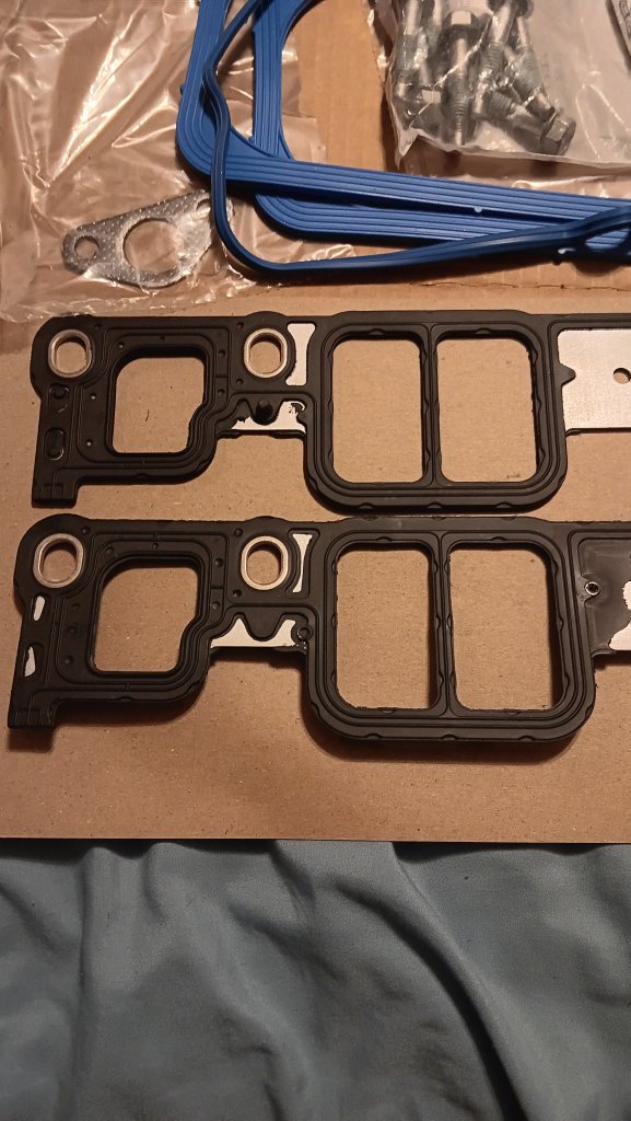

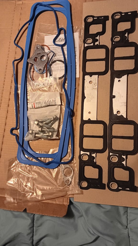

Just opened the box and I'm stoked! Came with bolts and the gaskets are so sweet I have no major permatex urges lol. Wish I knew about these sooner. They look galvanized and a magnet sticks strong. And I'll add that I was wrong about being felpro that just came off. The old ones turned out to be Mahle after all. I remember now because at the time I couldn't get a Fel-pro for some reason.

Are you messing with us?
It took me a solid week to read through dozens of threads to order that set and find the recommended part number for the Vortec Fel_pro number.
Had to waste money on 2 sets of plastic gaskets before I got the correct set.
1 came with the Mahle Master rebuild kit: Plastic.
The other, when I looked at pictures for the $36 set showing metal.... and recieved... wait for it.... PLASTIC.
Same darn set.
Different part number.
Mahle does not like SquareBodies?

So much good advice here since I posted last so I don't have much to add. Other than I do know that the FelPro metal gaskets did not used to include the manifold bolts. I reused the factory bolts countless times and the manifold always torqued down well.
@RanchWelder the Mahle gaskets are no longer available as metal? I bought a set a few years ago and used them in my '77 Vortec headed truck, so I know they at least USED to be available.
Suppose the Summit picture shows the bolts too, so YES, they might come with bolts now?
Yes, Vic Heinz has merged and Mahle is selling the same plastic gaskets, at 2 different prices, and neither one comes as metal.
Maybe Fel-Pro bought the dies to press the steel version? Never got a straight answer...
Still cannot beilve this nonsense has to be posted, in any thread, and Mahle did not send me metal gaskets when contacting the Alabama Sales Support crew.

The last few times I've got gasket sets, I've got them from Rock Auto. The descriptions actually specify if they are plastic or metal.

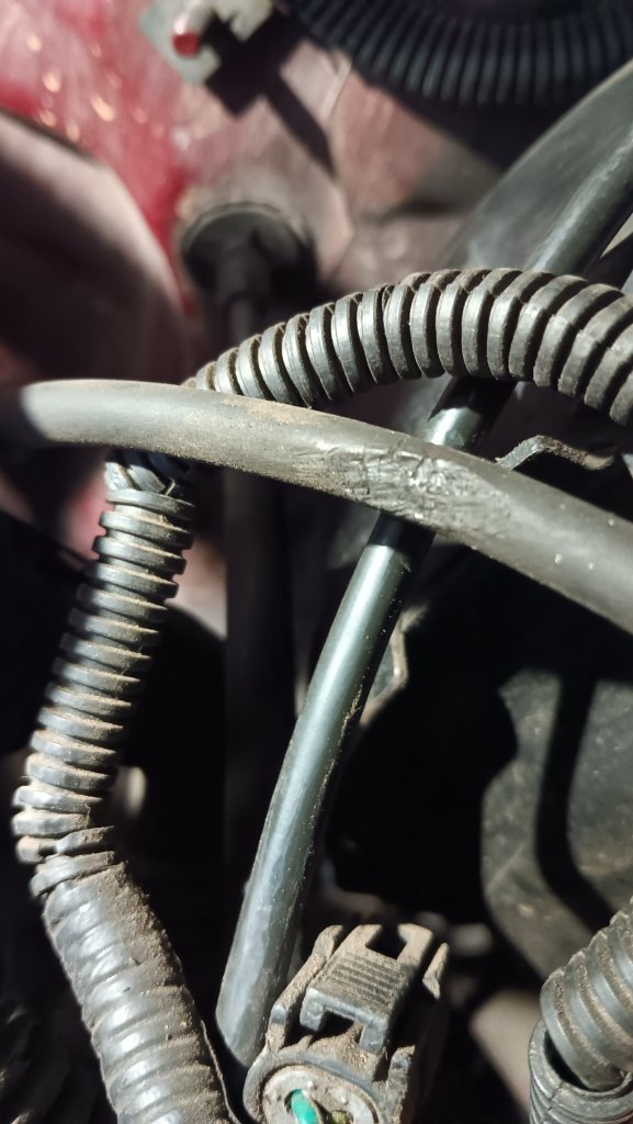

Maybe I found my pop when removing drivers valve cover. Found this plug wire pressed to the valve cover.

I think it's unlikely that your valve adjustment could cause the pop, but I won't say it's impossible.
