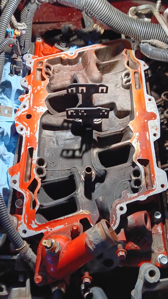

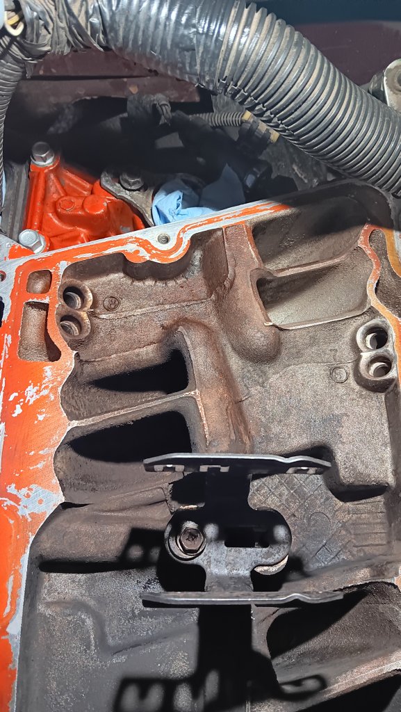

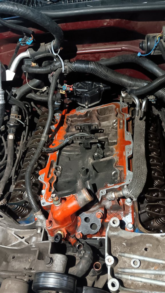

Here's some pics. And that's my battery freaking out. It won't work now??

Pretty much at a standstill till the spider comes in. While I'm waiting I'll check and regap the remaining plugs and check all header bolts. I found a loose one. Otherwise I've just got a couple things to do while I wait. I am wondering about my egr valve because its really old and electronic. How can I test it?
35,425
44,736
I'm not sure how to test the EGR on them. In the oodles and oodles of vortec 350's I've messed with, I've never had to replace an EGR valve. Not that I can remember anyway.
When you get your updated spider injector, make absolutely sure that you route the injectors to the correct cylinders before you push them in place. Once they are snapped in place, there's no way to safely remove them without damage. The main body should have the injector tubes labeled by cyl number to make it easy.
