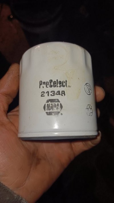

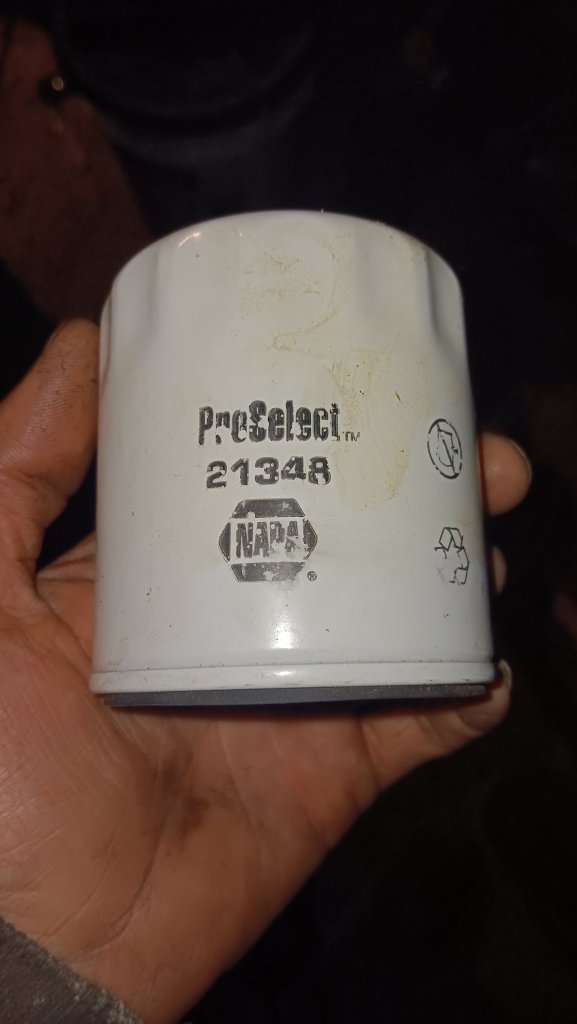

@SirRobyn0 here's the automotive small engine filter.

I think what matters is if it's a low bypass or not maybe?
IDK, but I have that exact filter you mentioned so I guess I'll give those a try and see how they work out.

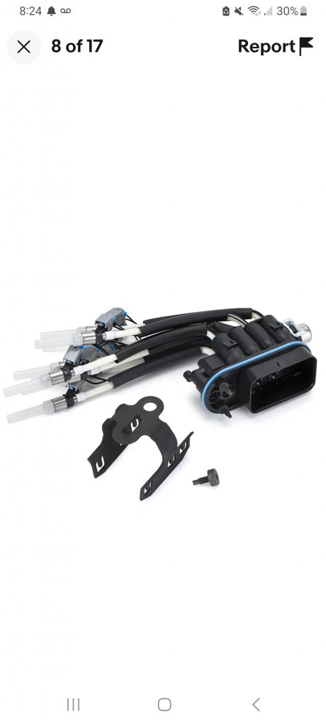

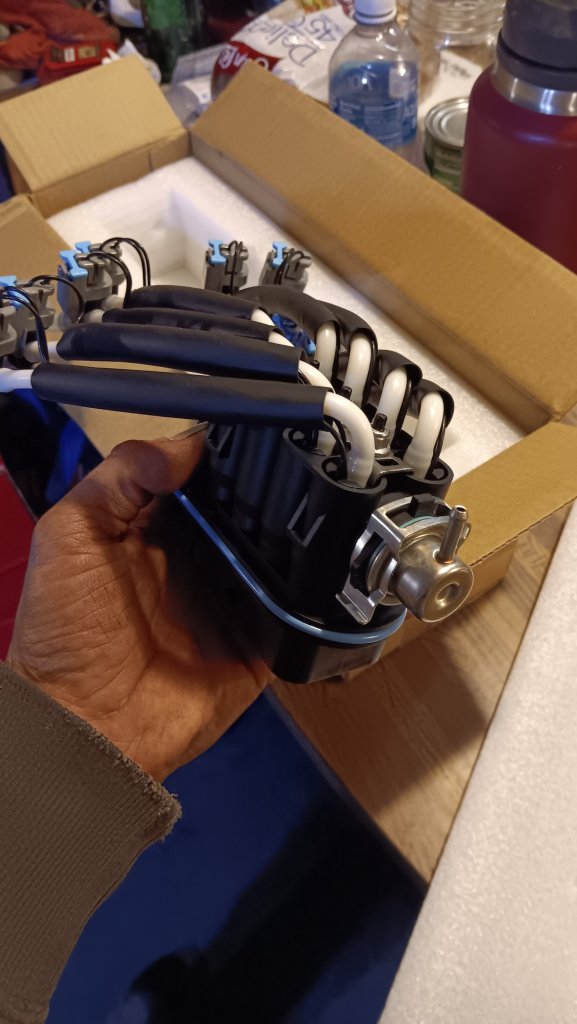

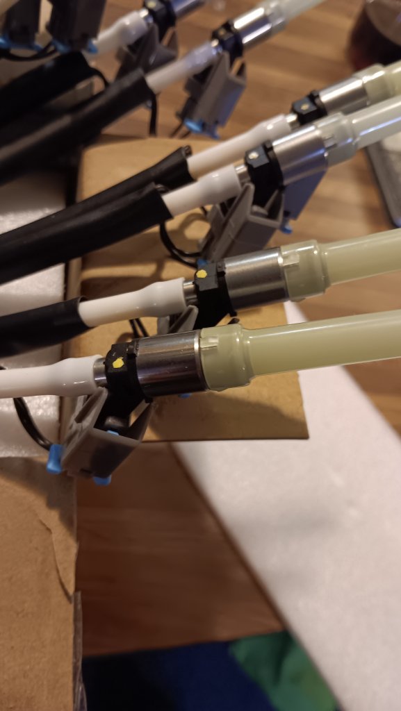

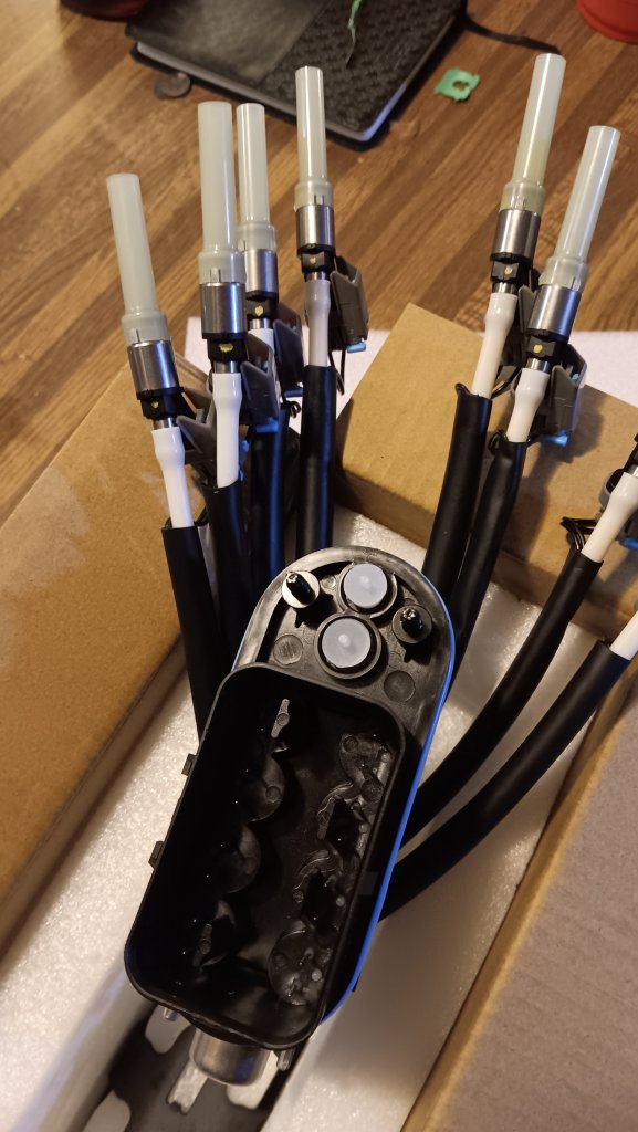

Here's what I'm waiting for in the mail. Legs are alot different from original. Looks like they will fit tight in there holes. Originals were a sloppy and has lots of space around.

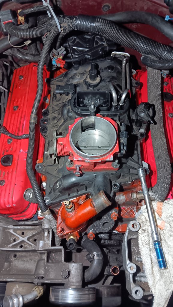

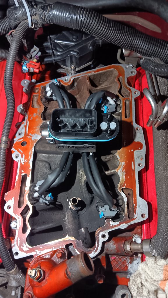

Also new coolant temp sensor and new tps. Seems to be running good again! Engine itself is quieter probably the valve adjustment did that. It's pretty smooth I'd say. I'm happy with it.
Ps: this thing is running 4°cam advance and no check engine light. Only side affect is its better on fuel because it has lots of torque
and the cap and rotor need cleaned more often. I'm cool with the better mileage lol.
