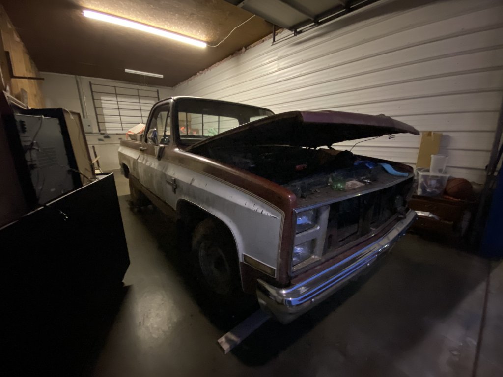

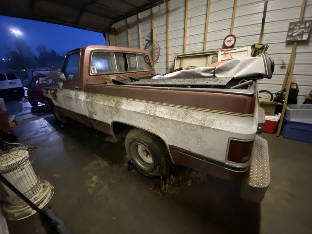

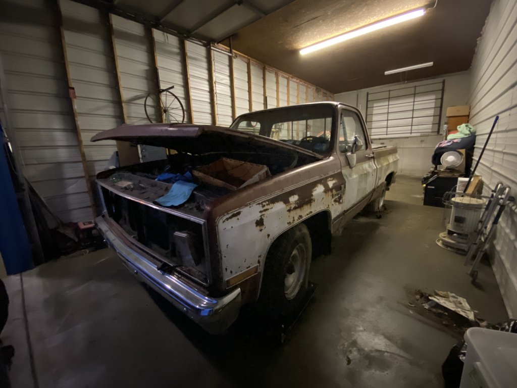

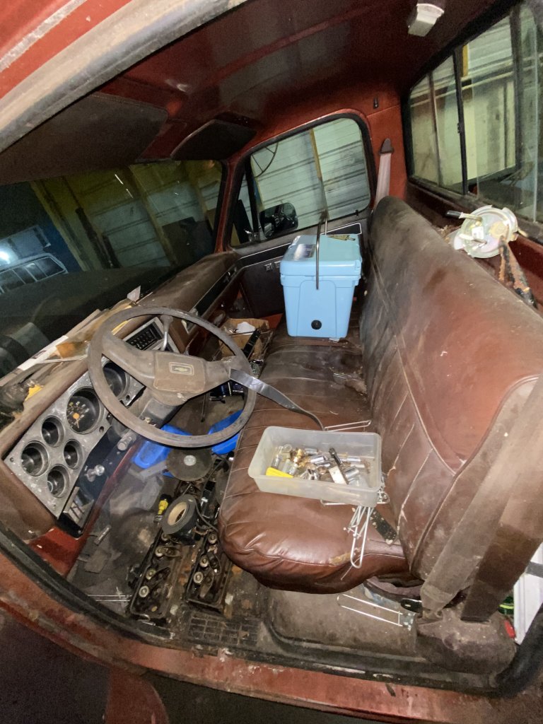

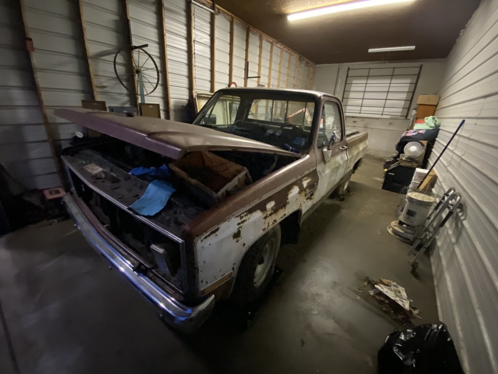

I would like to do things the “right” way. As I would like to enjoy driving it quite a bit.

Added some photos. Im not worried about the looks, just wanting to know more opinions about the engine and the actual mechanical side of things.

The first thing you need to do is take everything out of the truck, (unload it) and clean the truck up so you can see what you have. You will feel alot better about what you have if it is clean. It wont suck as much to work on if everything is clean. This step may take several days, weeks, or months, depending on how much time you have to spend on it. None of it is easy or cheap. You have to enjoy doing the work. Do as much as you can yourself, even if you haven't done it before, try it out. Spending alot of money will make you upside down on the value when you are done. Make it how you like it and make it fun to drive. Get it running with what you have, before you decide to change a bunch of stuff. Keep it real.
