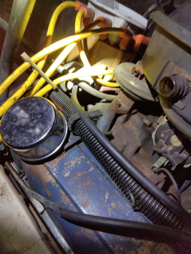

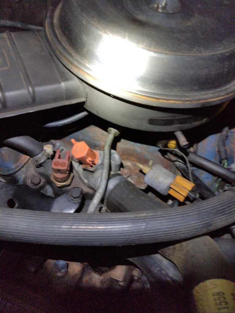

Couple weeks back I bought an 81 C10 custom deluxe two wheel drive with a 305 in it two barrel carb. I'm currently driving it everyday. It seems to run well and does great fuel mileage on the highway but around town it's only getting like maybe 8 miles to the gallon the truck is bone stock engine wise. The previous owner deleted the air vacuum pump off of the engine. I was told that he did a vacuum delete on the truck. From what I can tell the thermal switch is still in the intake manifold and the efe valve is still on the exhaust manifold. My issue is the truck is running extremely rich at idle or sitting in traffic the cab fills with exhaust fumes. The charcoal canister is also still in the truck but the ports are open no lines hooked to it whatsoever. Could someone please explain to me the proper way to do this delete or tell me if there is a kit out there to buy to put all the vacuum air pump and emission stuff back on the engine. I don't care about horsepower like I said it's my daily but I would like the fuel economy to get a little better around town and would love for the truck to not run so rich.
Also I've noticed the trans shifts wonderful but as you're cruising along if you go to an incline or slight grade and you go to give the truck a little more gas it almost feels like it shifts into overdrive instead of downshifting or holding steady RPM. Does that issue have something to do with the vacuum trans control switch that is no longer hooked up or has vacuum lines running to it on the driver side front of the intake manifold? Thank you any help would be greatly appreciated.

can you remove your air cleanerr and show us the carb? also, you have an electric choke ,thats good. YOu also have a miussing pipe from the air cleaner to the valve cover where that stick-in-breather goes. your air cleaner has that opening in it, it looks like the filter media is missing from the opening too.
heres some parts you may need down the road.. also, I Would like to see under your distributor cap. take it off , set to the side, and show us the mechanical advance with the rotor off as well, then show us the contacts on the cap where the rotor transfers spark

1. The two vacuum switches in your picture showing the thermostat housing (one is orange, one is red) are basically an open vacuum leak. They don’t look capped. You will want to cap them if nothing else. Your truck will run better. May have to adjust idle up afterward.
2. As somebody else said, look at the vacuum diagram for your truck or go find one and re-install the vacuum hoses. For some reason some bubbas think that ripping out vacuum lines is an “emissions delete.”
3. For your transmission: you should have a vacuum modulator line to the transmission. Just be sure it’s connected to the intake manifold. I don’t think your truck would have an overdrive transmission being an 81. Should have a th350. The th350 has a kick down cable that should be attached to your throttle linkage. Can’t see that in the pics. If that isn’t attached you won’t get a kick down quickly when you press the gas pedal down. If for some reason your truck has a 700r4 (with overdrive) , then yes you should have a kick down vacuum switch on the firewall. If it isn’t connected you won’t get proper kick downs.
4. Probably need to be sure your egr and vacuum advance are attached properly too. It looks like your vac advance is connected but the EGR is not. That can affect performance as well particularly on a 305 where IIRC the richer mix (less oxygen with egr active) can help prevent pinging.
If you post pictures with the air cleaner off some of this can be seen.
Edit: don’t worry about the air pump. That isn’t for vacuum and won’t appreciably change the way the truck drives. The air pump was to add air to the exhaust post combustion to aid the old catalytic converters. Totally different from the vacuum actuated systems that you need to have operating.
6,065
10,302
The two vacuum switches are not presently attached to a vacuum source,so capping them is not necessary. They are suppose to have supplied to them and they open or close based on water temperature to control components. See what you can figure out from your vacuum schematic, if you have trouble,let's us know we can pitch in and tell you what goes where.
