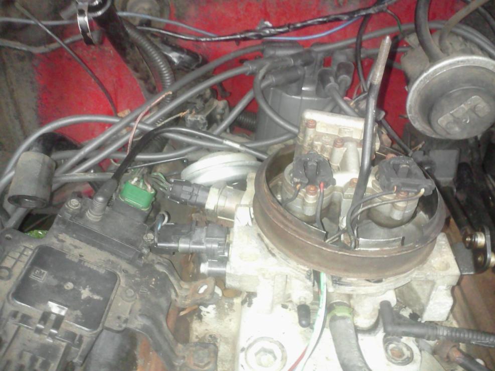

i will also note that on the front of the throttle body there is two nipples for hoses to connect 1 small one on the left and 1 medium one in the middle under the big hose in middle they both have rubber caps on them?
AMW
May 21, 2012
87
6
Georgia
Adrian
R10 Silverado
this picture you can see one of the caps on the nipple the other one is underneath that big hoses in the middle
crazy4offroad
Equal Opportunity Destroyer
8,496
1,157
West BY-GOD Virginia
Curt
K-10
350/SM465/NP205
TB = throttle body
Cats = cataytic converters
Really man I wouldnt wig all out on it, it's just a few vacuum hoses. Replace them one at a time and you'll know at least where those go, and by the time you're done you should be able to figure out where the loose ones need to go. I really wish someone would post up a pic of the EGR solenoid so at least you can see where it is, what it looks like, etc. but if all else fails plug the loose lines and see how it runs. Oh and leave the capped ports on the throttle body alone. They're fine the way they are.
