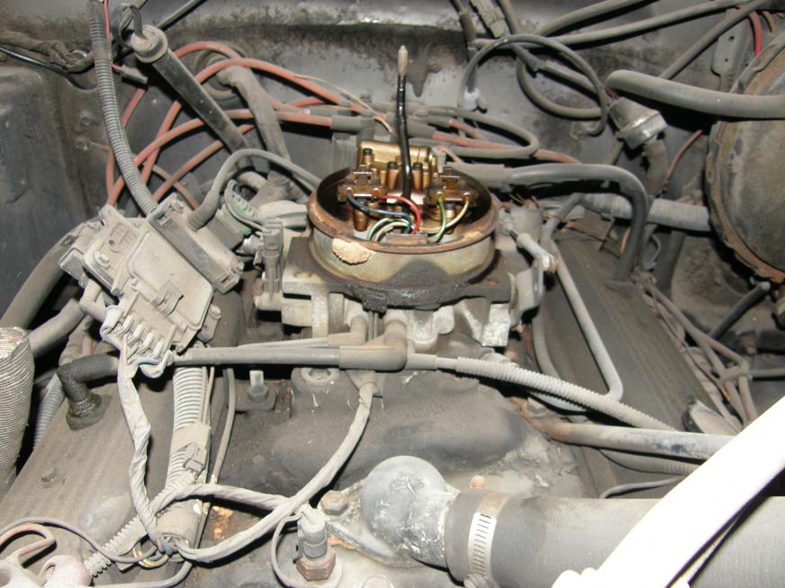

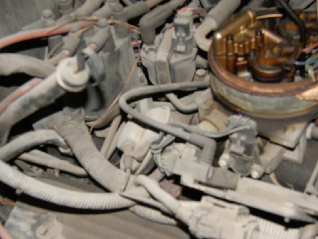

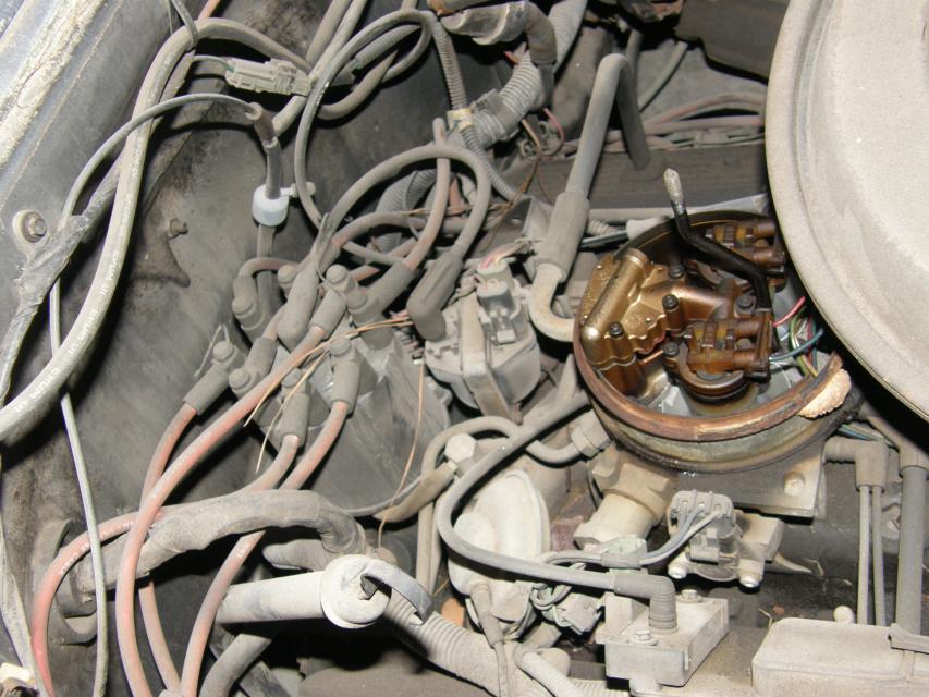

Hopefully these pics will help you.

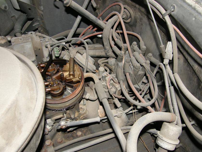

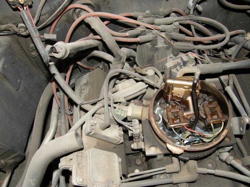

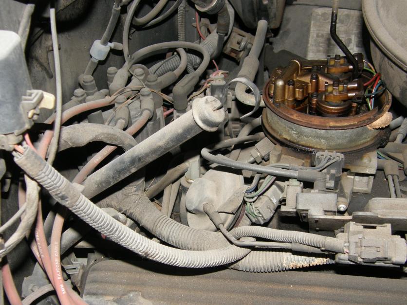

A few more.......
