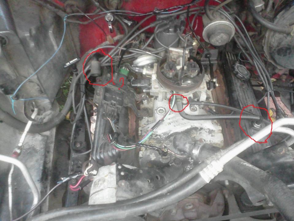

ok here is what i see i circled the two parts im talking about

Well hell it's hooked up. Just pull the end out of the valve cover and shake it, if it rattles it is good. If not it is gummed up and stuck either open or closed. It acts like a check valve.

the one part is connected to throttle body but the other piece it is a hard plastic piece that is sticking up on left side

The thing on the left is just a vent, you dont need to mess with it.
Swims350
4,356
815
Logan WV
none
thing on the left looks like the tube for the air cleaner when it's in place it gets hooked up, with it off it doesn't.
the pcv goes from the tbi to the top of the valve cover just as yours is.
there can be alot of others too.
replace ALL the lines, they are usually plastic and being this old can have holes or cracks, change them, take one of each size off and run down to your local parts store and get a few feet of each.
