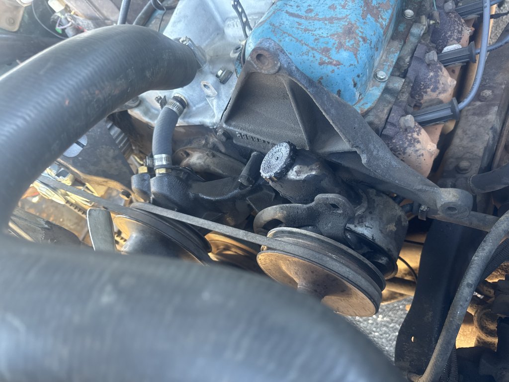

Howdy. I know this is my first post, but been using the forum for over a year to work on the 1979 C10 Big10 I bought out of a field in eastern CO last year. I have searched the forums have read up on the pros
I absolutely love the truck. Shamrock Green Metallic, 454/TH400, 8' bed. Silverado, factory cruise, A/C, but manual windows. I bought it non-running and have put about 10k miles on it in the last 12 months.
The factory air system is partially intact- the condenser and the evaporator are there (in unknown condition)- but the compressor, accumulator, and hoses are gone. I am unsure if this had an axial or radial compressor- I see conflicting info on LMC truck as well as the forums.
I want to add A/C back this spring, but am debating what route. Do I get a modern kit from Vintage Air, LMC Truck or Classic Auto (that uses factory ducting, not underdash), or do I build the system with factory components? From a quick look, Rock Auto and or LMC should be able to get me all the components and it would be a good bit cheaper than a Vintage Air or similar kit. Welcome any input or suggestions from people with experience here.
