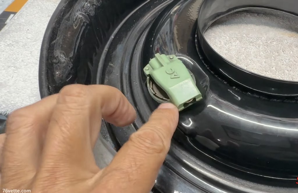

The vacuum operation of the Thermac system requires several components to work correctly.. I'm fighting it right now on a factory air cleaner for my engine. The small heat sensitive vacuum switch mounted inside the filter element kept the engine air intake at a specific temp range during operation, not just at start up. It cycled depending on the outside air temp the snorkel was receiving.
I got a replacement from Camaro Central but can't get it to function no matter what the temp..

GM used several different thermac switches. Need the correct one for your truck.

Yes, I know that but they aren't available
