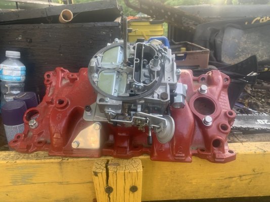

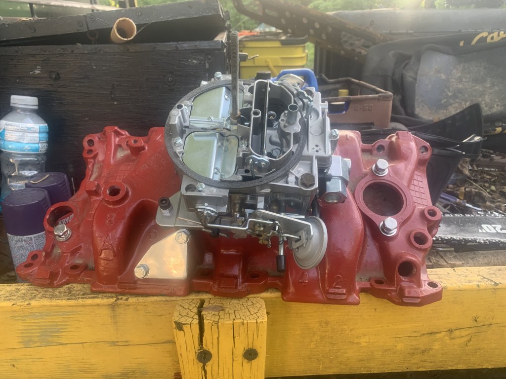

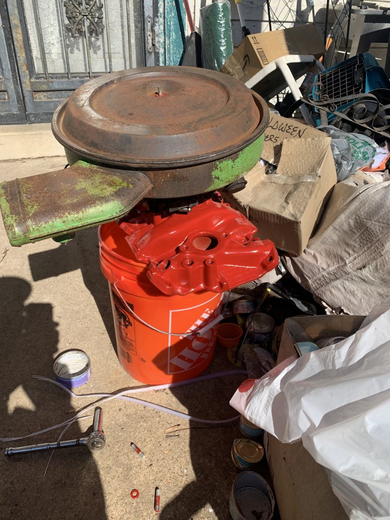

Maybe there are some better made ones out there. These are how they fit up on both an oem base and this dual snorkel copy. When I tried a gasket the air cleaner just kind of slid off the spacer since it doesn't have much of a lip. Guess i could've glopped some silicone on there so it would actually filter the air lol.
Pics of notches in spacer where the tabs are and 1 rotated around= sloppy fit no matter how I turned it.
Rounded edge on factory style base vs thin edge that would seal up on aftermarket base
$1 at the junkyard with the lower tabs ground off. Plenty of room for a gasket
