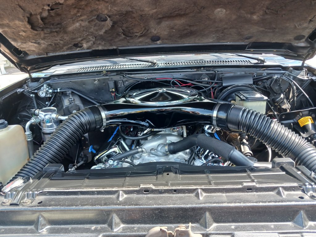

I had two of these fiberglass dual snorkels made. I painted each one to match the color of the truck I put them on. They have been on for 20 years and still work great.

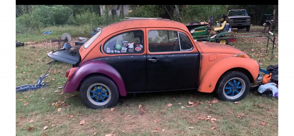

Spray paint color test. Will be done in actual automotive urethane base/clear. Mopar Sublime green door cards, seat pipng and seatbelts that I rewebbed using factory hardware. ARE 8 spokes, will have Waterfall 195/55vr15 fronts, 215/70r15 rears.

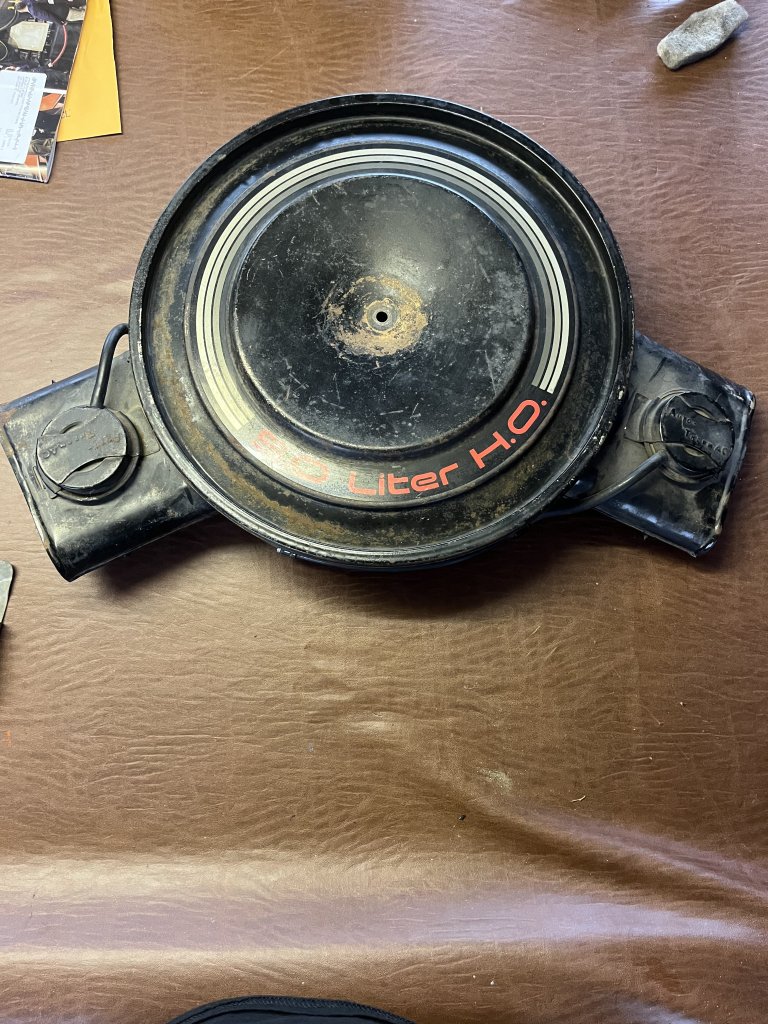

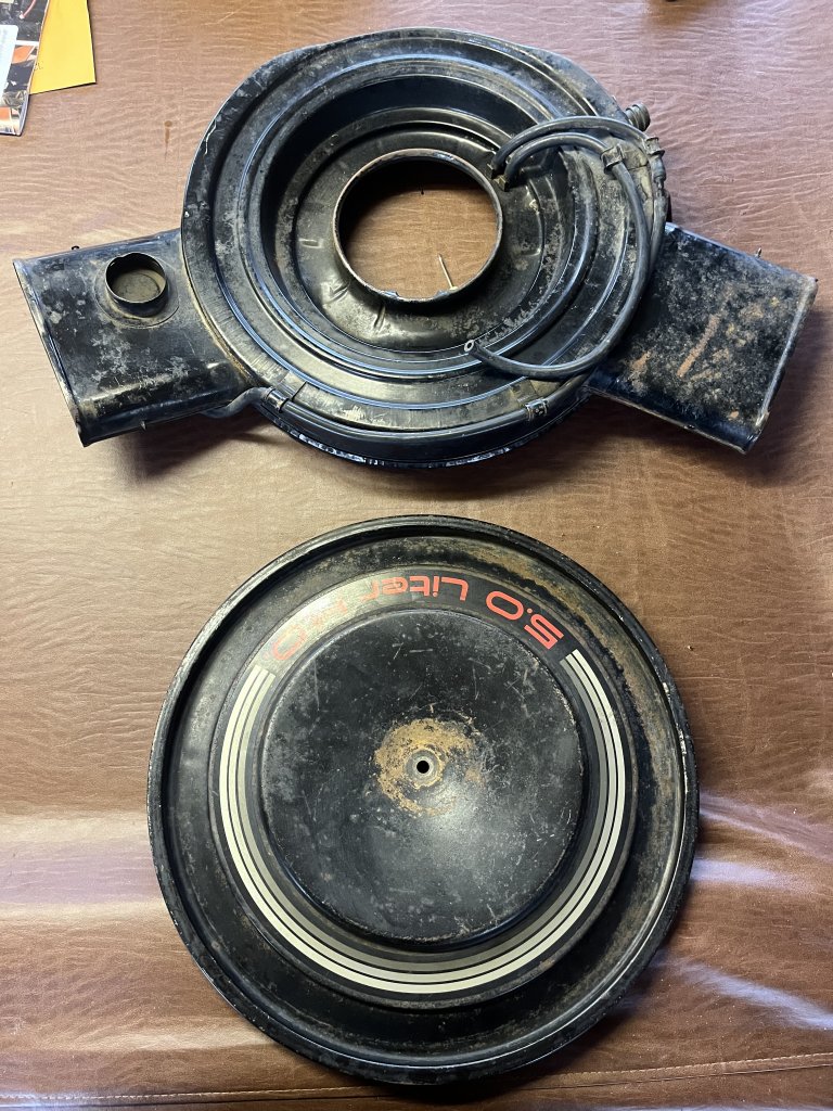

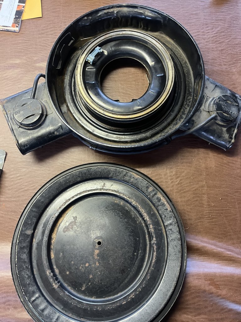

So I came across a dual snorkel off a ‘84 Camaro in a LKQ yard yesterday. Any idea how hard it would be to make this work on a 350TBI or is it not worth the trouble? Went to swap it on my truck and the base sits lower than my stock base and runs into a bunch of sensor brackets and other stuff. Also, it’s vacuum operated so if I decided to use the aircleaner base where would I tie into vacuum for it and will it work as well as the expanding pellet thermac on my TBI or better or worse? Just wondering before I sell this thing if I can actually put it to good use? Maybe cut the center out and use the center out of my stock aircleaner? Maybe use a spacer but the stock TBI aircleaner already has that spacer so is stacking good or bad? What do yall think?
