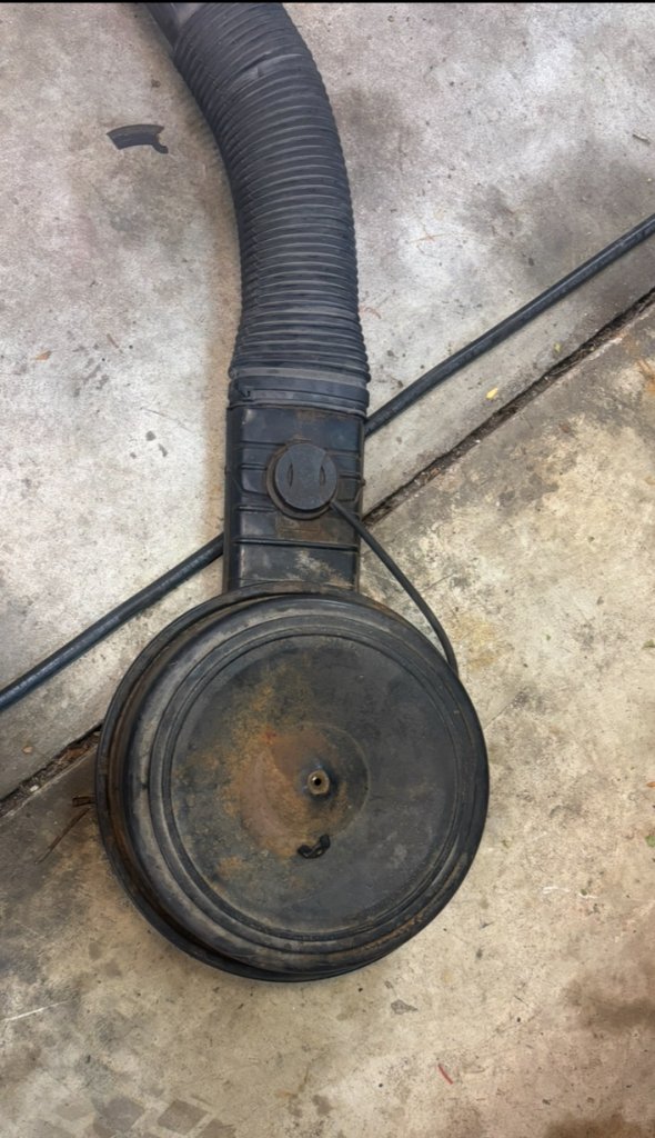

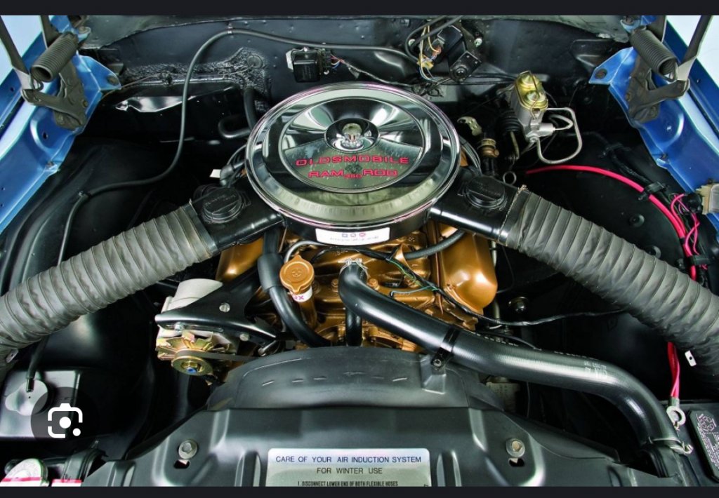

You can use an air cleaner spacer ring.Any idea how hard it would be to make this work on a 350TBI or is it not worth the trouble?
They are available in many different heights. 1/4", 1/2", 1", 2" etc. 5 1/8" diameter.
Use manifold vacuum. The stove pipe side will use the temperature switch, for engine warm up. The other side will open when manifold vacuum drops, engine needs more air when you punch the throttle.
