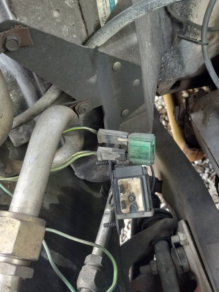

He also pointed out an electrical connection that was jumpered, I'll get a picture of that and post because I'm not sure what he was trying to tell me. Thanks in advance

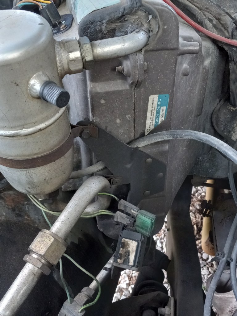

This is the jumpered connection.

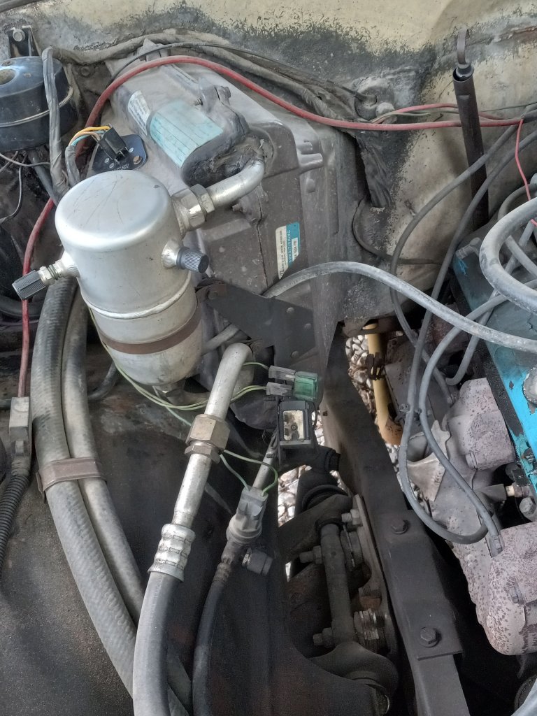

I've never messed with an AC system before, so parts/terms/etc. are new to me, and I don't have the vacuum pump or gauges for doing the whole job myself. The drier is the aluminum can in the last picture, correct?
Yes, that's the drier(or some call it the receiver dryer).

Anyone know what the electrical bypass is?
Blower motor blew its fuse again. Truck was rewired, so not looking forward to trying to figure that one out.
