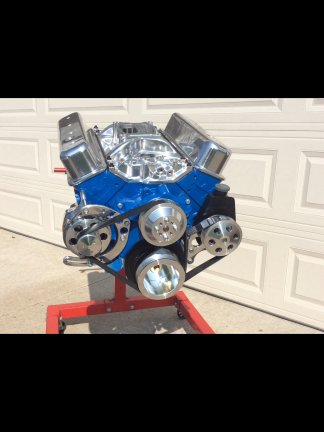

I have a built 383 stroker! And decide I'm just gonna run a carb and see how it goes. The engine has been all rebuilt and it should be making around 300-400hp! I would like to be able to start it during cold conditions with very little problems also! TBI and efi is out of the question right now. What carb would you recommend throwing on this motor?
Current state of the engine!

Can you share more details about what cam and what ignition you plan to run? Looks like you have a single plane square bore intake? With that info it will be easier to decide on a carb. Normally I would say a Q-jet but an Edelbrock would work well if took the time to tune it.

I see a spreadbore dual plane :shrug::shrug::shrug:.
For all season driving, My personal vote is a Q-Jet.
I say stay away from edlebrock... others will say stay away from holley.
But I have yet to find an eddie that has kept up with my holley.
Tuning the holley is a bit more complicated, but is ultimately a lot easier than an eddie. Eddies are nice if you want a bling bling engine with lots of chrome, and they are CHEAP.
Ah, yes, a closer look and I see the spread bore. *******!
In that case I vote Q-jet.
