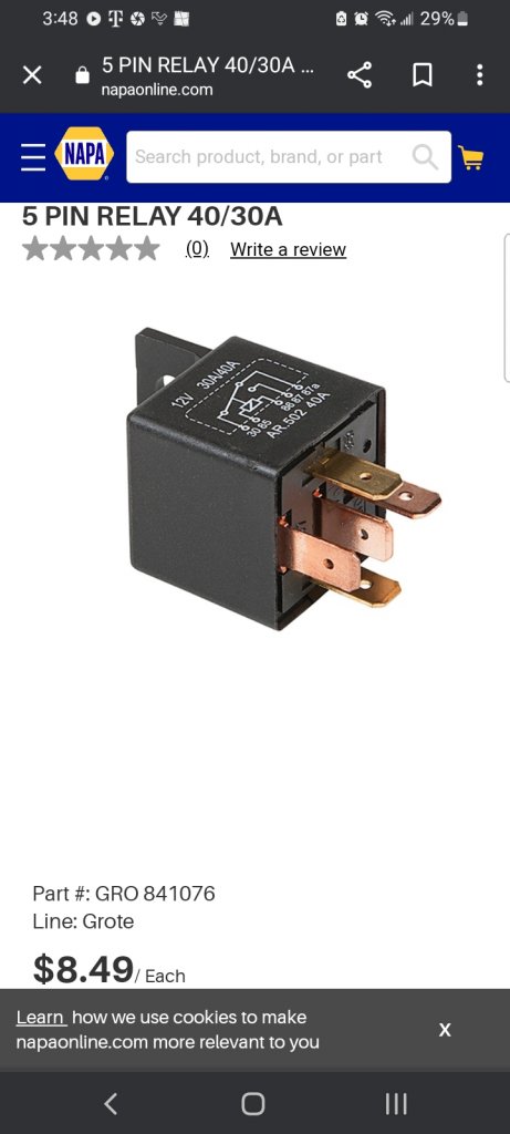

Hey, @Ricko1966 got a question for you (or anyone else that wants to share).
Seems like you know your electrical.
I working on wiring my fuel pump for this truck. I was originally just going to run a switch with an inline fuse, and call it done, but then i read a bit you wrote on relays and thought maybe thats the way to go.
So my quesion would be what woukd you suggest?
Either power to a fuse, fuse to switch, and switch to pump, or run a relay?
Also my question is, if i run a relay, do i run a fuse too? If i do, would you run it before the relay or after? Also, does the signal wire/switched power need a fuse, or is the draw detremind by the relay and/or gauge wire.
Also, what gauge wires would you suggest? Im totally out of wore right now, need to go get some. So far, i have 14gauge running from the pump to the cab, and now im out.
10,175
19,684
I'd use a relay I wrote this up for somebody already with part numbers. Ps 64 chevrolet vega oil pressure switch. Plumb it in to block above oil filter. 3 terminals on switch p,I and s, s to starter solenoid,p to fuel pump positive. I to terminal 87 on a 4 or 5 prong relay terminal 30 of relay to 20 amp fuse, other side of fuse to battery. 85 to keyed 12v, 86 to ground.. 14 gauge will be fine. Make sure your pump has a good ground and make sure all connections to 30 and 87 as well as at the pump are good 12v pumps don't play nice with compromised voltage.
