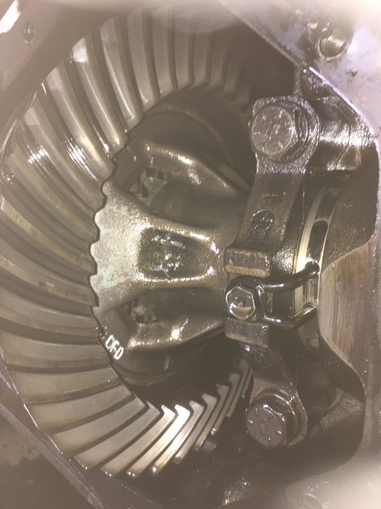

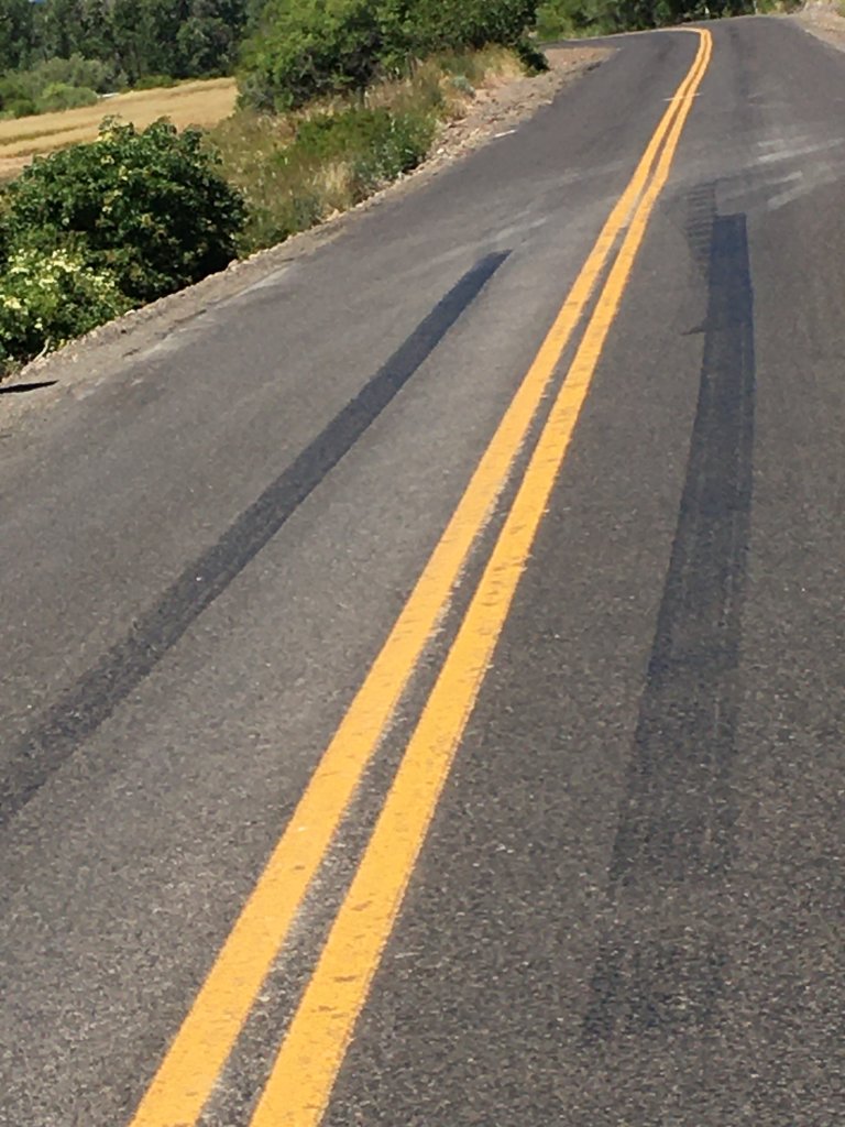

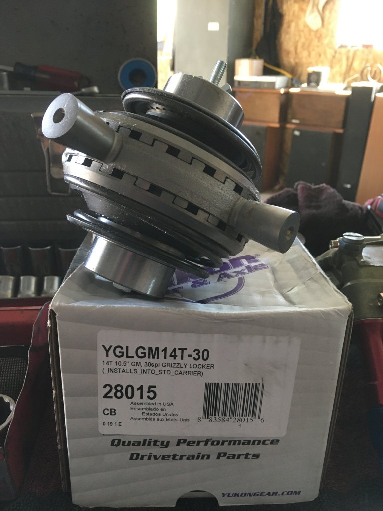

I used a Yukon Lunchbox locker, and like it. Mine was a FF14 10.5 open diff, so easy to change out and done in a day. However I live in the hills in central Commie Wa St. and my driveway can be a challenge in the winter, yeah we get a fair amount of snow up here. I do have a write up on the swap, will find it if you were interested. I also did the same to the front end, so quadra-track. Having said that, it is a handful in 4 wheel drive on the road, but awesome on the ranch in the hills. I am converting to a twin stick, but haven't got it completed, but others here loved it, hence the reason I am converting. Cost around 250 bucks. BTY motor was a 454 cam, intake, exhaust, gestimate HP 375hp, MANY burnouts, and rear end perfect, trans, not so much, got a write up on that to.

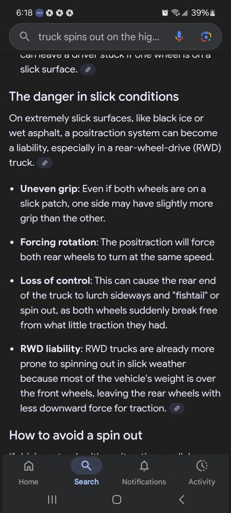

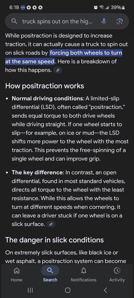

A lot of people don't realize that one wheel peel vehicles in rain,snow etc. spin 1 tire and continue in the direction you are steering. He was concerned about one wheel peel in slick conditions. I asked if he knew if both wheels break loose you go sideways or off in the Ditch or spin out. Not a problem for some people,but others don't realize posi has pros and cons. Drift cars aren't running open diffs,too hard to get them sideways they run posi or spool so they can get them sideways.Manufacturers now have stability,traction control and ABS because not everybody knows all the in' and outs of posi,brake modulation,etc.

Oh, yah too much gas in a turn even when it's dry hell even in a straight line it can get loose add wet and it can get out of hand in a hurry. A posi unit is not as bad as a spool because it at least will differentiate when you back out of the gas, a spool will fight you thru a turn gas or not. My first ever accident was due to playing too much and a posi driving me into a 180 while going downhill. A lot of people get in a car that makes decent power and a posi and get in trouble what do you think all the Mustang vs crowd videos are caused by.
