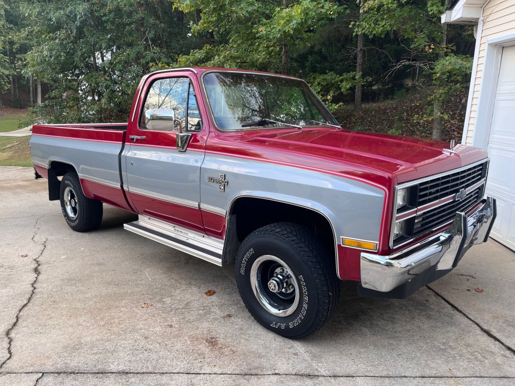

I recently purchased this 1983 K10. It has a new 6.0 LS motor with a TH400. The truck will not go into 3rd gear. Sometimes I think it's trying to grab 3rd when the tranny is cold, but slips right out. I feel I have done all the recommended suggestions on YouTube with no results:
1. Changed the fluid
2. Adjusted the Vacuum modulator; had no change in either direction, so I changed it. Still no changes in shift strength or point when it shifts.
3: I removed the governor and found the valve was stuck. Disassembled and cleaned. Still no change. I ordered the kit to adjust the weights. I put the heaviest weights on and was going to adjust if I noticed a change, but it made absolutely no difference.
4: I verified the shifter was aligned correctly.
I am at a loss of what to try ot look at next.
