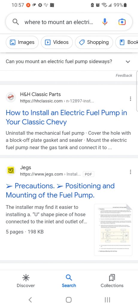

Down
Download load the summit instructions download the jegs instructions download the Holley instructions .Again I'm not going to try to reinvent the manufacturer mounting instructions.Maybe there will be no problem,maybe there will,why chance it he can mount it in his glovebox if he wsnts.its his truck.

Just for fun I just now google searched electric fuel pump mounting location. 10 results I didn't read the last one but the first 9 said mount the pump low,I didn't read the last one,didn't watch any of the videos.
