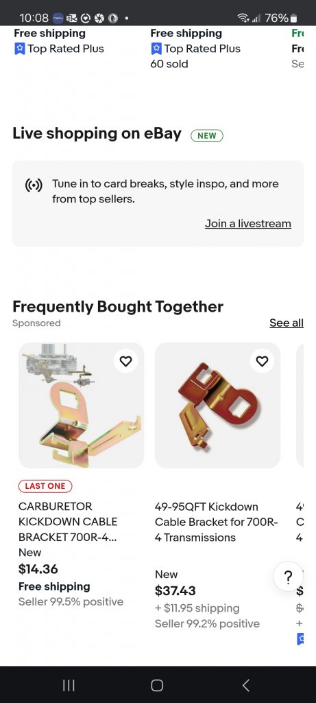

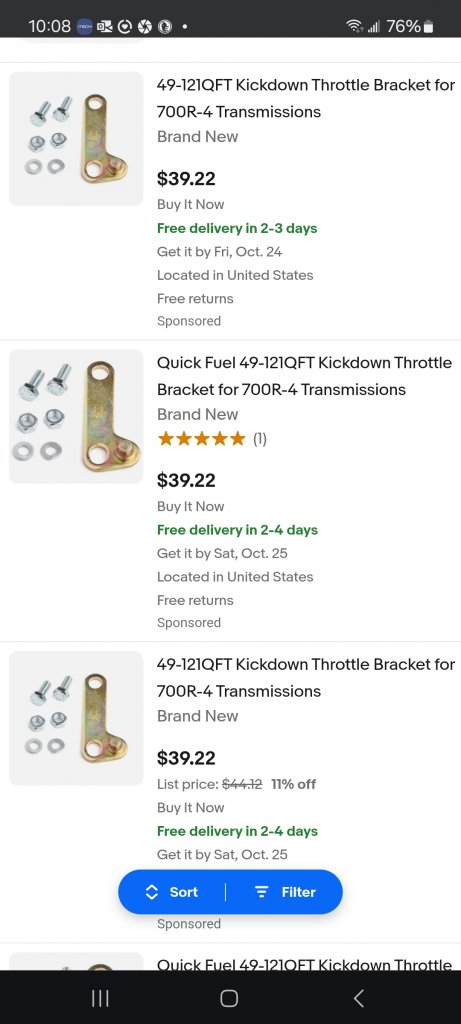

Truck will have a Quick Fuel Electric choke 650. Im under the impression they are made by Holley? Does anyone have the link to a TV bracket setup ?

Looks like they are different than Std Holley
