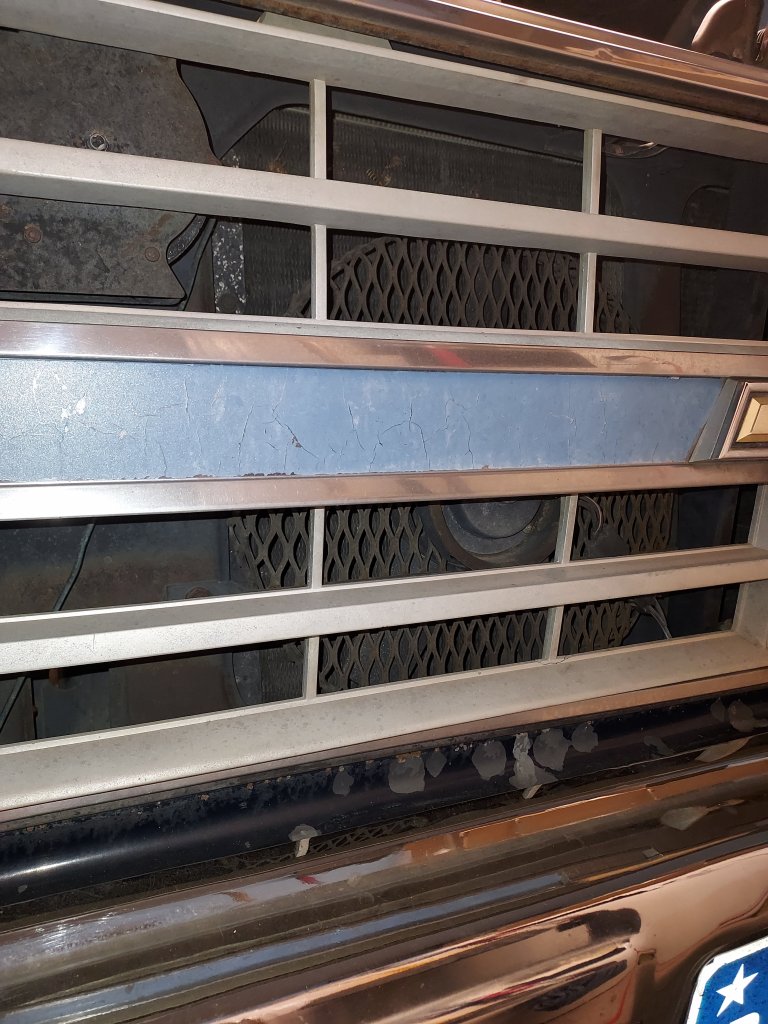

So, what say you guys on going to a 180° vs the stock 195°? I recall this 3/4 ton, 454 was running at 210° before we started tare down. Inside radiator very clean, looks like it was replaced at some point.

Perfect pro and cons, or just simple good info. Lol, yes I don't like temp getting to 210° Interesting note, I see this truck has a small metal electric fan on front side, infront of AC condenser. Haven't seen it move or checked out yet. But if related to AC I we still have to fix/replace compressor etc.
