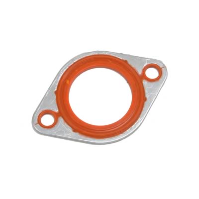

Where can I get an OEM thermostat for a 1974 Chevy C10 with a factory 454cu.in.engine? Also a tstat housing gasket?
