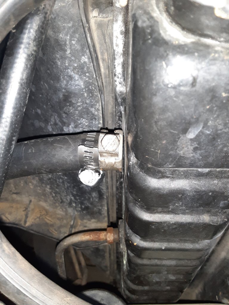

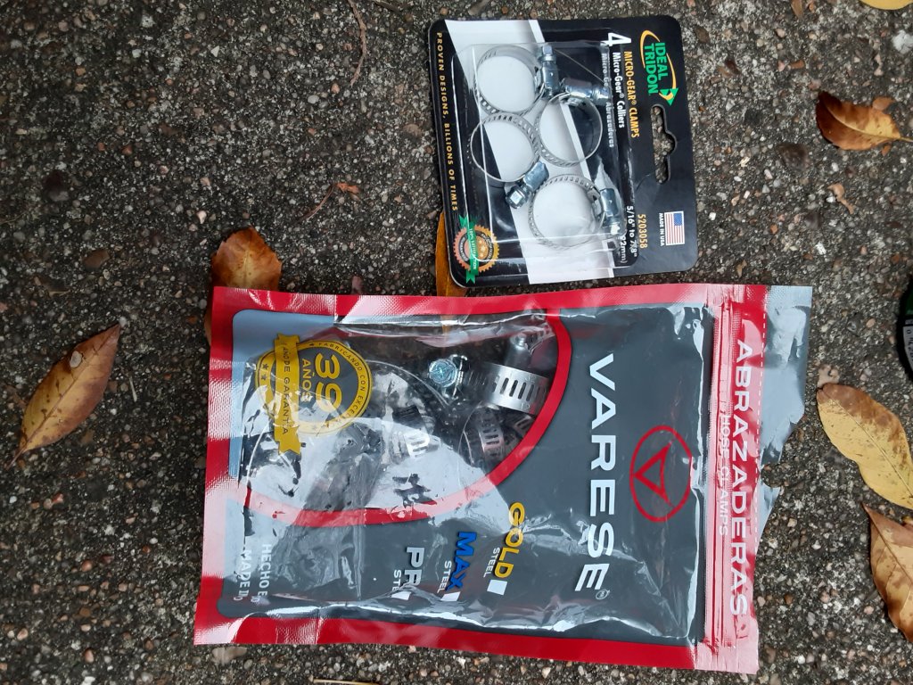

The old tower clamp seems to not be working right anymore, and the radiator guy pointed it out.
Fiddling with it yesterday made me believe him as just loosening it got me some heater hose leaks. The plan was to replace it with a 7/8 clamp style.
2 problems -I could not get it to slide down, and I was too lazy to take the hose off and lose antifreeze, which is good as 7/8 was too small.
These dam things are also a victim of the supply shortage ( the clamps) so I grabbed a big bag of assorted sizes at Vato Zone today.
Voila!

Can u get tower clamps? Or did u have to go with hose clamps

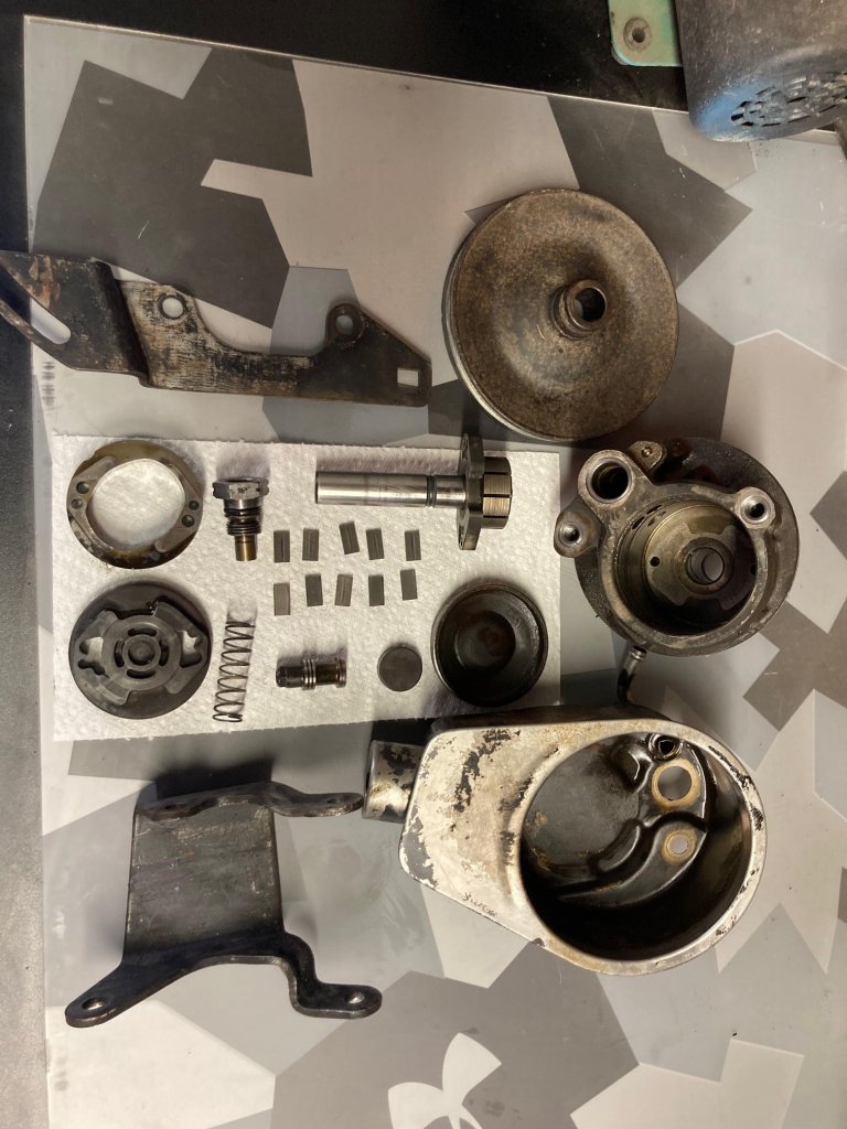

Disassembled the PS pump this afternoon and cleaned internal parts. The rebuild kit I bought looks to be the right one. I've got to take a wire wheel to the body and reservoir so I can repaint it, or my OCD will drive me nuts. The hardest part so far has been getting the whole thing out of the truck, and getting the pulley off the shaft. Rebuild and re-installation look to be easier.
I just bought what I could find at the parts store. Tower clamps are OE, so I'd probably replace them if I could find more.

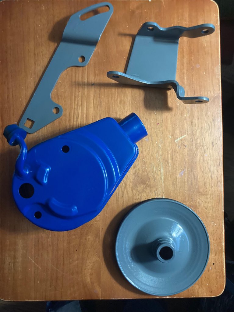

Finished rebuilding the steering pump assembly. It took a while as there was sludge build up on all the internal parts, as well as the reservoir. Removed it all with brake cleaner, rags, and a brillo pad. Next up is painting the reservoir, reassembling everything, and reinstall the whole thing back into the truck. I'm planning on flushing the whole system once it's back up and running.

Can't wait to see how awesome the rebuild works. Imma bout to start doing this when needed vs buying reman junk from the parts store.
Looks good!
