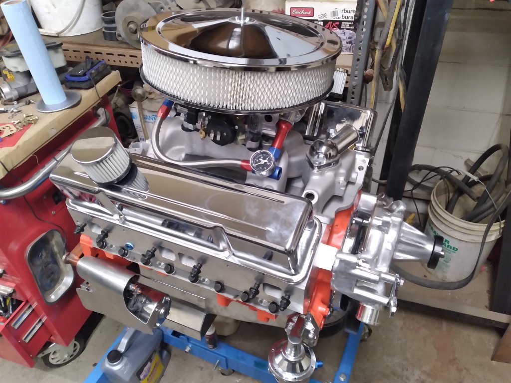

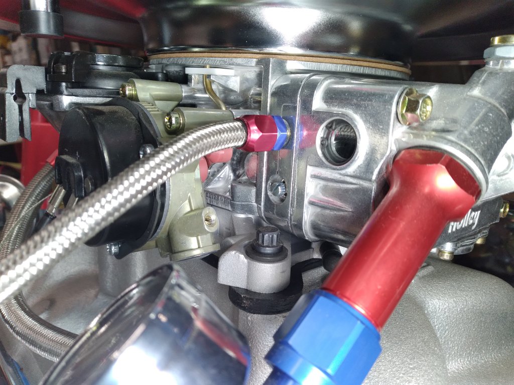

Been making the engine pretty lately, though I will need to slow that process down for a bit, as my income doesn't match my wants for the squarebody..... and I'm getting sick of KD's and hot dogs, rice and hot dogs, and hot dogs...

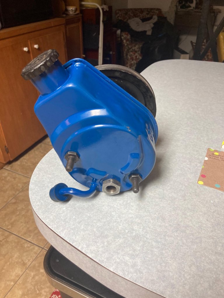

So far everything is going well.I put it all back together this evening. Putting the pulley back on was somewhat of a pain. It kept wanting to go on at an angle. Once I got it straightened up then it went on pretty easy.

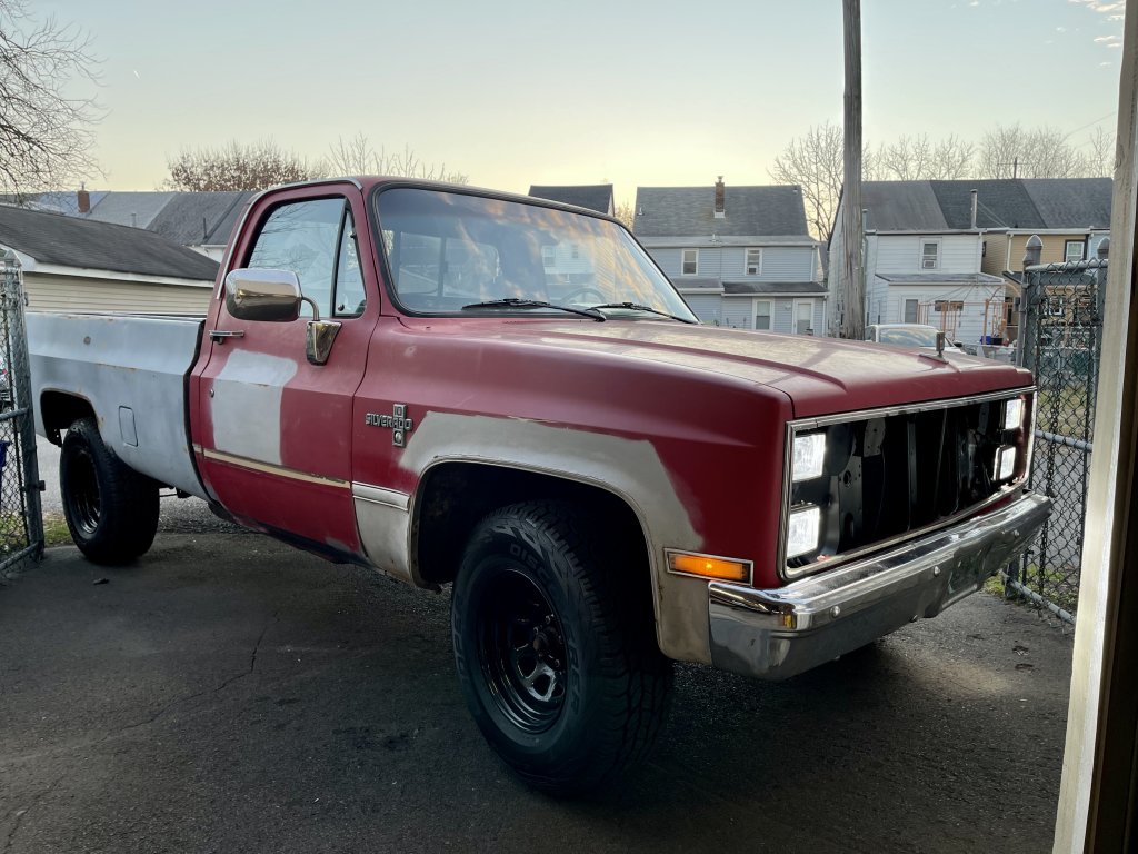

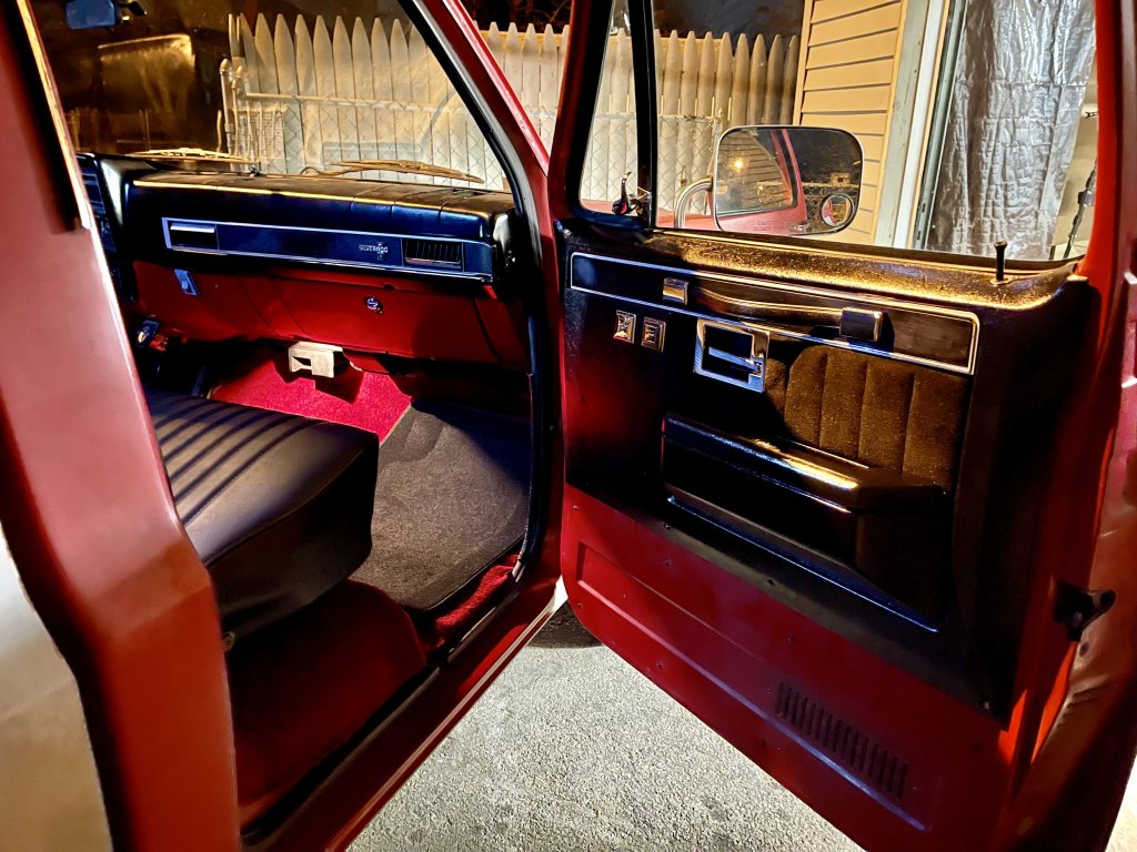

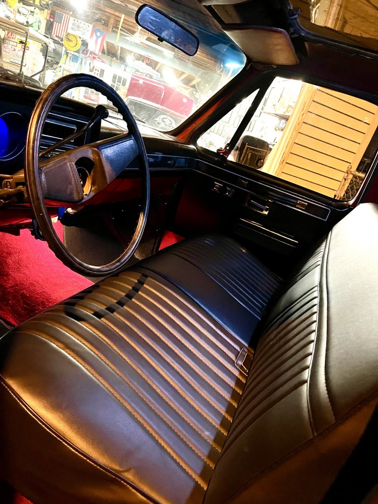

Pretty much finished the interior just waiting on a new dash to come in. Led head lights too

Disassembled the PS pump this afternoon and cleaned internal parts. The rebuild kit I bought looks to be the right one. I've got to take a wire wheel to the body and reservoir so I can repaint it, or my OCD will drive me nuts. The hardest part so far has been getting the whole thing out of the truck, and getting the pulley off the shaft. Rebuild and re-installation look to be easier.
fortunately that pump appears to be in good shape, in terms of no issues from contaminents or severe cavitation issues etc.
to protect your system in the future, I suggest putting a 3/8 inline PS filter on the return line(great time to make a cooler if you were ambitious) since the issues of that pic above there are from metal bits being abrasive inside. Its hard to say if its from the gear or if the pump had some major issues before my time. I flushed my fluid and put a good used pump on and put a filter inline to protect it and keep it from being worse than it otherwise could be
if you are keeping your OE cap make sure it doesnt have a plugged vent, otherwise toss a new one on there

I installed the pump back in the truck but I couldn't complete the job as the return hose broke in half while preparing to hook it up to the pump. Bought enough fluid to do the flush once I get a new hose attached.
