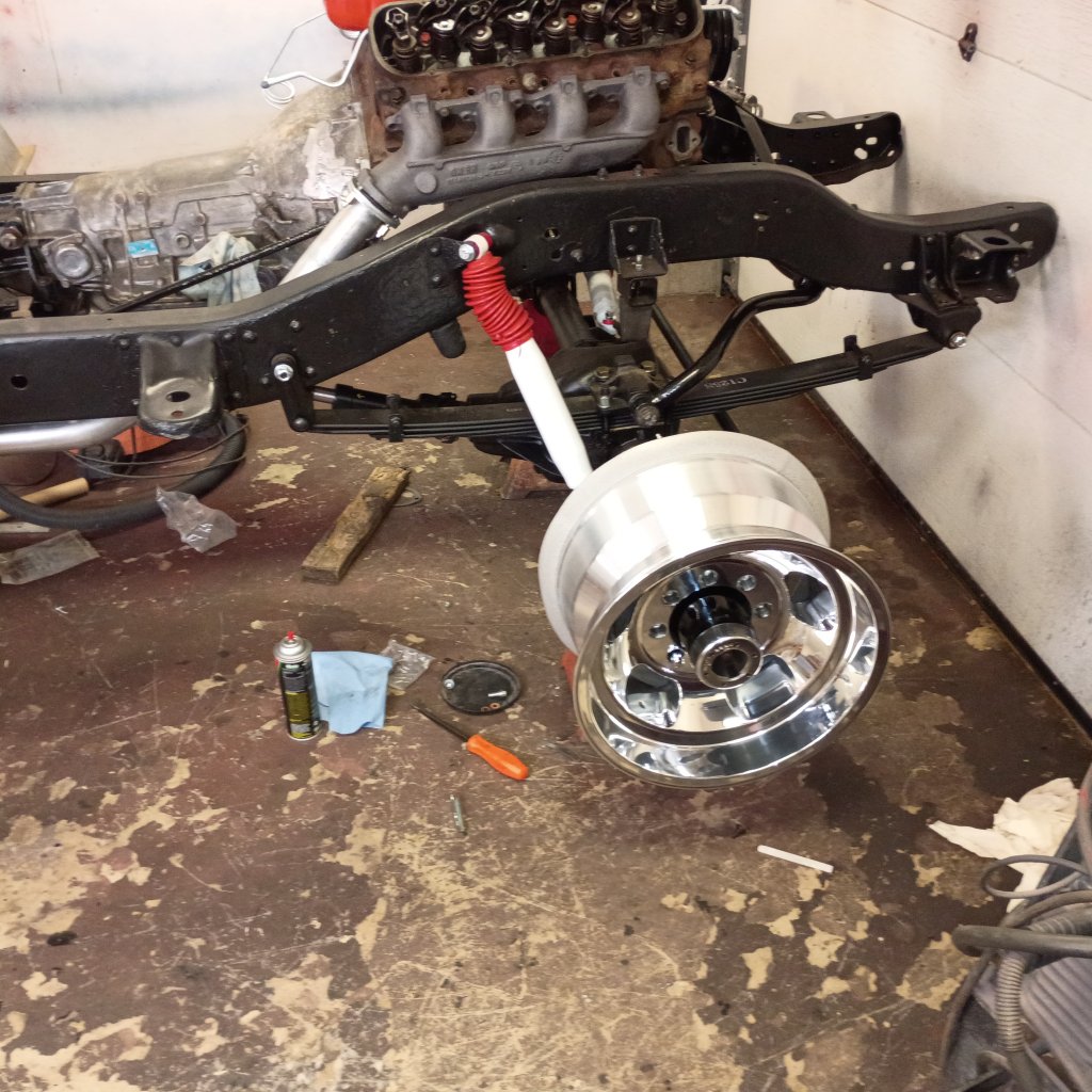

Getting Close!!!
Cant wait to get wheels and tires on it and off those rollers....
To steal a line from Shawshank Redemption
" I find i am so excited I can barely sit still or hold a thought in my head"
I’m not sure if you have a shop or in a warehouse- I need your space - I would look less cluttered lol

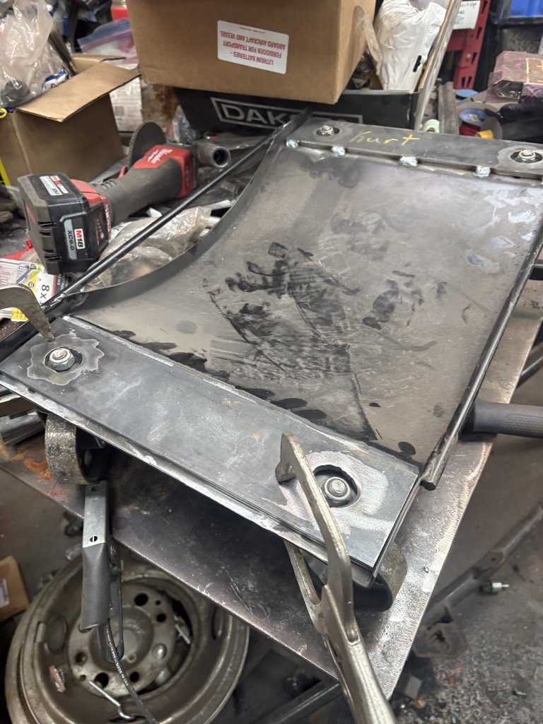

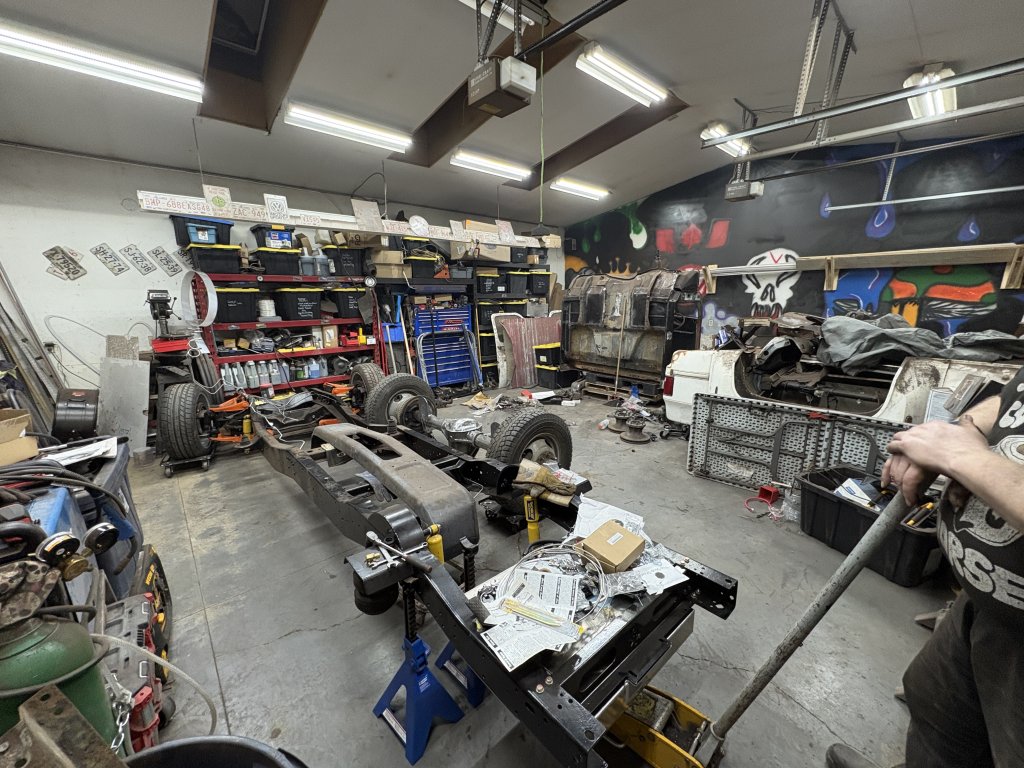

Managed to strengthen the wheel Dollie’s today, and get a hand cleaning up the shop, final sweep tomorrow and ready for a busy Monday of rust removal on the cab and box floor

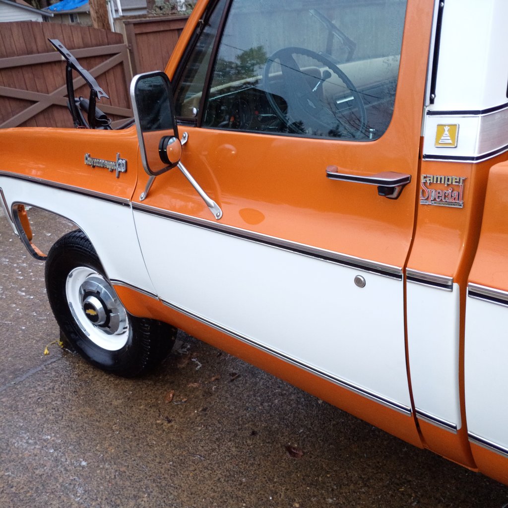

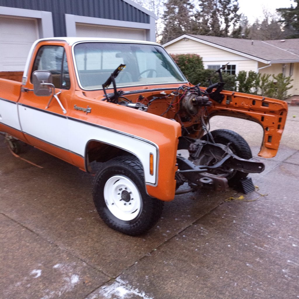

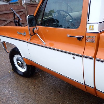

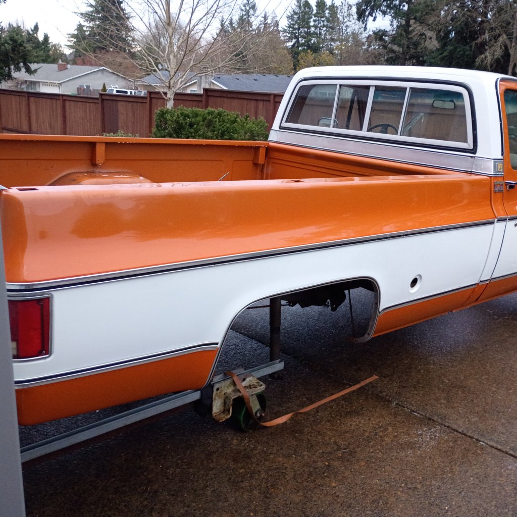

Pulled the C20 out of hibernation to prep for the body swap. It's been sitting in the lean-to for 10 years with crap stored in and around it, cat's peeing on the wheels, sleeping on the roof, sliding down the flanks, etc. It cleaned up pretty well, will clay bar and buff after it sits on the K20 frame.

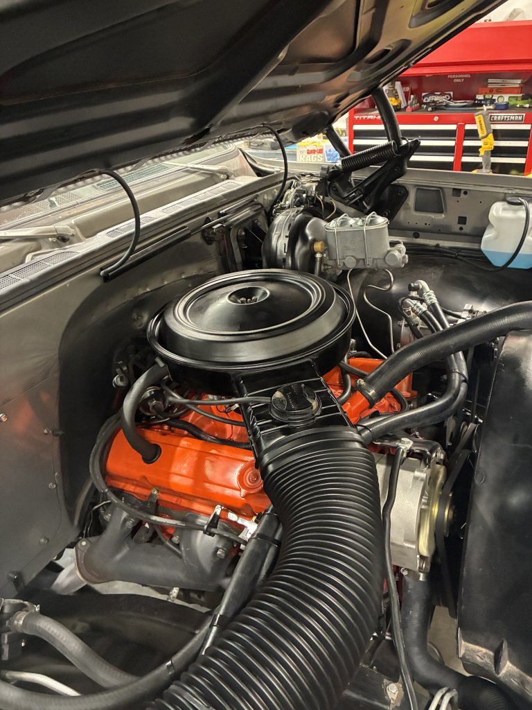

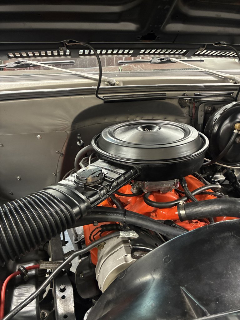

Used a one inch spacer to adapt a factory air cleaner with the complete Thermac warm air system to a 600 Holley.
The Vintage Air condenser lines took the factory air intake spot in the core support so I'm gonna adapt the fresh air intake it to the passenger side inner fender.
I'll fab up a "Stove" for the Hooker manifold next...

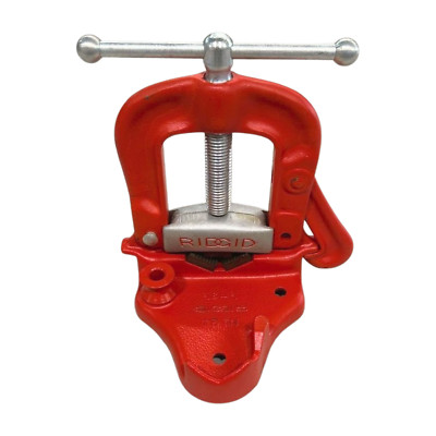

Think something like this would do a decent job as a housing clamp?
I've got a large one already mounted to an old welding table. It works great for holding hydraulic cylinders. I'd just have to find a 2nd clamp, of course.

I think it would work well, make a riser block to get it up higher for pumpkin clearance. Really one vise and one height matching v block from wood or fabricated would probably work just fine. Two vises would definitely be a that's not going anywhere.
