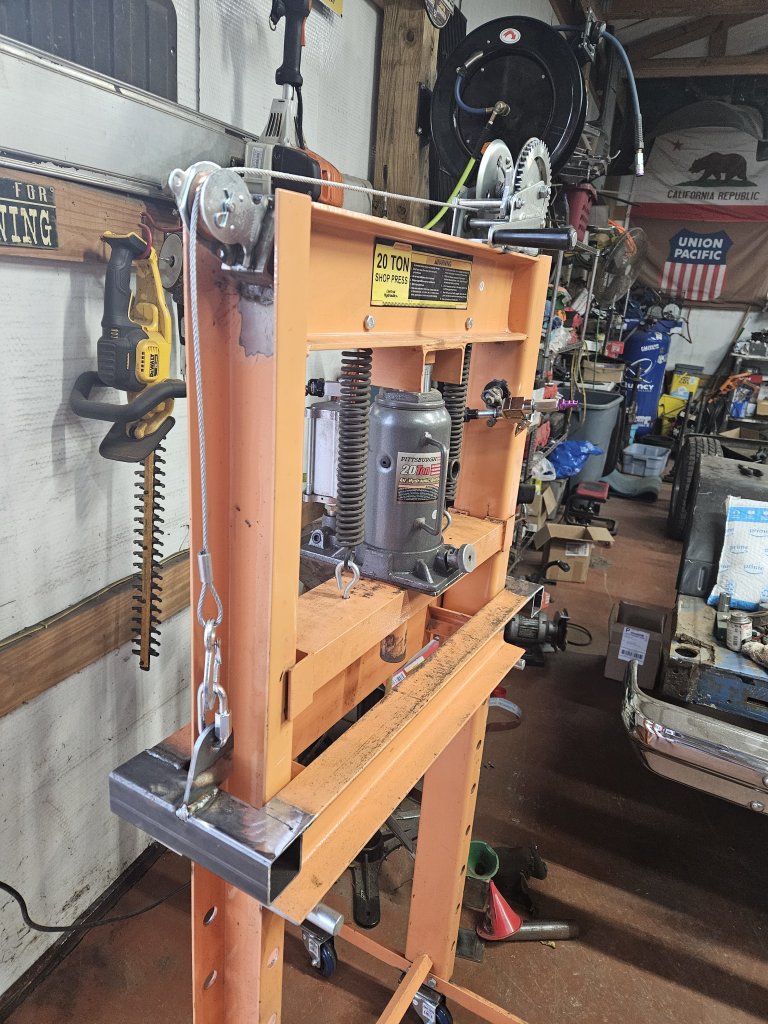

The one piece of equipment I didn't think I'd use much... was I wrong. It's a Hobo freight 20 ton press with a bunch of upgrades. It has paid for it's self 10 fold.
35,425
44,729
What kind of upgrades?
Marine Corps Moderator
11,410
14,246

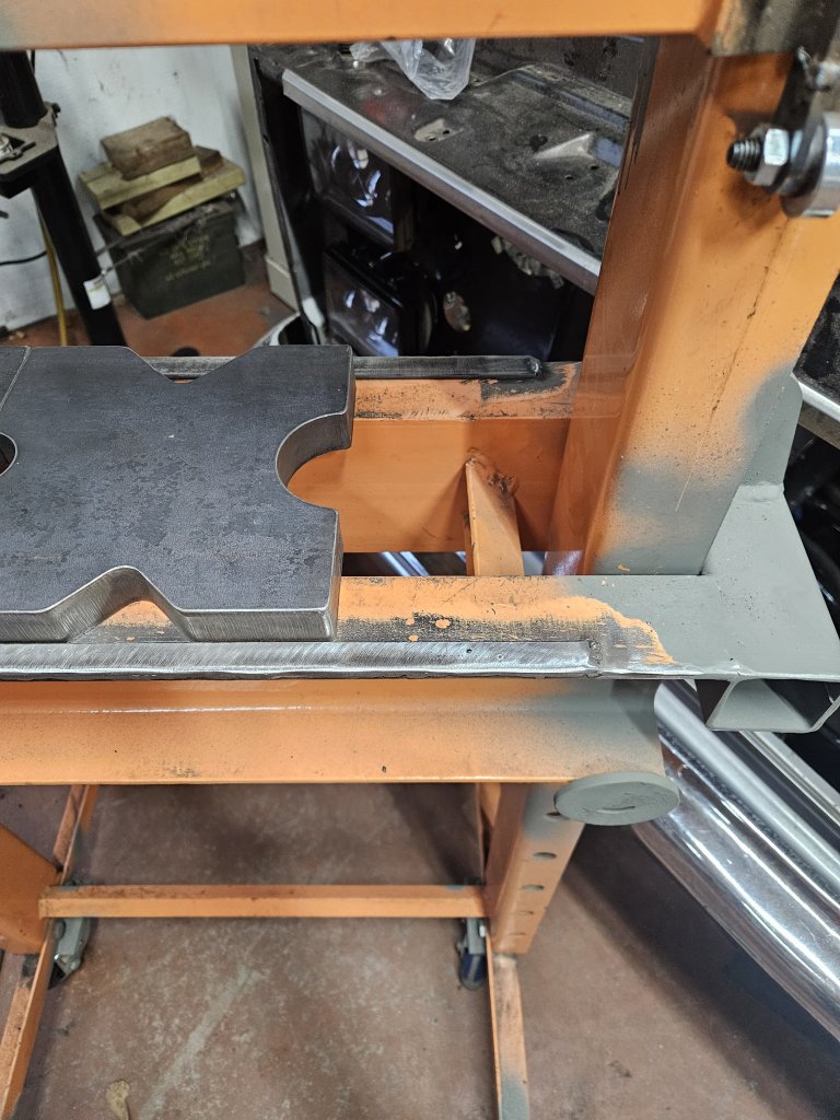

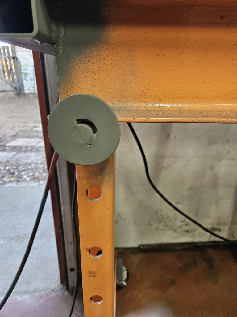

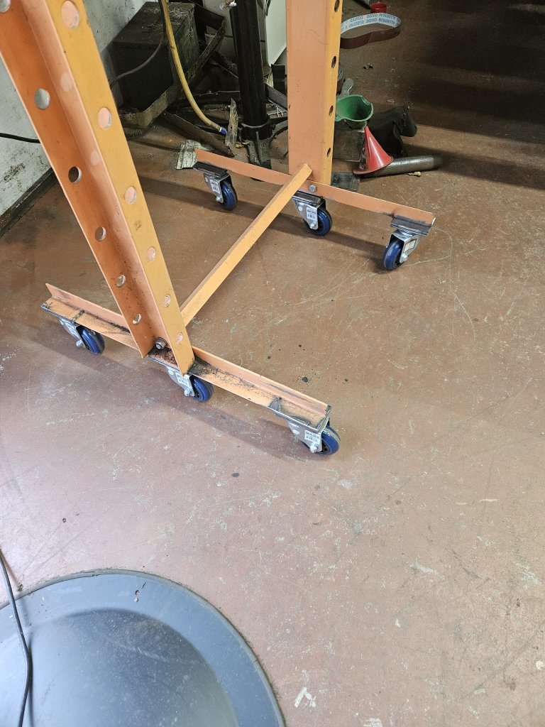

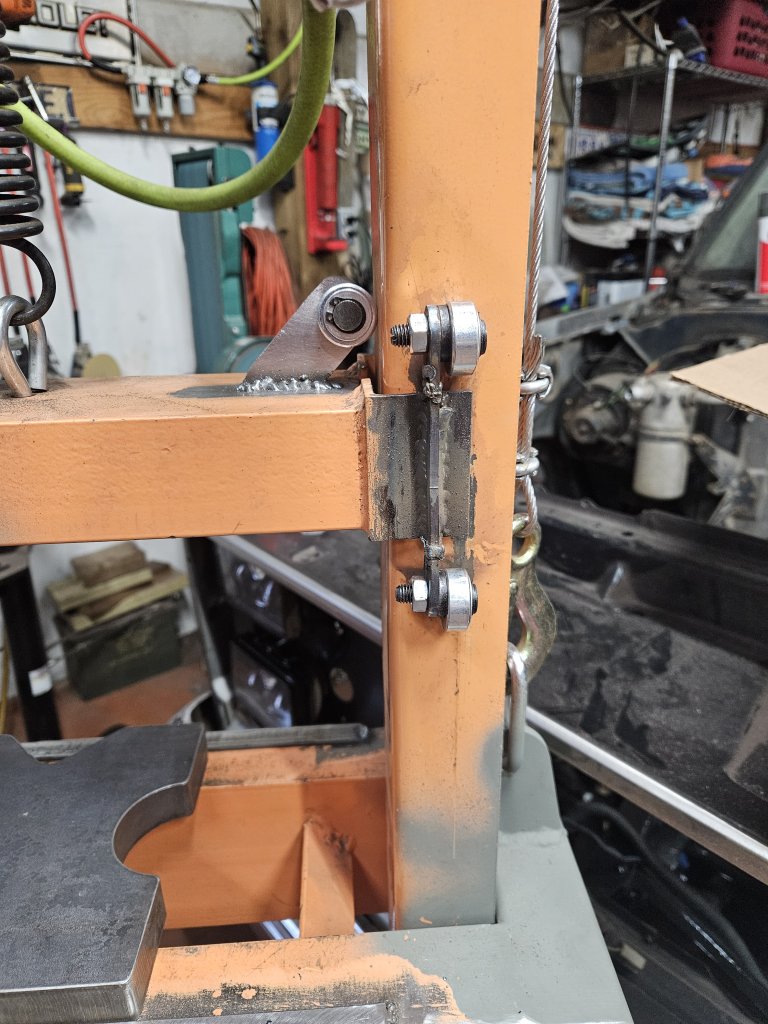

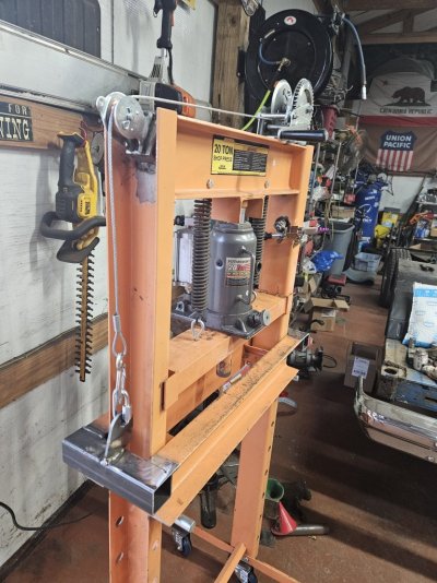

Pneumatic Jake, better press plates, put the deck on a roller system, put it on wheels to make it mobile. Put side bars on the deck to stop the side to side movement. Welded big washers on the deck hight bars. Welded angle iron at the bottom for storage of my press break. Put the deck on a pulley to raise and lower it. Stuff like that

Here are some pics
