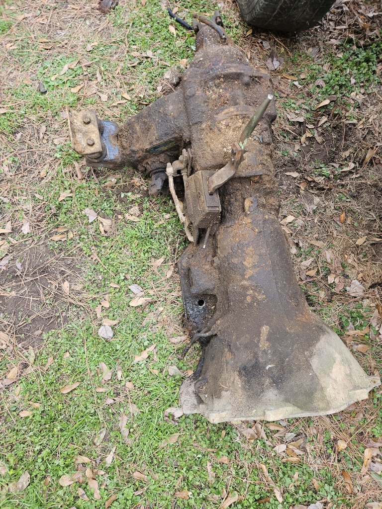

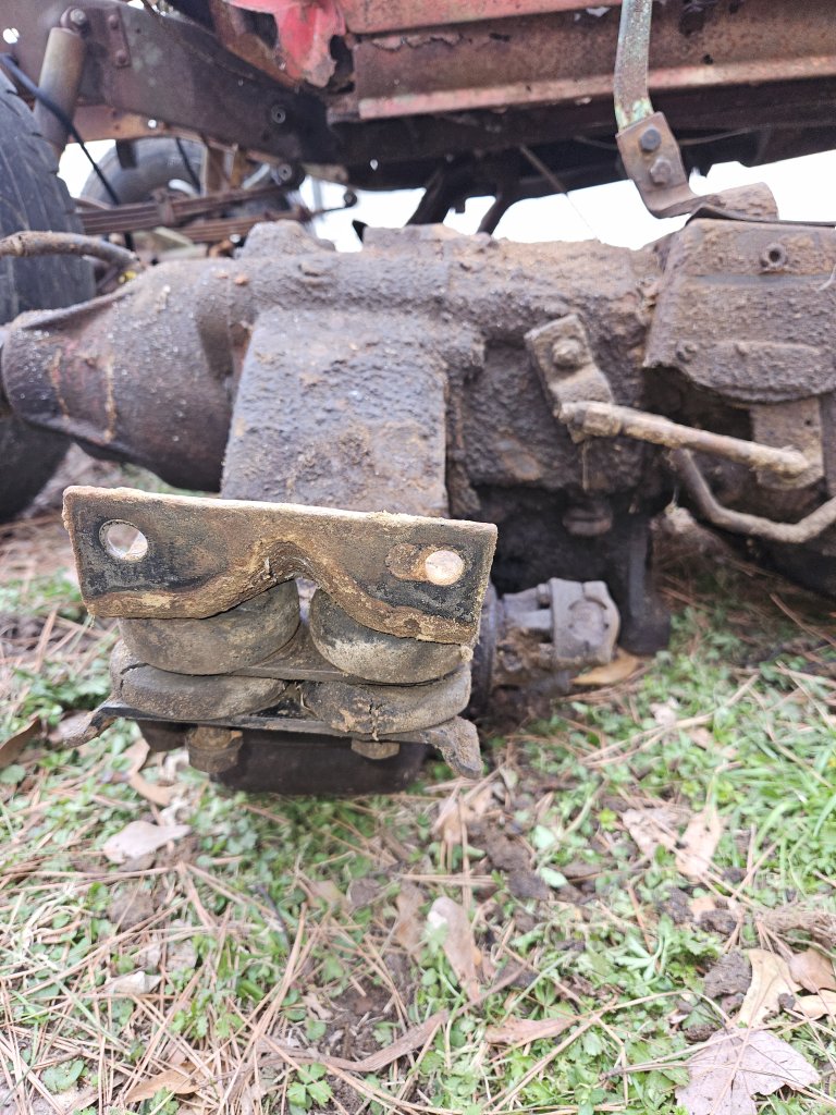

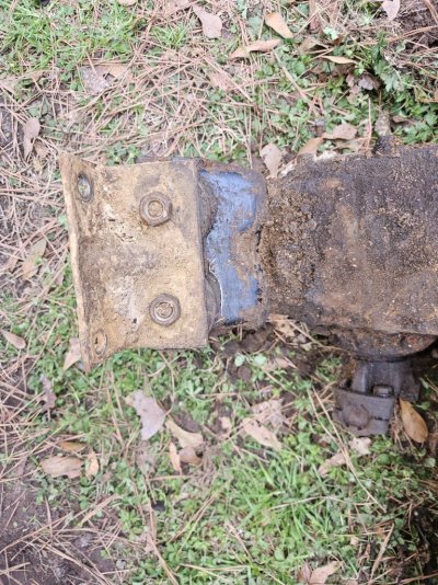

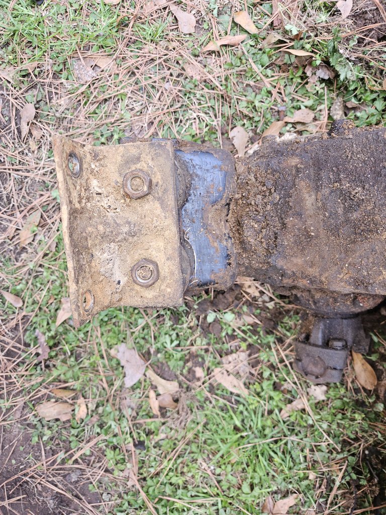

Ok... I got the transmission and transfer case pulled today out of the 73 Jimmy. I have never seen the transfer case bracket before...I think it kind cool, just have no clue on where to find the bushings for it...

Ok... I got the transmission and transfer case pulled today out of 5he 73 Jimmy. I have never seen the transfer case bracket before...I think it kind cool, just have no clue on where to find the bushings for it...
I heard that that actually is not good for the engine/ trans because of how it changes how the forces are spread on the drivetrain. I dont know how true that is but my 77 didn't have it. Wonder if GM changed it because of this issue.
I don't know, like i said I've never seen it. I have only seen the long bar brackets the attached to the transmission. If anyone has any info about them would be greatly appreciated.

My preference would be the late style bars and brackets their job is to keep the gap at the bottom of the bellousing from spreading and compressing,which breaks the bell housing. If you have too much support front and rear instead of bridging that gap. It does support things well but frame flex can still break things.
I didn't realize the very early 203's got that bracket too. I thought it was just the 205's.
I believe you are correct. It was determined that due to frame flex, that style support mount was actually responsible for breaking t-case adapters and it's use was discontinued by GM because of it.
Personally, I'd only use that style t-case support on a stone stock truck that is just driven occasionally and to shows.
I think I'm going to use it. Sandblast it and power coat it. It's not like I'm going to be using the Extracab on any trails. It's mainly going to be used on the highway, driving it, and driving to shows. That's why I'm still debating on a Automatic, or Stick. I was kind of bummed it was a 203, I was hoping for a 205. We'll see. Transfer case could be trash.
