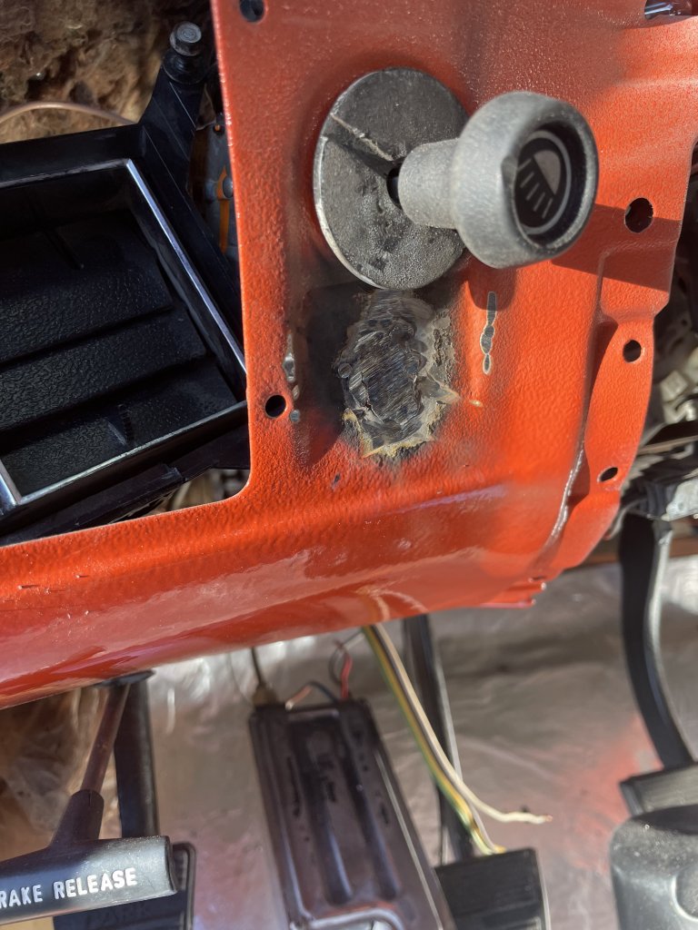

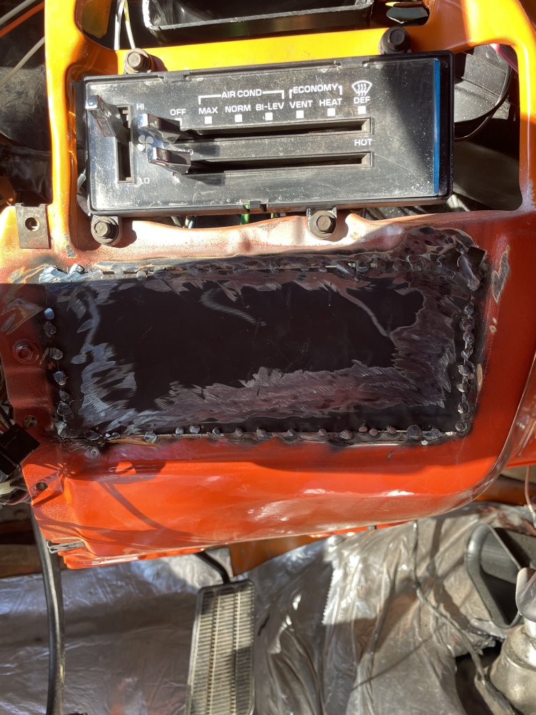

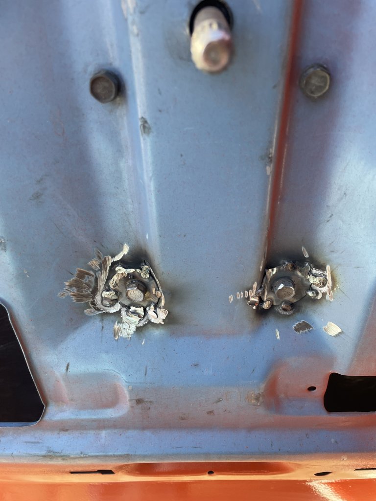

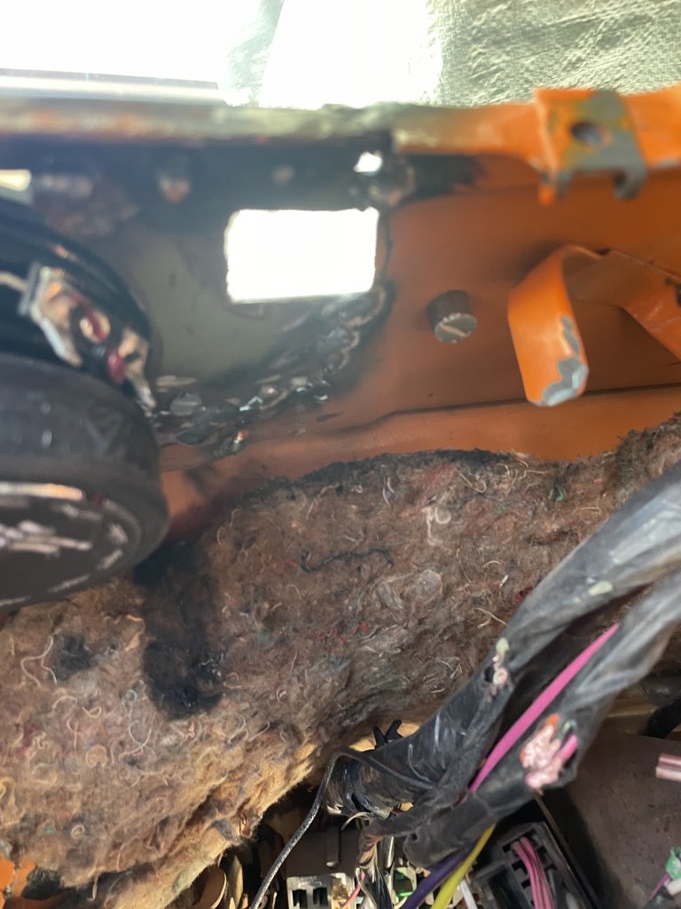

Nice day so I worked on some interior welding that’s needed.
