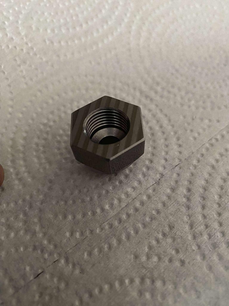

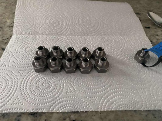

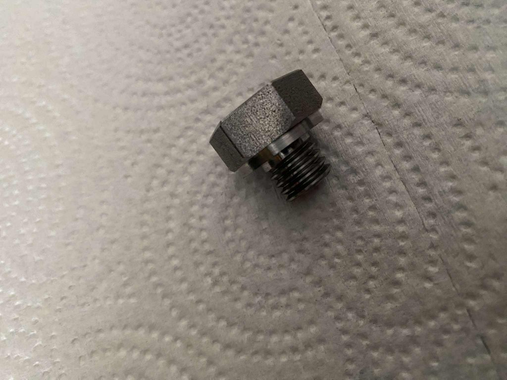

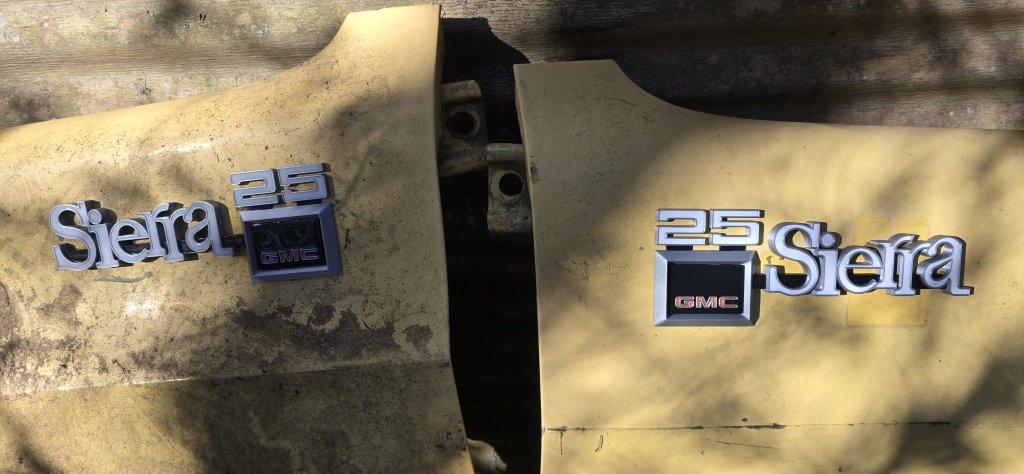

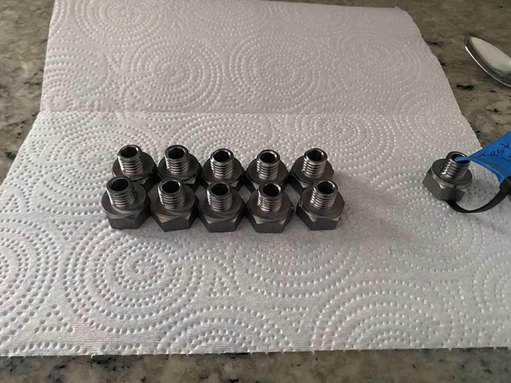

Designed these and then 3d printed them as a multi color print. I did uv resin on the left one (they're now side specific) and put them on my old fenders to see how they hold up being in the elements. They're attached with stainless studs and nuts as well. Then my buddy sent me pics of the 4wd indicator switch bushing. Hopefully I'll get them this week and I'll try them out. I'll have 9 to sell if it works like the 3d printed one did.

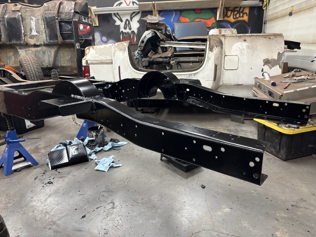

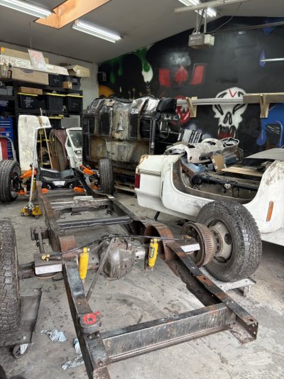

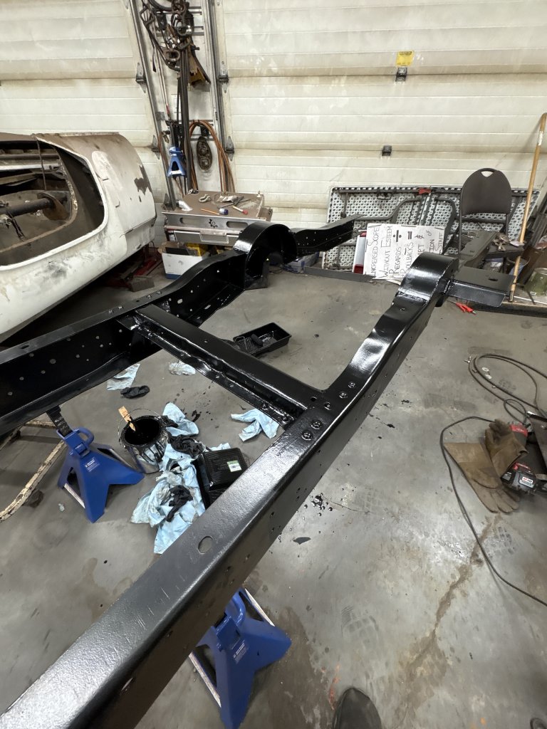

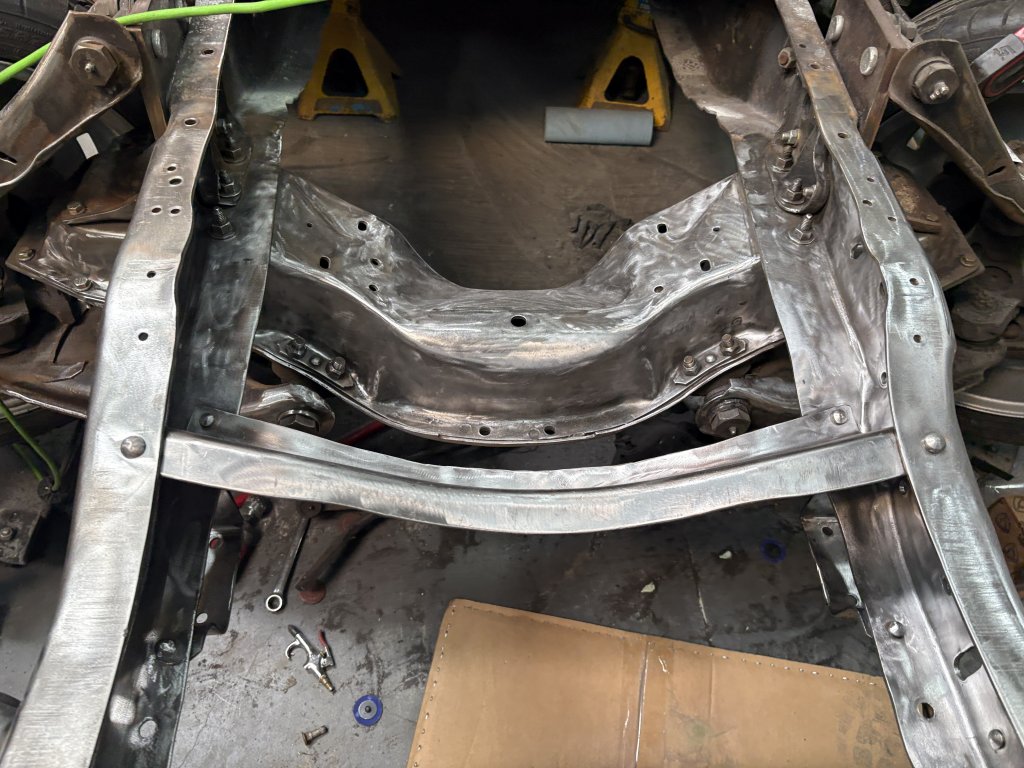

Frame is completely coated - feels good lol
