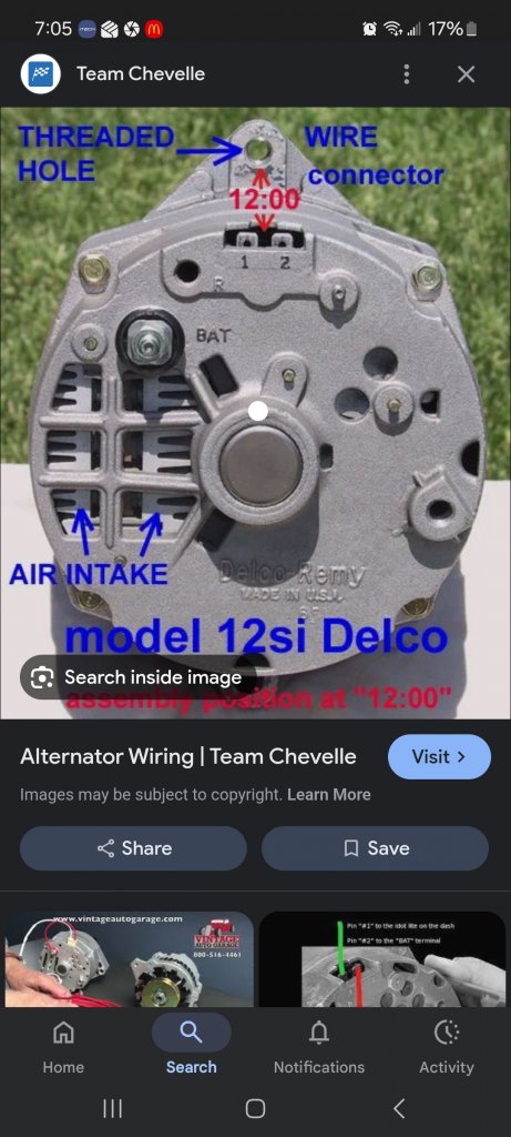

I hooked up a one way diode on the alt control wires to stop the backfeed.
I can leave the positive hooked up now.
Just curious, what were your symptoms that made you do the diode?
Backfeed into the dash, battery light would come on (truck not running so duh). That was the thing i noticed.
Post diode the light stays off when the truck is off.
Dash light on truck not running. If wired as a three wire. Either 1 and 2 terminal are flipped at the alternator or the alternator has a bad or missing diode. Now everyone for a cheap alternator upgrade just switch to a 94 amp 12si. It's plug and play,matter of fact it's the same casing that jegs is using on their 100 amp 1 wire. Delco 321-266 Ask for a 1984 Z28 with a 94 amp alternator should get you a bolt in 94 amp replacement. Heck the Squares may have even got 94 amp 12si some years never looked.On second the camaro application would be serpentine belt. The delco number would be V belt.

Dash light on truck not running. If wired as a three wire. Either 1 and 2 terminal are flipped at the alternator or the alternator has a bad or missing diode. Now everyone for a cheap alternator upgrade just switch to a 94 amp 12si. It's plug and play,matter of fact it's the same casing that legs is using on their 100 amp 1 wire. Delco 321-266 Ask for a 1984 Z28 with a 94 amp alternator should get you a bolt in 94 amp replacement. Heck the Squares may have even got 94 amp 12si some years never looked.On second the camaro application would be serpentine belt. The delco number would be V belt.
I'll try swapping the pinned wires around.
Just check them out, unplug them 1 should have 12v on it constantly. That goes to terminal 2 one should have power only when the key is on it goes to terminal 1.
