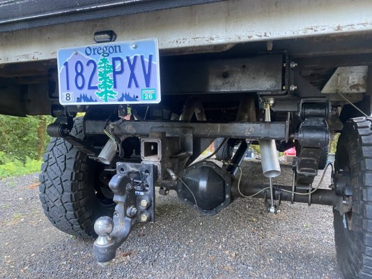

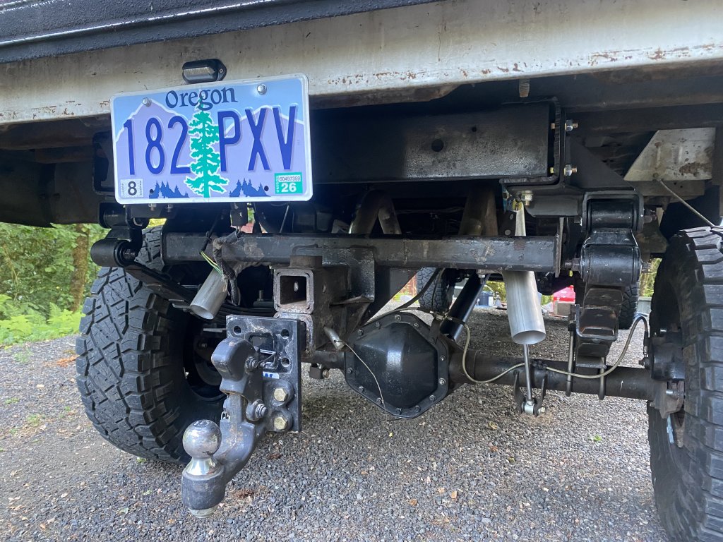

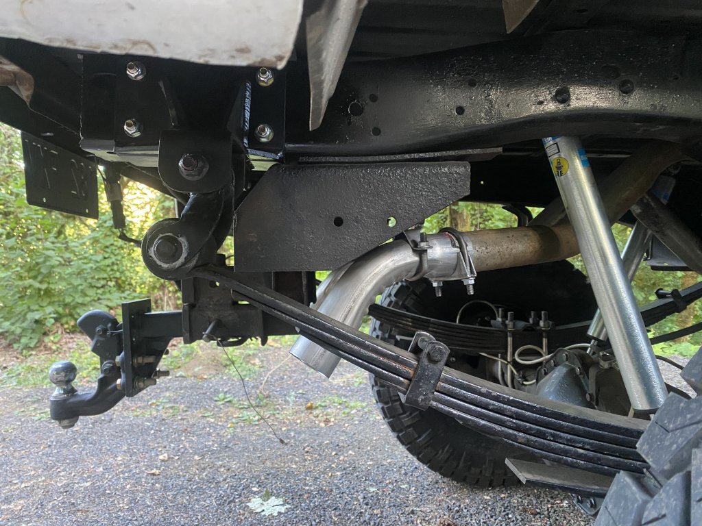

Added the ORD 2.5 shackle Flip and got rid of the blocks. Did new poly bushings aswell. Had to do some surgery on my exhaust to fit it after the shackle flip.

That's an interesting hitch setup. It looks really goofy, but you gain a lot of drop and it isn't hanging way out the back, killing your departure angle.

The frame was cut short by previous owner.. it's on my to do list to fix... but for now the hitch setup works

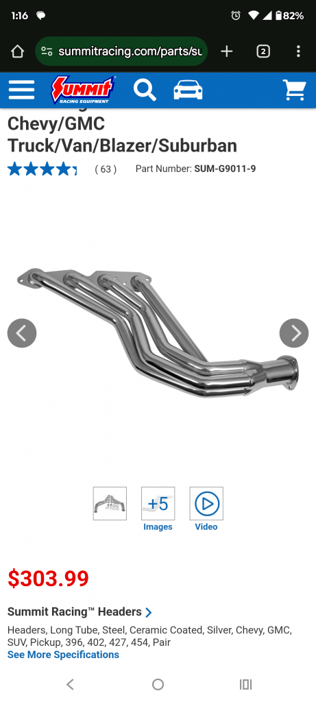

Has anyone run these (mine is a 83 454 1ton 4x4) I got a deal on a 3in exhaust and would like to consider these instead of using the stock manifold says they fit

If the same part number covers 2wd, my buddy has them on his '85 C30 and they fit great. He used Remflex gaskets. It's been 2 or 3 years now and they actually still look good and there's been no leaks.

Cool I grabbed a set will see how they fit up

That’s great to hear. I’ve been eyeing them up for the 86. Not sure how many more holes I can weld up on a pop can….
