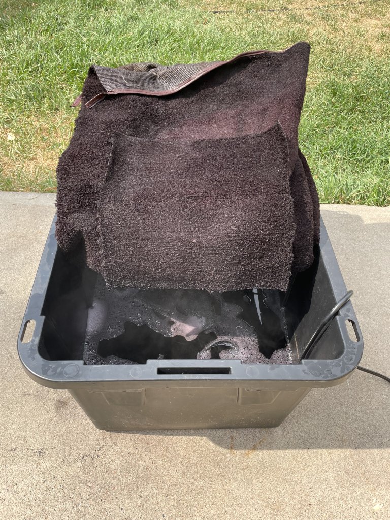

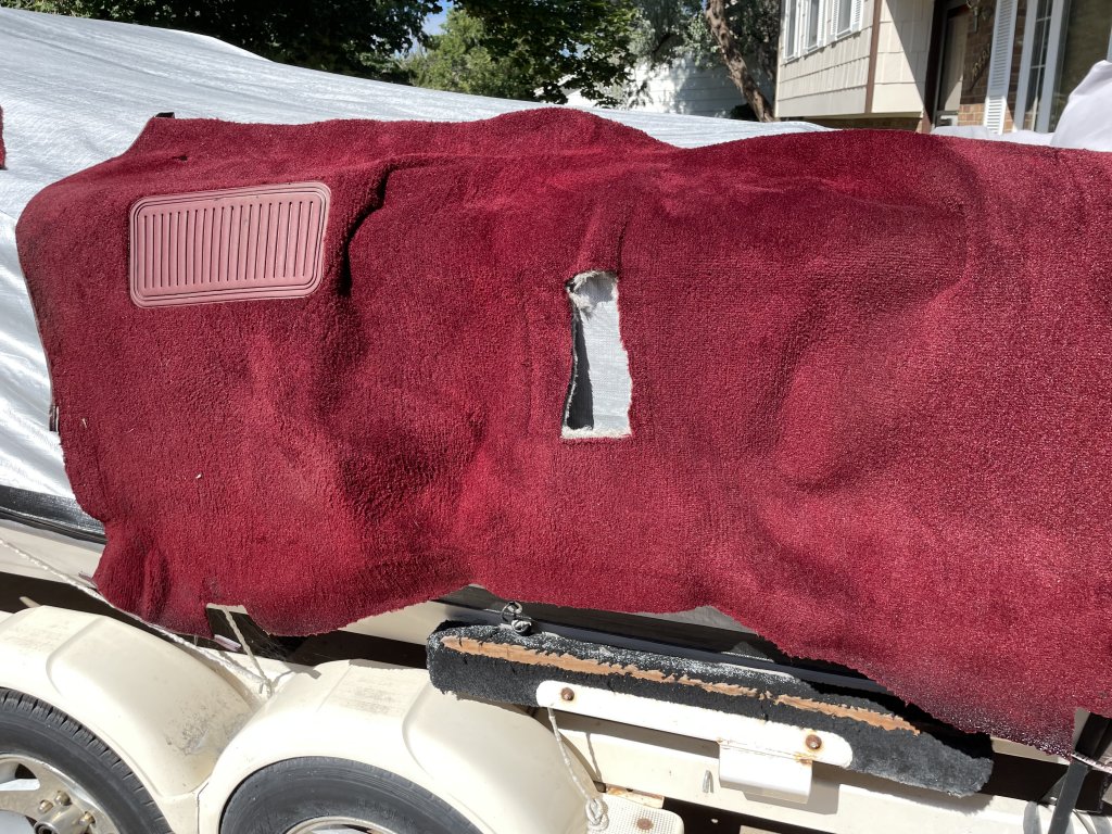

Before and after pics, actually looks brown after using black dye. I’m gonna let it dry out to see what if it changes color more. Next, I think I will add some faded blue jeans.

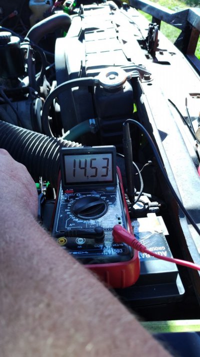

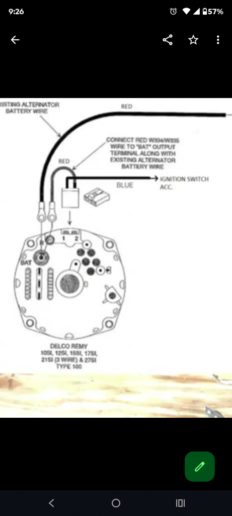

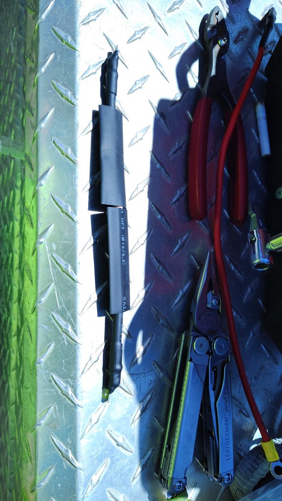

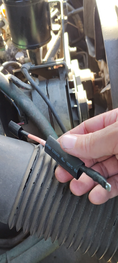

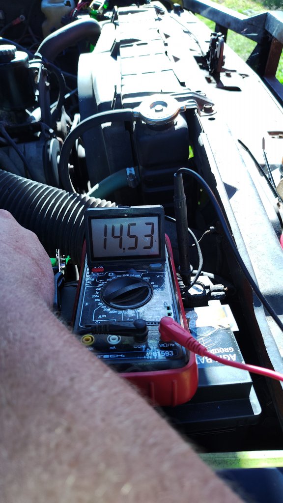

Been awhile busy working on non square body stuff but recently added a half ton crane with winch and tracked down matching tool box for the passenger side couple days ago hopped in the truck to go pick up a few 6.2 ls3 blocks and noticed alternator wasn't charging no power to pin 2.on the connector used my power probe to give it 12v and started to charge so picked up some fusable links(pretty sure that's the problem

Did what gm should have done and put the fusable link for the alternator to the battery used a few spade connectors and put some extra heat shrink to seal everything now it will be easy to swap if it ever has a issue again

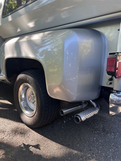

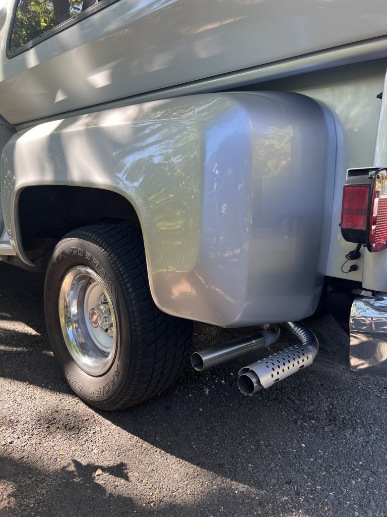

Finally have the new tailpipes installed today! Bought them pre-bent, one from Amazon and the other from Cardid. Painted the OE heat shield Ardent Silver assuming that is how they came from the factory. Very happy indeed.
I’ve never seen an OE heat shield on these trucks tailpipes. Looks cool!
