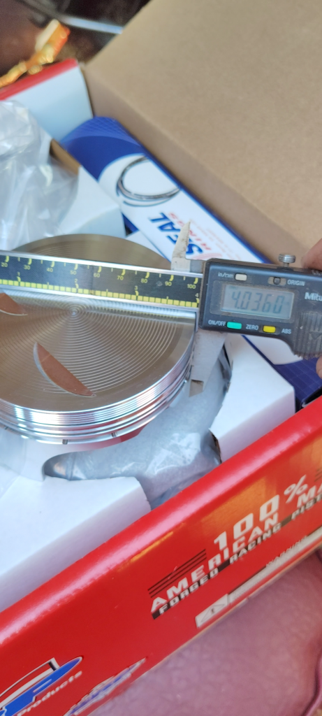

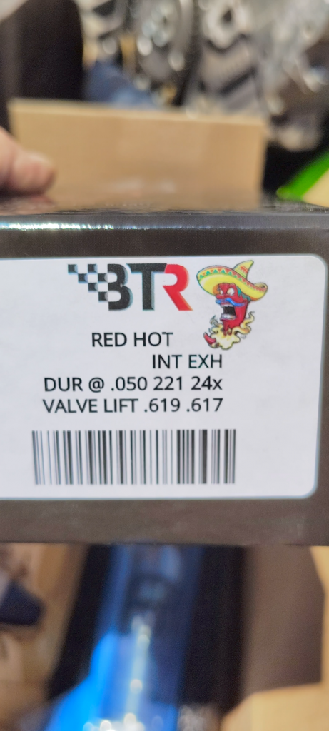

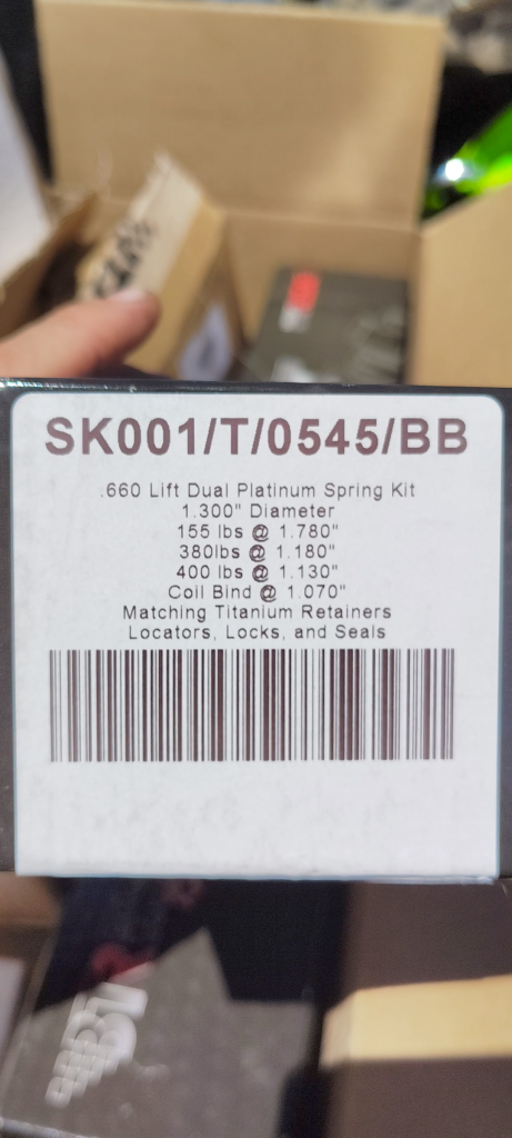

Used the crane and cleaned up the LS3 Texas speed pistons rods and crank BTR cam and springs ls7 lifters taking the block and heads to the machine shop today
Thats a healthy cam choice for a truck.:cool:

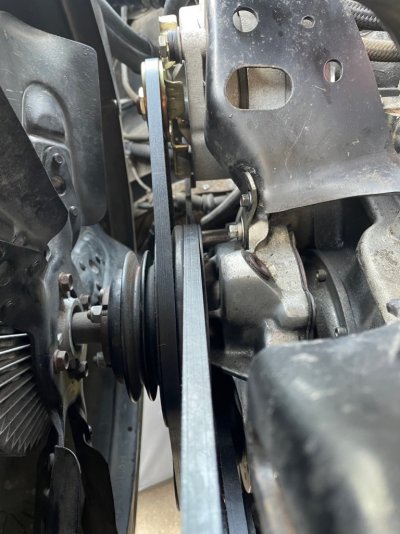

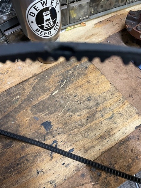

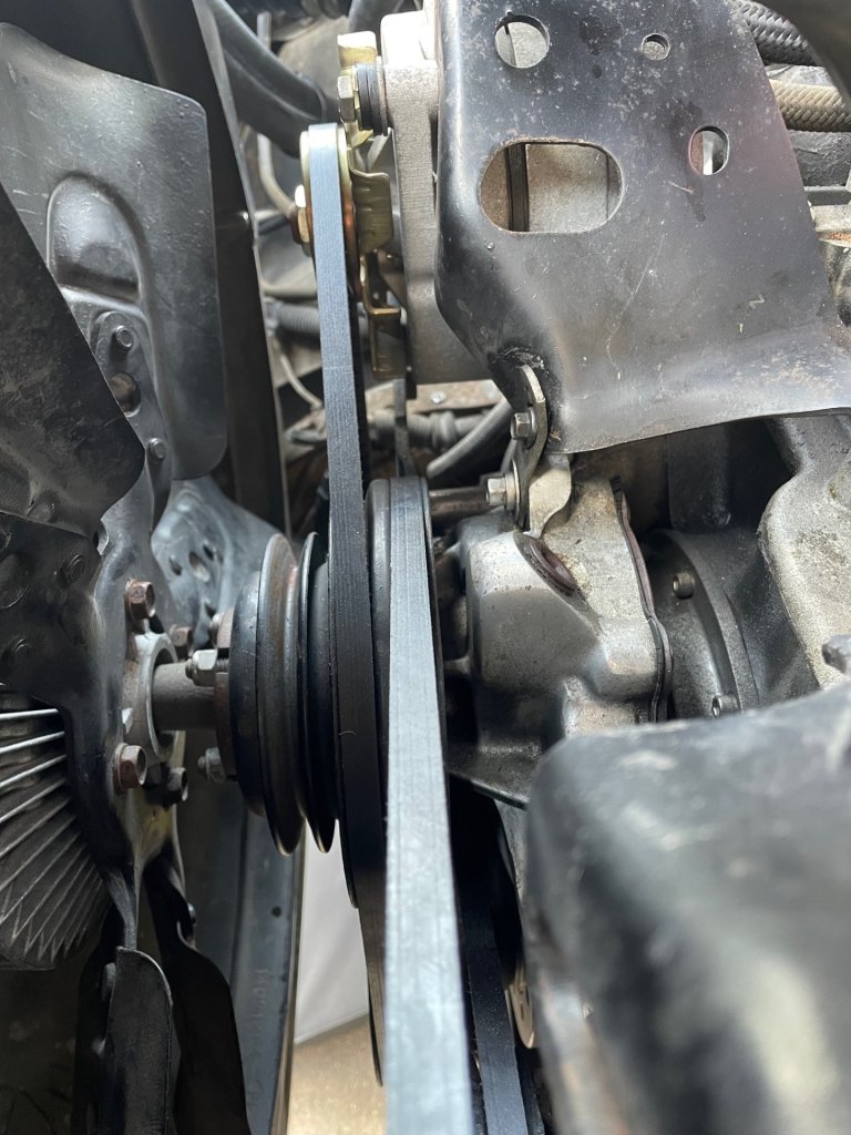

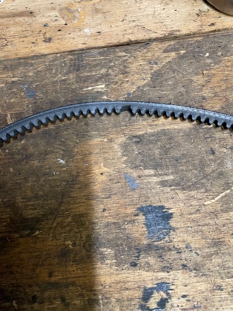

I fixed my squealing belt this past weekend. While I was at it, I changed all 3. The Gates belts cost over 100-dollar bill. I would like to come up with another Alt. bracket. This is not the best set up. Any ideas? The bracket doesn't play nice with the Vortech heads and , intake.

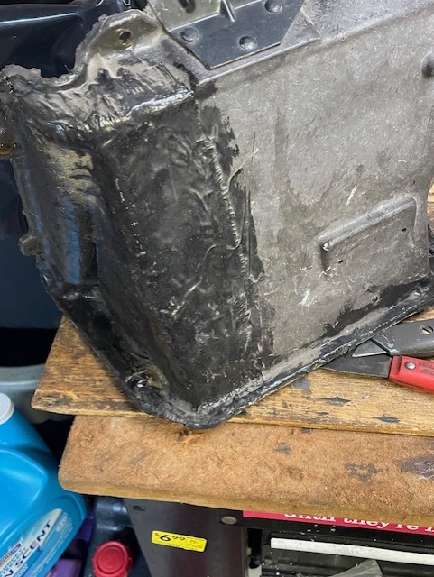

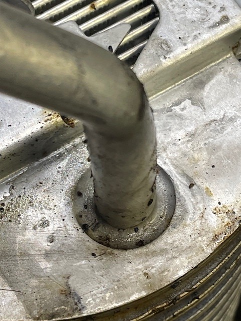

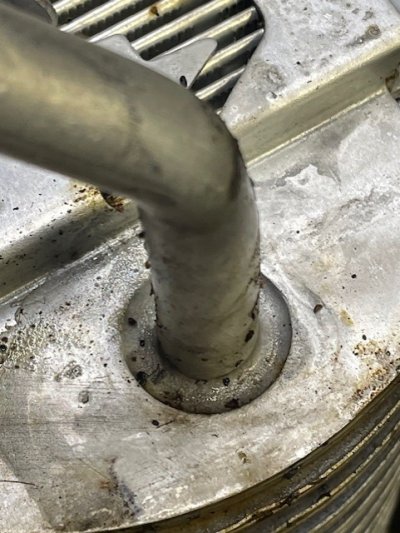

Replaced the EVAP again! The last one only lasted about 18 months or so. They don't fit just correctly, and the high-pressure tube has to be tweaked a bit. I also noticed that the water heater hose was rubbing on the tubing. It might have vibrated it enough to cause it to fail. I located the hose away from the tubing. The tubing still just floats in the air. The stock one ran along the frame and was clamped to it. The correct parts for these trucks are becoming more difficult to find. The generic one size fits all sucks. On the bright side my repaired cover looks good. I would like to see a company make one out of plastic.
Mine is the Alan Grove mid mount. Uses 2 bosses on the water pump and 1 bolt to the cylinder head.
When I worked at a a/c shop we used some rubber or foam to protect and seal in the evaps and condensers too be surprised how much better it works being sealed up most makes got some foam or rubber plastic from factory (it will also protect it from rubbing and yes the aftermarket a/c parts suck) for the evap seal up top and sides only if you seal the bottom condensed water will build up and water in there will effect the cooling performance
Thanks. I did add some foam that came with the packaging to keep the EVAP from moving around as much in the housing. I sealed the housing to the fire wall with Flex seal rubber caulking, as well as the 2 halves. I put foam pipe wrap in the top hole around the tubing.
