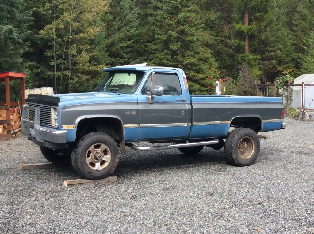

finally getting back to work on my 87 GMC. got the rough idle fixed after a slew of sensor replacements. replaced the stock vacuum booster and another new master cylinder. waiting on steel brake lines for the rear and I have new rubber hose for brakes to fit the lift.with any luck i will finally get to put some miles on it soon!!
