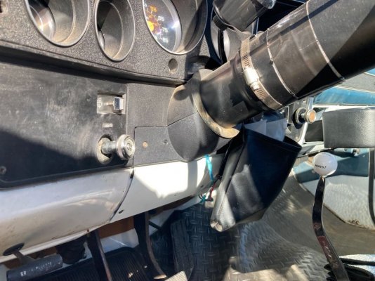

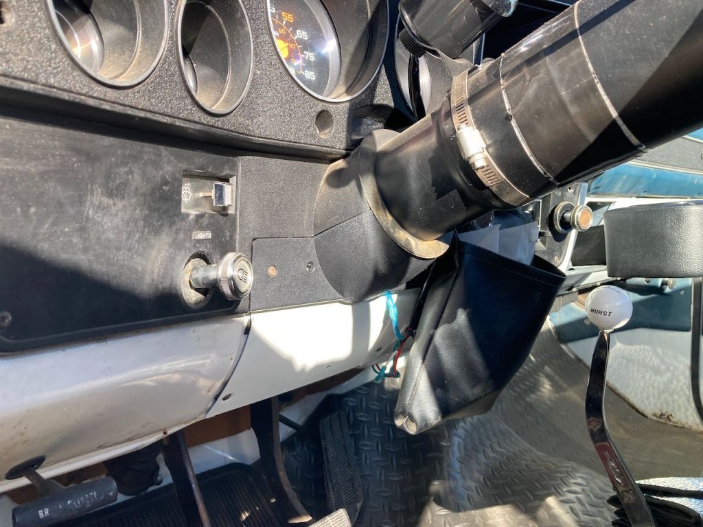

More dumb little things- The white metal cover and black trim under the steering column . Better huh...

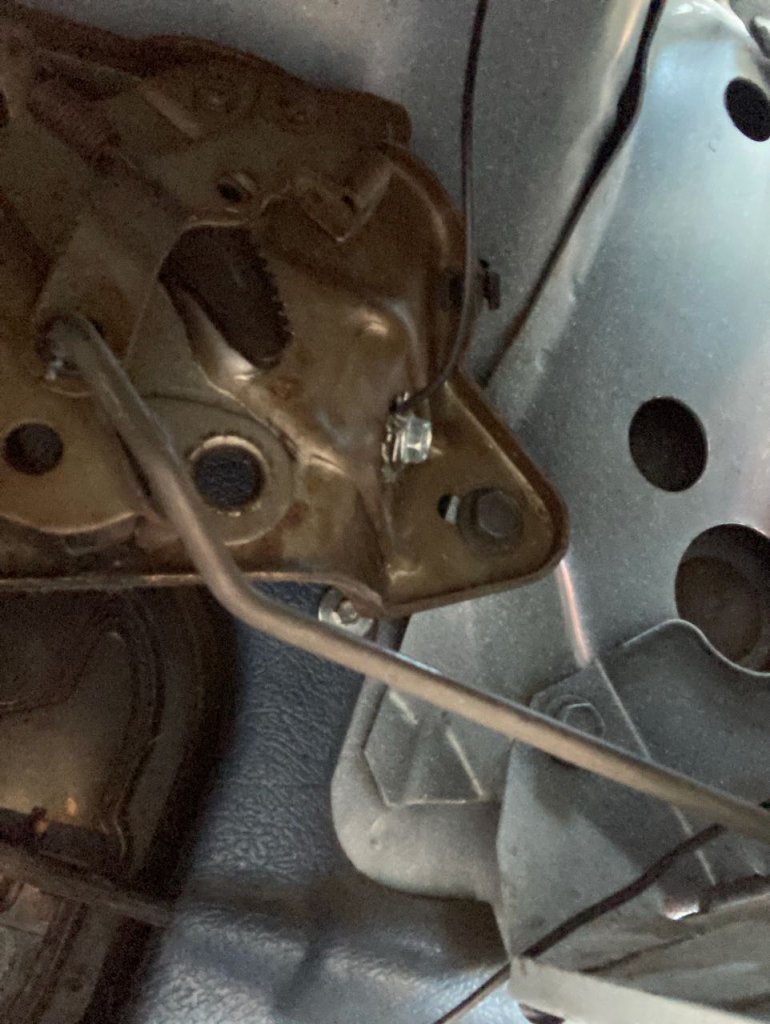

Found the rattle! After quieting the cab with dynamat, sealing the vent window with a new latch kit, I still had this big rattle in the parking brake mechanism. Looked and looked, and finally found the parking brake ratchet mechanism was loose. Three bolts total, 2 that go to the firewall, and one more, that goes to the dash structure. The third to the dash was way loose. Tightened it up and my 42 year old truck now goes down the road like a new truck, quiet speaking. It was the bolt shown in the below picture, about in the center, that goes into the white metal. That arm in front of it is the brake release arm.
Glad you found the rattle. Rattles are annoying. Some we live with because they can't be fixed, but stuff like that, when fixed, makes a world of difference.
