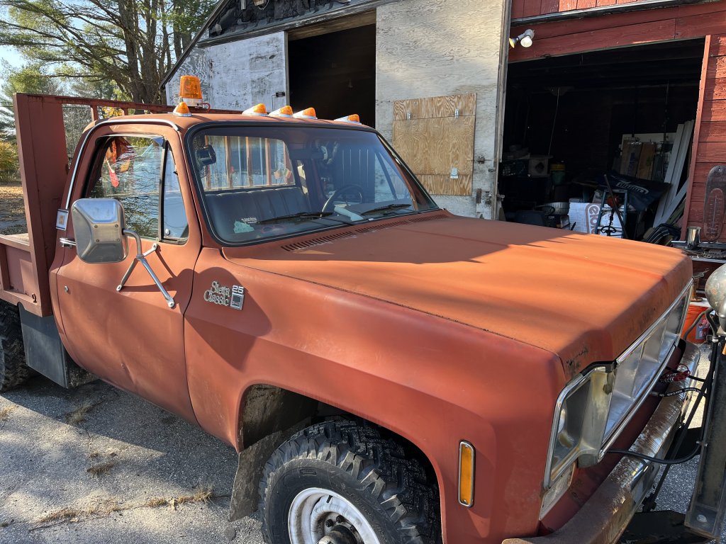

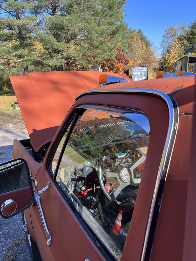

Fixed the wiring to tail lights on the bed. Also installed these window vent shades that I’d never install on a nice truck because of drilling holes in the door. But on this old blister with aftermarket doors, I had no regrets. Think it looks the part with them on for sure.
Ben
Ben
Those same ones came on my 78 when i bought it. I love them!
