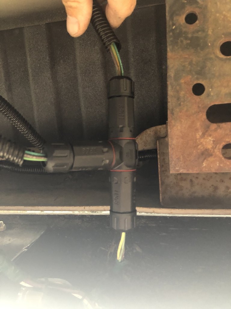

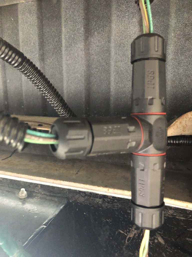

If anyone runs into a situation where you need a 3 way multiple pin connection,I wholeheartedly recommend this product.Was kinda unsure how to proceed on my taillight supply,taillight harness,to trailer plug,then I found this…..
The only thing was no directions was included,so multimeter was utilized.No directions,but well made.

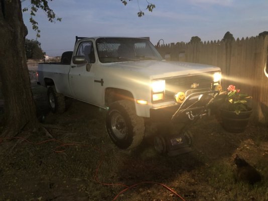

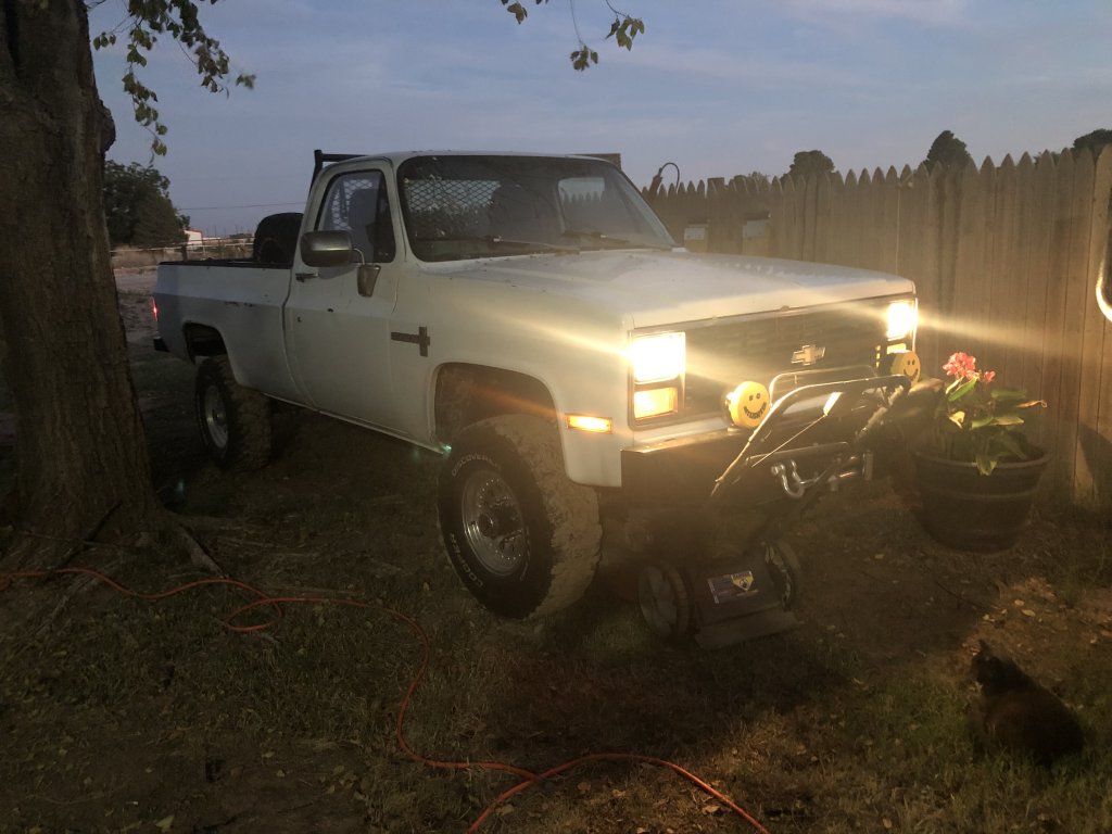

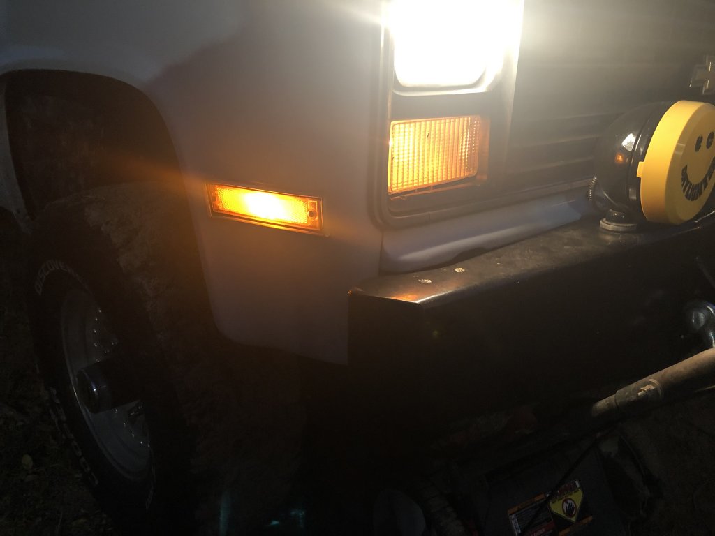

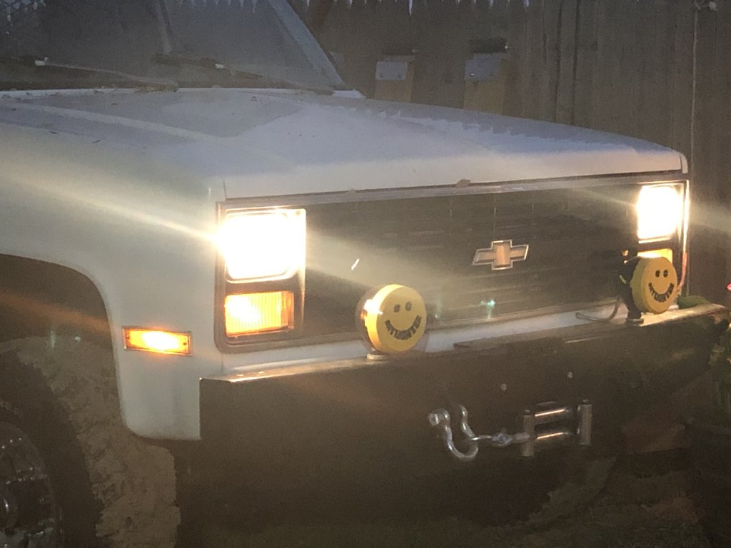

Also,if you guys are suffering from not so bright lights,the painless heavyduty headlight harness is the ticket.Power supply to headlights comes directly off the battery,not the light switch.Now the switch just activates relays.(I’m sure 38 year wiring wasn’t helpful either)
Low Beams
Is it a plug and play or do i have to wire it in? Im NOT good with electricity!
It’s pretty simple. All plug n play except you need to make a good fused connection to the battery somehow.
Haven’t installed mine yet. Bought it thinking easier to do with truck torn apart but it’s not. It’s really simple and a little thought into routing the wires.
