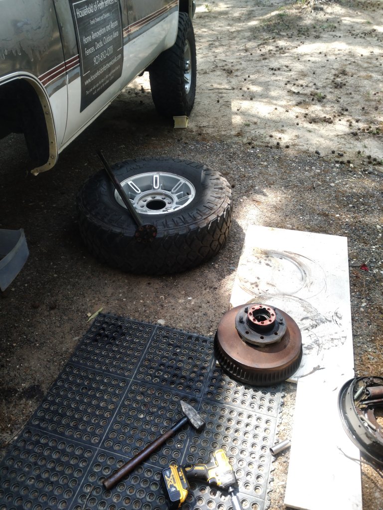

Disc brake conversion in progress..driver side is done and breaking for dinner. UPS is running behind on my new Skyjacker leaf springs for the rear and planned on doing them the same time but oh well, first world problems lol

That looks really nize! From where did you get your kit?
Thank you sir! Lugnut4x4.com great folks to deal with. I was gonna acquire all the parts separately and source from other trucks but for $350 shipped to my door the price was good. In the kit came: conversion brackets, rotors, calipers, pads, axle seals, brake hoses, and hardware.
9,429
17,285
Nice work! I was planning that with basically any truck I bought if the rear brakes were questionable. $350 isn't any more $ than it would cost to completely re-do a set of drum brakes on a HD truck, including new drums.
Was fortunate enough that the truck I bought had/has all new brake parts at all 4 wheels including brand spankin new drums, so I'll be packing that extra weight for some time to come I imagine!
(Now if the PO that did the lift and/or the brakes on mine hadn't cheaped out and not gotten extended brake hoses, I wouldn't have to doo that...
I know it..started adding up new drums, shoe kit, cylinders, seals and quickly got to $300. If the seals hadn't of done the damage they did I would have rebuilt the drums but jumped on the opportunity to convert, was an easy process too.

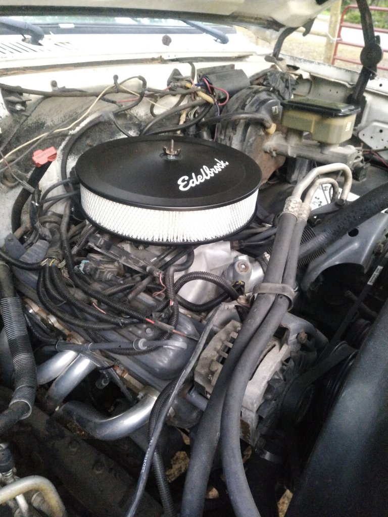

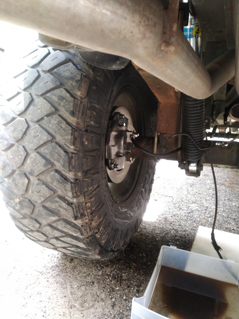

Bled the brakes today and put some new hard brake lines in the rear with the new disk conversion. Cracked open the front diff and changed the fluid out. Bolted on an Eddy air intake and filter, engine bay is a lot cleaner looking with it.
