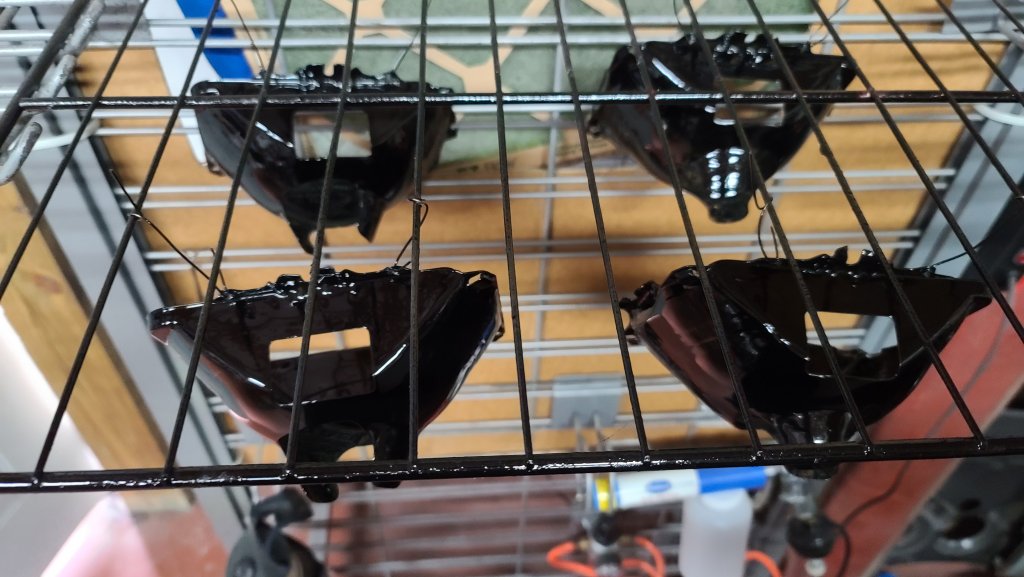

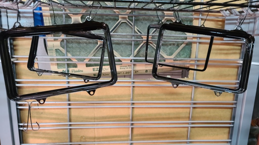

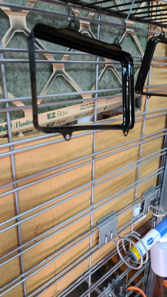

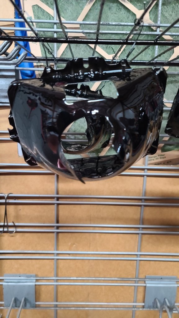

Got my headlight buckets sand blasted and powder coated today.

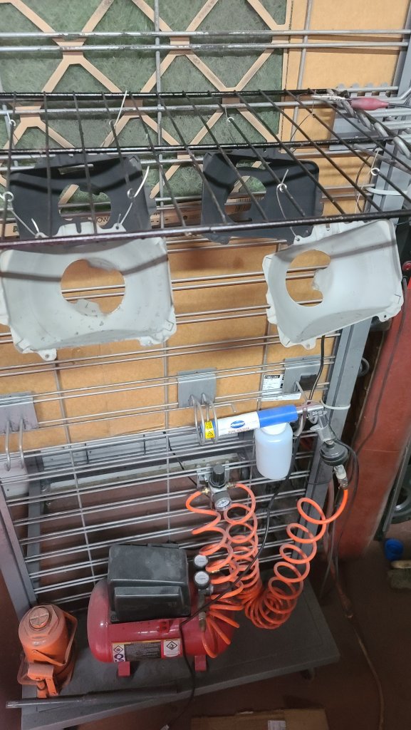

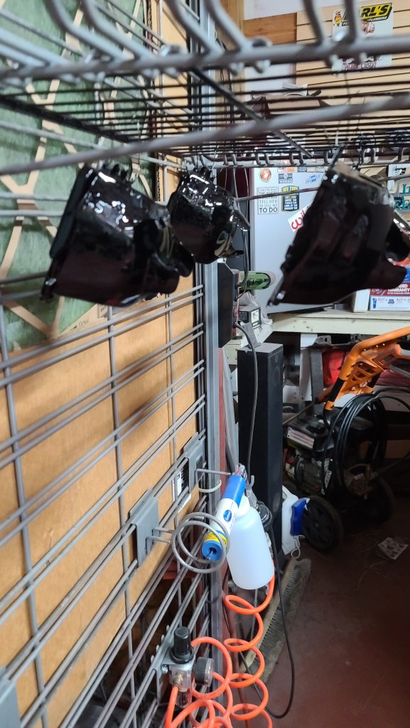

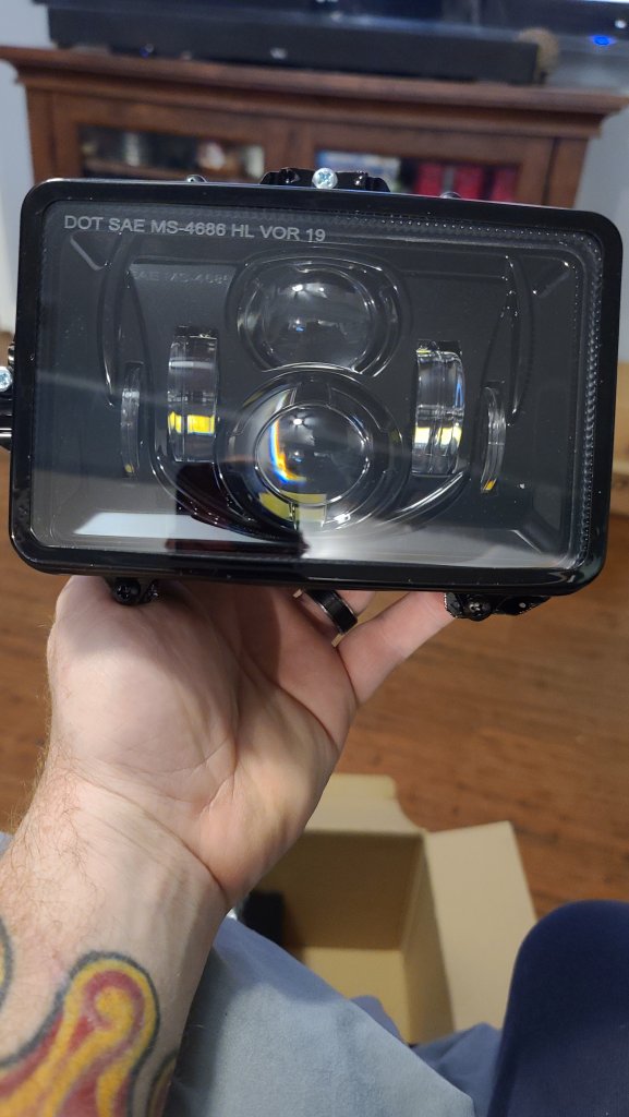

Well I tried to polish out the headlight trim rings. After about 45 minutes of polishing, they didn't look much better. So I sandblasted them down, and powder coated them. Going to run up to the hardware store and get some new screws, and put my LED headlights that I got for my birthday together...
Well hell put this in the wrong thread. Can one of you peoples that can move stuff put it in the "What have you done to your square lately"
