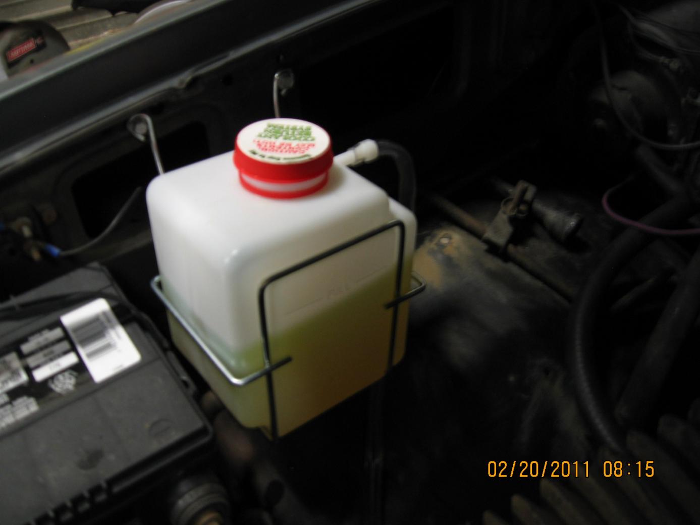

Fill her up about 3/4 full with proper antifreeze mixture. I usually leave the radiator cap off and let the motor run, it will start sucking up fuid fast so you have to keep adding fluid as it fills the motor. Have at least 2 gallons on standby and ready to pour.
Eventually the motor starts to heat up and the fludi level begins to stabilize. Again, I keep it a 3/4 full. Eventually the antifreeze begins to expand and will start rising up to the cap opening. Once it starts to spill out I throw the cap on and tighen it and let the engine reach operating temperature and run for about 15 minuts after that to cycle out any air trapped in the motor.
Then I shut the motor down to let it cool and keep a watch on the overflow tank and keep it filled with fluid as the engine cools and draws in fluid from the overflow tank. This can take up to a half hour, and if you put your ear by the radiator cap you can hear the fluid getting sucked into the radiator from the tank.
Once this is done she's good to go, check for any leaks and fill overflow tank to the proper level. :High 5:
