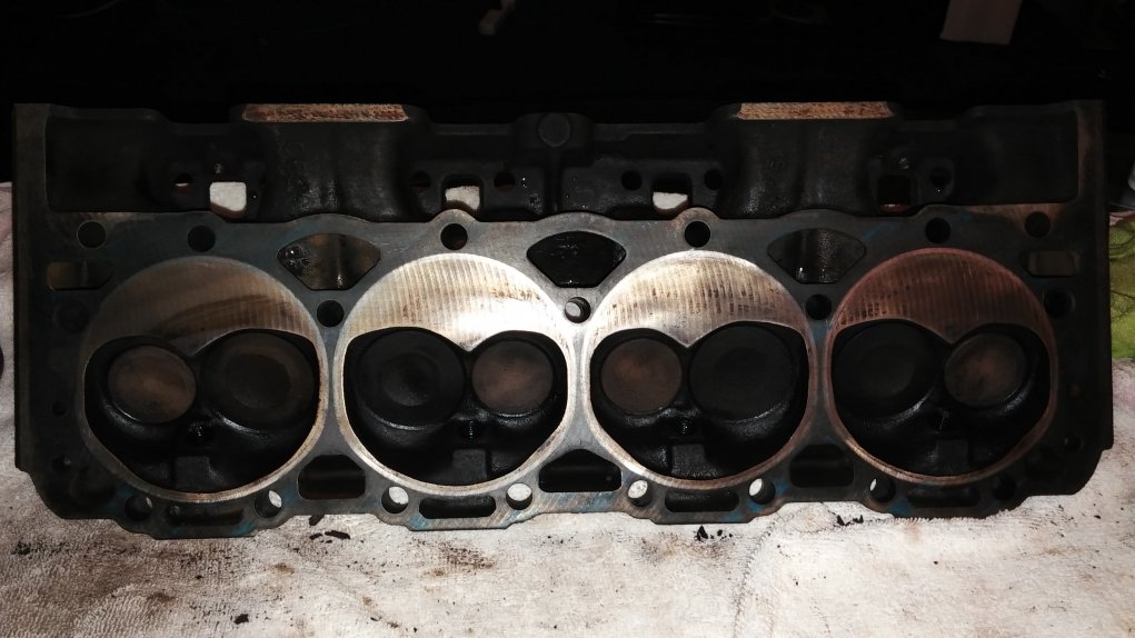

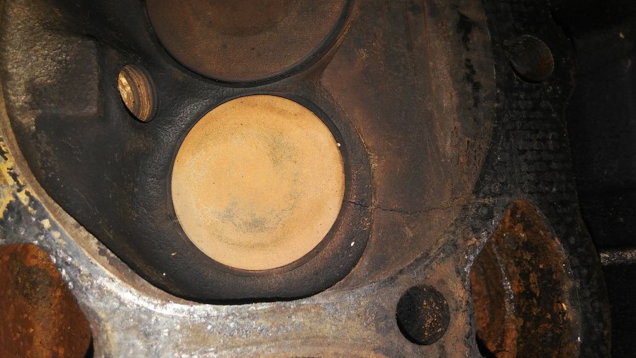

So I'm building a budget 355 and was given a set of vortec 062 heads. Thought life was grand, well one head had a huge crack in it. Then was given another head, looked it over, thought no cracks, but turns out I missed one in the center head bolt area. Wtf....
Still have one more chance at my buds shop too get the last one he has off and check it, so I'm in need of one if this last one doesn't work out. Anyone have one laying around they don't intend to use, Crosses fingers...lol first pic, bad crack, second pic find the crack! Lll

Cracks are very common in used Vortec heads. I had a pair off a running engine with iny hairline cracks that turned up when magnafluxing. Might have been OK, but didn't want to chance it.
I ended up buying a new pair from Jegs for around $310 each including freight. Gotta tell you they may seem like a good bang for the buck, but the intake manifold, valve covers & bolts, and expensive gaskets can drive up the price. And valve lift can't be over .460" or so without aftermarket springs, retainers, and locks.
Also, be sure to look at the exhaust ports. If they are offset above the bolt hole centerline, make sure your gaskets and exhaust manifolds/headers don't block the tops of the ports. From what I can tell, the ports on the OE castings were centered on the bolt holes; but on the GM aftermarket castings, the ports are raised, as you can see here:
I can shoot you the P/Ns of a couple gaskets that will work, but it's critical that you check the exhaust manifold or headers, because exhaust gas flow is the most intense at the top of the port.

Only reason I'm wanting to use the vortecs is that they're free, and I can get a free valve job on them and I get a decent discount on gaskets and such from my part time job. I found a local ish place that does machining and they said to bring my cracked head in for them to look at, they're pretty sure they can fix it, worth a shot for $65 bucks in my opinion. Unless I can't fix it or find a good head then I'll have to look at different routes. Only wanting around 400 HP and 400 tq, which these heads with minor work and a cam should be just fine for that.
