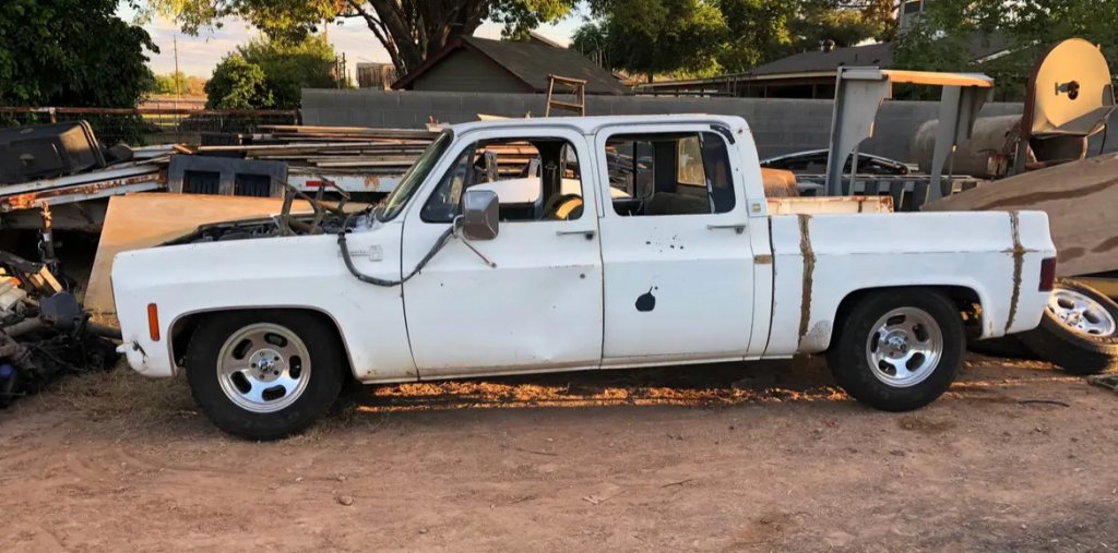

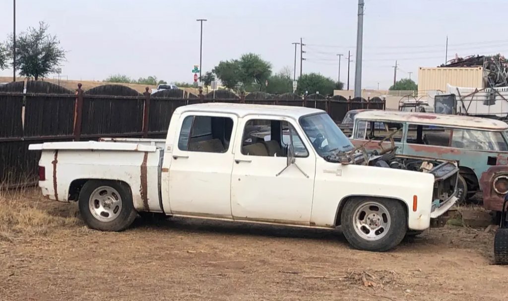

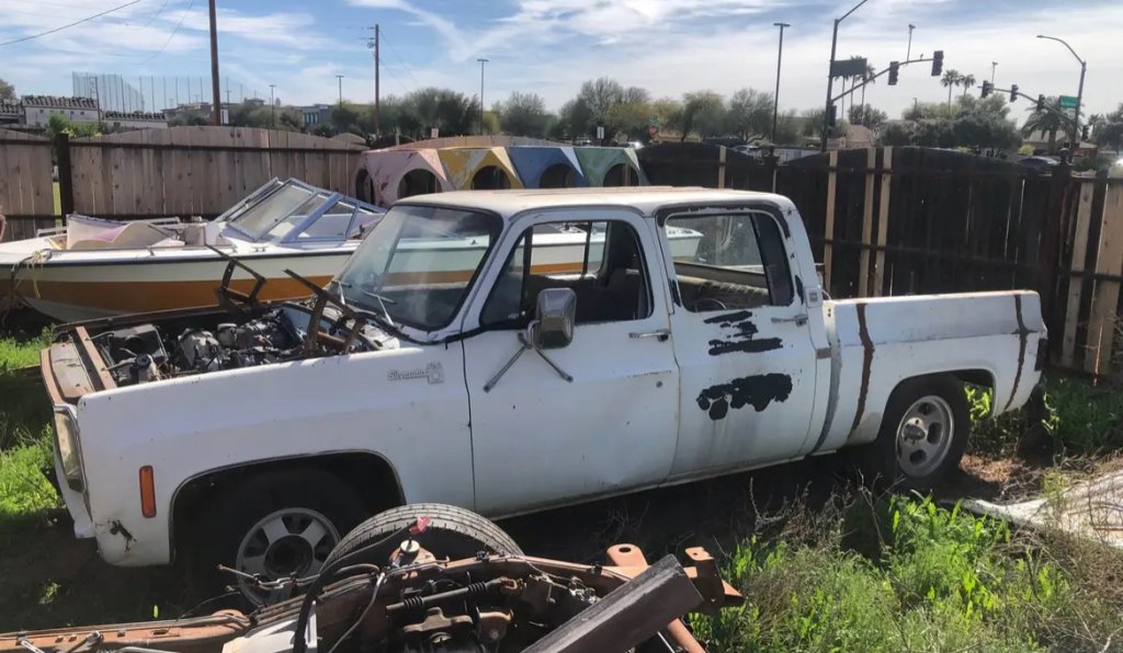

Here is a CC cab on reg cab long bed frame, cut down 5’ bed
Definitely an interesting look! That short of a bed would be a no go for me since I have to haul the occasional bale or two of hay (750lb bales) but nice to know it works! I saw one on one of the Facebook groups that was a lifted version and it looked pretty slick! If I was doing some sort of off-road toy then the bed space wouldn't be an issue, but since it'll be my daily replacement once my current daily dies, it'll need to be more functional. Thank you for the reference though!

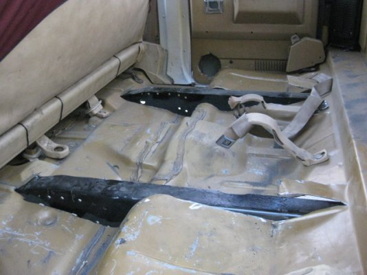

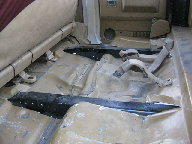

Late to the party here -
This can be done if you're not afraid to chop & channel the rear floor, and grind the rivets to relocate the rear body mount crossmember further back for the crew cab.
32,182
33,681
Is that with no body lift?
32,182
33,681
Correct. No body lift.
And this is on a 135.5" C&C frame, not the 159.5".
I asked because it required more cab notching than I remembered. I think the stuff I saw in the past, they were running a body lift so the footwell was still more useful.
