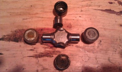

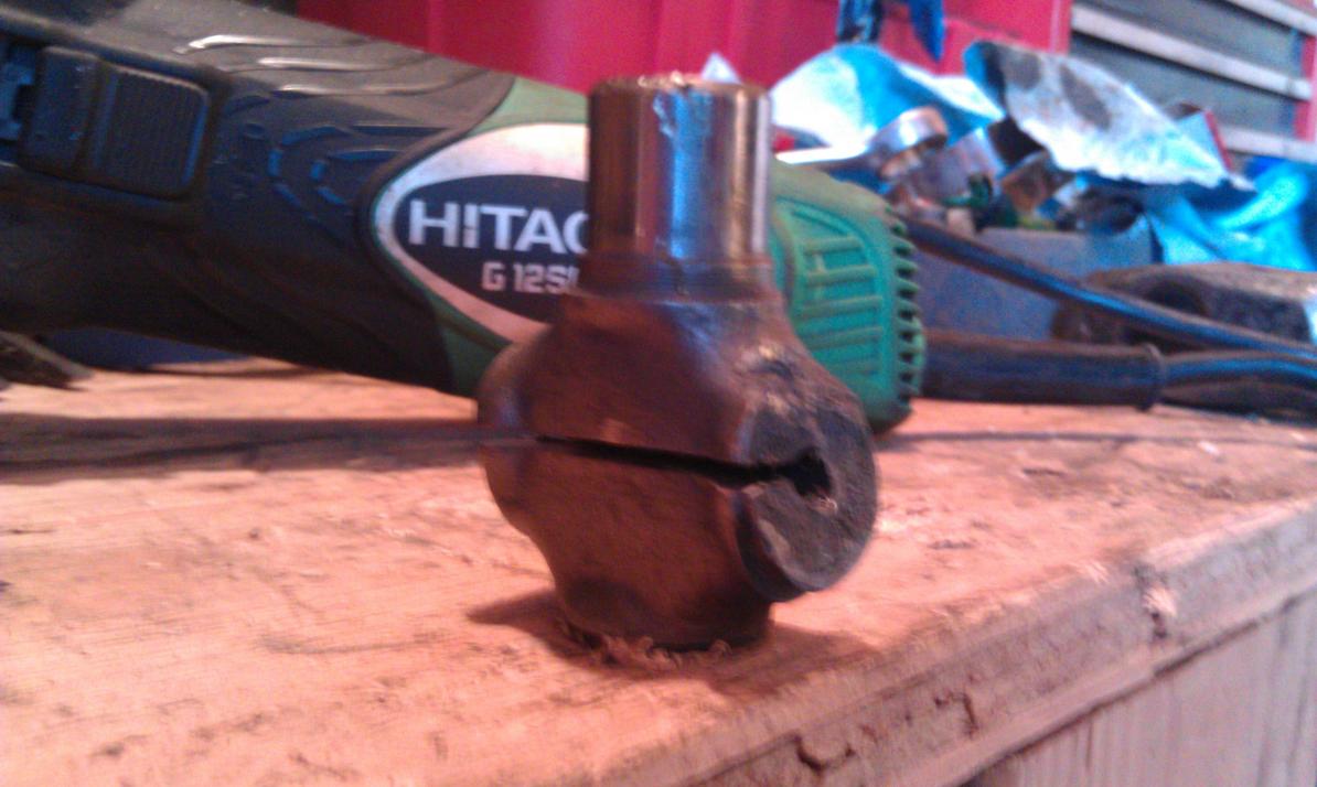

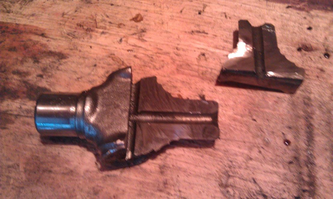

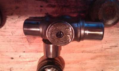

I know the greasable one is from Oriely and was brand new when it broke. i'm not sure if i still have the none greasable one but if i do it is a stock unit that came with my truck.
If it was the cheap O'Reillys then its a MasterPro. If it was the expensive one its a Precision. But there is only about $4-$6 difference in the good one and the cheap one.
78shortandwide
Aug 9, 2011
448
20
Denver
Tom
This is A Master Pro U-Joint from O'reilly Auto Parts. part # 371. It is a non Greasable chrome-nickel alloy. $8.99 Each.
It broke on the first trip out. Wont be buying these again.

Awesome cutout views and good info. Not good at all. Although it appears to be of some decent quality, obviously made of some inferior metal. Made in China maybe???
Sadly, I just bought one of those MasterPros at O'reilly's cuz they were out of the Precision. Its the one in the rear driveshaft to the rear end yoke. They did have the Precision for the front shaft to the front axle yoke and I got that one. So I can expect the MasterPro to take a :poop: in short order. I think I'll just change it out sooner than later when I get cash, and also change the one on the rear driveshaft to the slip yoke into the Tcase and I'll use both Precision from RockAuto.

This one was in the drivers side front axle shaft. It broke when i jumped up a hill in reverse. When i put the lift on i had both the drive lines rebuilt and a drive line shop. They got spicers in them and i have had no issues with them yet.
