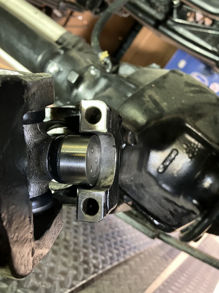

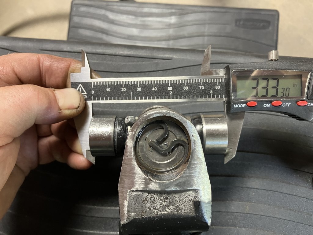

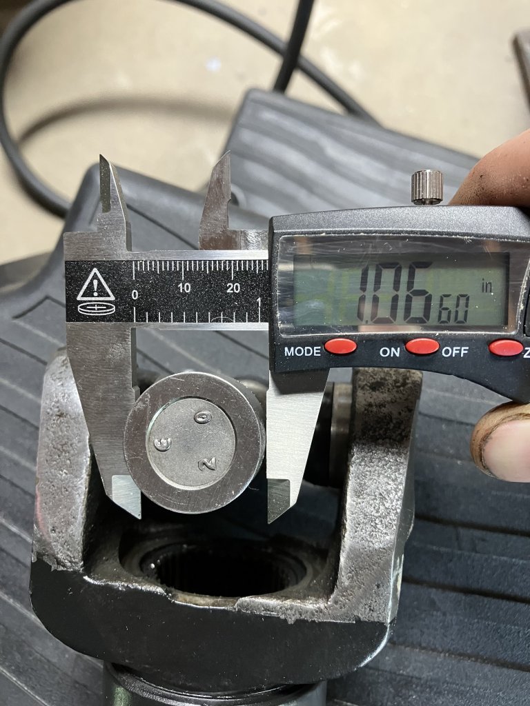

I had a shop install the u-joints into the front and rear driveshafts for my ‘83 K5. When I attempted to install and tighten the front driveshaft u-joint clamps, the bearing is too small and slides out of the clamps and the length (end cap to end cap) of the u-joint is too short. The
u-joint bearing cap OD measures 1.06” on all 4 bearing caps and fits in the driveshaft yoke side with the retaining clips but is too small for the clamps to tighten down. Are there two different sizes on this u-joint? I found one of the old bearing caps and it measured 1.120ish”. Does anyone know the part number for this front driveshaft u-joint, the dimensions of it and where I can buy it? See pics. Thanks, all!

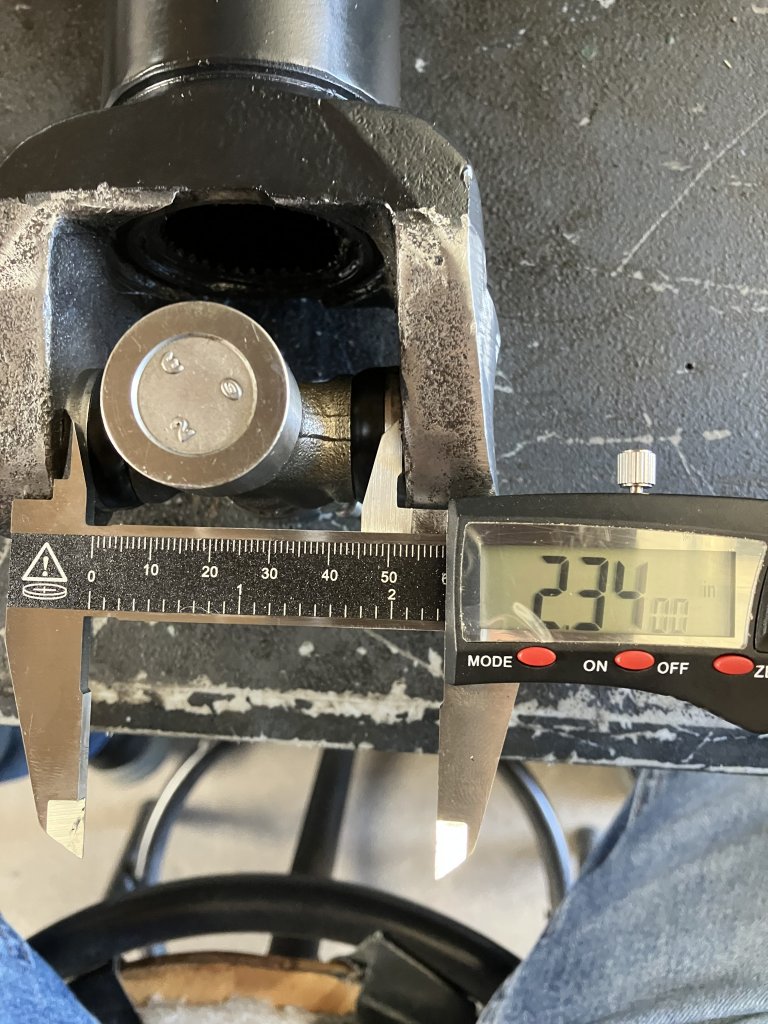

Inside ear to inside ear 2.340. See pic. Assuming that’s the measurement your asking about.

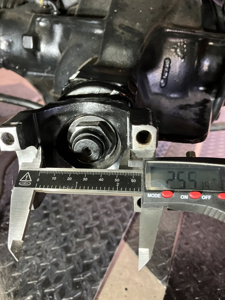

That measurement, but on the pinion yoke (differential). That is the measurement that internal clip joints use, like a 3R the old Detroit style u joints, etc.
A 3R joint is 1.125 diameter caps and 2.5625 ear to ear.
BlazerBill
Mar 24, 2023
171
158
Billy
Chevy K5 Blazer

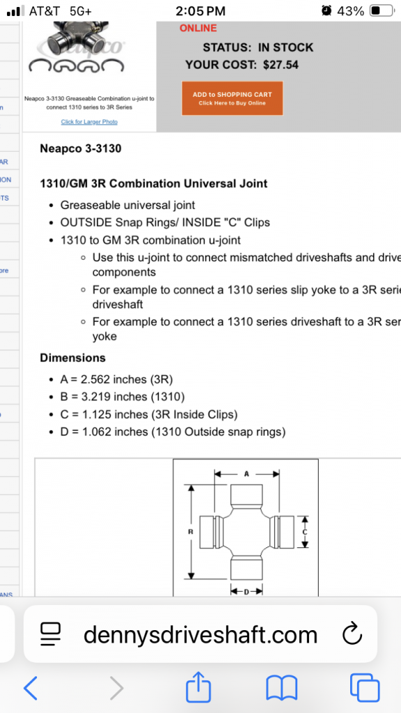

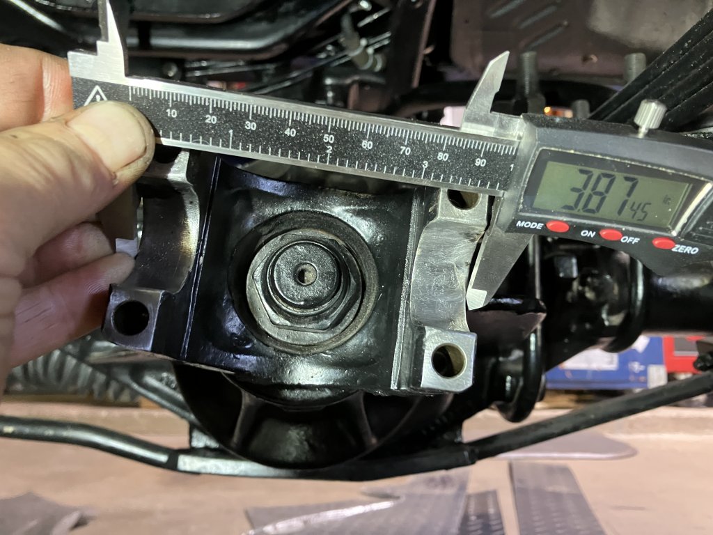

Pinion yoke ID. 2.56” confirmed and 1.125” Clamp ID confirmed. Is the 1310 to GM 3R u-joint correct from Denny’s Driveshaft website? See pics

That Neapco joint should work fine.
The 3R is what that size is referred to as, like a 1310, 1410, 7290 don’t know why.
