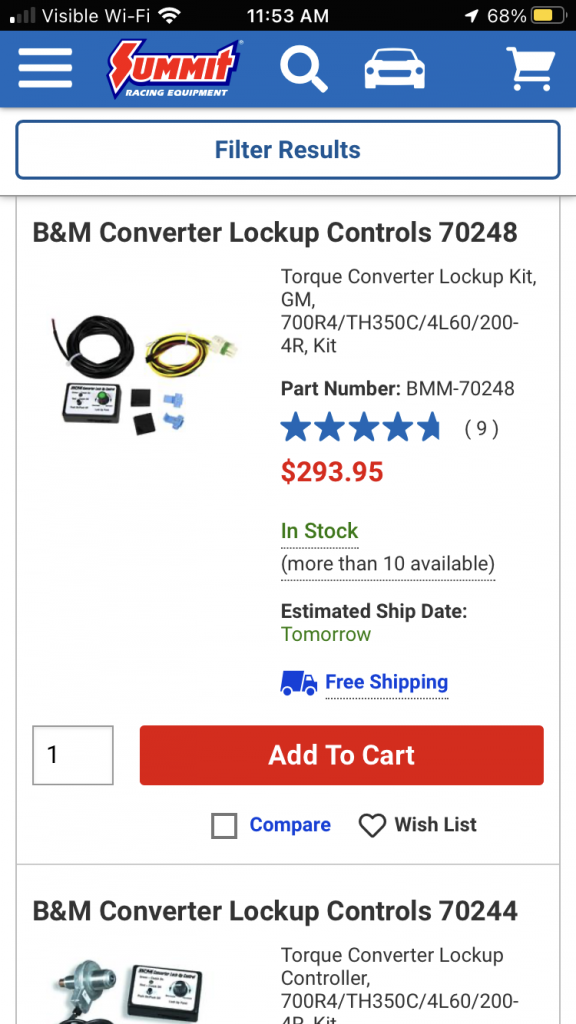

One of these would work
I had mine installed by trans shop when they rebuilt it
