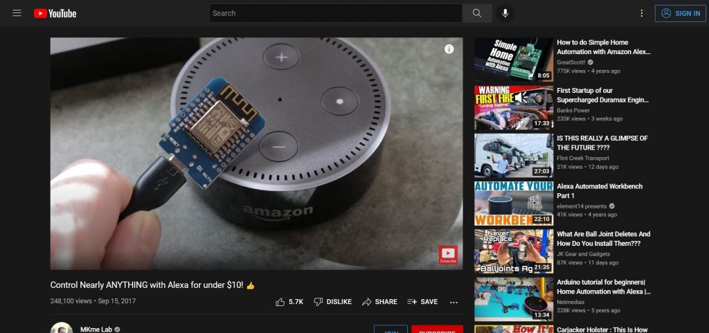

I was going to be a SmartA** and say "Alexa and a solenoid." Then you could just speak "Alexa, engage torque convertor." Then I google searched it and I'll be damned if it hasn't already been done...on almost any controlled device! Google it and you will see. LOL
Already been done huh. I never would have though. Well that bitch isn't allowed in my truck anyway lol.
Just my luck, I say "Alexa engage torque converter clutch" and she'd respond with something like "I'm glad you think so highly of me but I'm not available for marriage". Mean while my converter stays unlocked. Heck if you have an Alexa device I dare you to ask her to engage you and see what she has to say. Maybe she'd just say I'm here or something like that....
